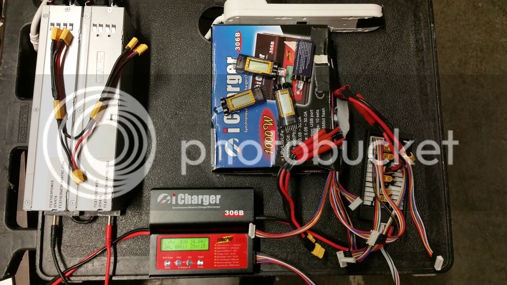

I'm still on the search, however I figured I'd post my short term solution! My iCharger 306B box fits 4 6s 5000mAh batteries almost perfectly once I took the separating foam out. The actual box keeps the 4 batteries snug and has a thin layer of foam for protection. The top of the box doesn't close perfectly or anything. Nothing some gaff tape couldn't fix.
