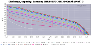

because i can't sleep...assumign the pack from this post Ride1Up 700 Series: An upgrade journey then with a 4p pack, 30A / 4 = 7.5A per cell. The chart from the lygte page shows that at 7.5A each cell is going to sag around a third of a volt when full, and around half a volt shortly after that until it gets toward empty. Wouldn't be much less at 25A (6.25A per cell).

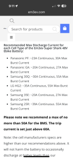

I’m setting my battery max to 25A. This is sufficient for my area. 30A was also nice, but as voltage gets lower, this 30A might start to tax the cells and I don’t want that.
On my old KT system, I had a 25A controller and that worked well for me. I want my battery to last.
Also, I saw a list, at em3ev, with my cells on there. Seems like good numbers to go by.
