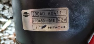

Hi,
I got following motor that I'm considering using for an electric moto conversion,
My problem is that I don't know what kind of controller would run this motor and control the speed. Its from a nissan E-4WD System out of a Nissan March I think.
WhatsApp Image 2020-09-05 at 17.08.00.jpegWhatsApp Image 2020-09-05 at 17.08.40.jpeg
I did get the motor running on direct connection to a battery. It seems to have tons of torque even compared to a goldcart motor.
Connection as in last image:
A - Neg to Battery,
B - Pos to Battery,
C - Pos to Aux(low volt) Battery,
D - Neg to Aux(low volt) Battery,
E & F - joined together (No Idea on function)
When connecting only A and B i blow a 100am fuse( on first try it welded my cables) so i need to connect C and D first.
When A B C & D are connected it spins drawing about 18amps (38 amps peak) at 48v. when i then remove C or D while running, it starts spinning much faster. (unfortunately no RPM meter to check the difference) but no blowing of fuse.
Does someone have an idea what kind of DC motor this is? Any help greatly appreciated.
This is a separately excited DC motor- your rotor connections are A/B and your field connections are C/D. There are controllers out there that can take advantage of SepEx motors, or you could just connect C/D to a battery and use A/B like a traditional brushed DC motor.
E/F could be a bunch of things- temperature sensor, tachometer, position sensor, electromagnetic clutch... seems like whatever it is, it doesn't care about polarity since the two wires going off into the motor are the same color.
Some basic principles here- A/B is what makes your motor spin. C/D changes motor behavior.
More voltage (and thus more current) through coil C/D means the motor will spin slower with more torque.
Less voltage (and thus less current) through coil C/D means the motor will spin faster with less torque.
If you're familiar with brushless motors, more current through coil C/D means KV decreases and KT increases. Less current through C/D means the opposite.
