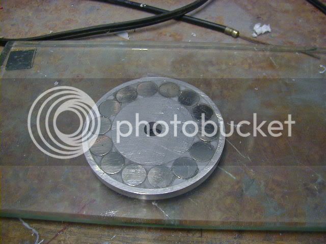

rotor construction-
.5"dia x .25"t Neo-magnets n42 (or n48-i forget)12lbs pull force each. Aluminum hub & outer retainer ring
here it is with epoxy resin & fillers for securing the magnets
I Use my printer for a lot of layout work on most of my projects these days. print a 100% scale picture & rubber cement it to some plate & chop away.

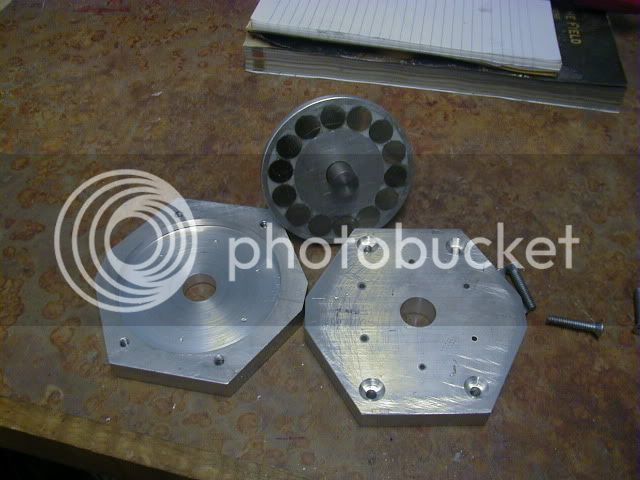

Here is the rotor with the shaft pressed into it & the motor cases roughed out.

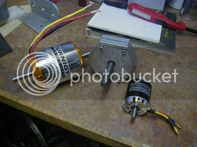

& here it is along side some other motors for scale.

I agree firmly with all of this you stated above. I see some issues with plan A though :( It's ok, because we have lots of alphabet left, and you've got myself and other more smarty-pants guys to help us arive at the goal on one of those letters. :)
First, if you ask magnets to spin next to a conductor, you just made an eddy current brake/dyno. The magnets can be mounted on a disk made of a conductor, because it has no change in distance from the magnets to the conductor as it spins. They can't be asked to spin next to a big aluminum sheet though, or you are asking them to become a big inductive heater.
Second thing, with only coils on one side of the rotor, the magnetic field will not be captured at all. If I'm looking at things correctly, the flux will simply deform away from the rotor magnet. Am I not seeing it right?

Yes, sadly, the current design with aluminum side plates is in fact an eddy current brake. Here is a tutorial:
http://farside.ph.utexas.edu/teaching/316/lectures/node89.html The sideplates will need to be nonconductive. Plexi/Acrylic is machineable with a wood router... well sort of.
Study the "right hand rule" it is the basis for all the eddy current problems in the world! :p

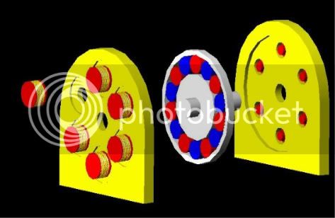

Here's my take on it.. The purple is magnets, the white iron and the orange is copper..
The measurements are one inch cube magnets and the entire motor is a little over ten inches in diameter and three and a half thick. The torque arm length is about three and a quarter inches from the axis to the center of the magnets.

What Jonathan drew is exactly what I was saying about using horseshoe shaped iron, and then running your coil around it. I tried to communicate that in an earlier thread, but I seem to suck as verbally describing things to everyone except Jonathan, whom I apparently share a communication wavelength with (I likewise find your words/descriptions to always seem exceptionally clear in my mind for some reason).
The challenges it poses are of course that the stator encapsulates the rotor disk, so that building one means the stator must be multi-piece, or assembled and wired up around the stator. Not a big obstacle for custom one-off stuff.
