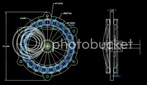

Here is something to look at:
34 pole/21teeth
flux rings on the magents
powered iron cores.
could add stators & rotors,
A yoke to support the main sahft ends dosent seem insurmountable. Size is becoming an issue now.
Anyone care to donate flat copper foil for a build?
a rotor assembly built on a cast hub, laser cut iron flux ring,turned to inset magnets & bond them.
open center section will provide opportunity for active airflow cooling.
Input please............
Gotta have provisions for the other ring to piggyback over the outside of it.
That design also leaves very little area for coil size.
Think big pie slices for magnets, or better yet, think radial stacks of 4 magnets each making an HB array. Then some bolt tabs on the outside so the second rotor can clam shell onto the back of the rotor disk to encapsulate it inside, but leave the center of the other disk open for stator mounting and connections.

Thud- that upper picture I totally missed for some reason. Damn phone, lol. The structure design looks good. The spokes in this design would be causing a lot of drag for minimal air movement though. Either shaping them like turbine blades, or running a flat disk would cut on drag a lot, and some very clever passive tricks could be used to generate huge airflow over the coils, which will ultimately be the only thing to limit how much power we can continously pump into this monster.
I see where you are going now, with piggy back rotors.
(I am still a couple posts behind-Cad is slowwing me down) that thought is turbine style blades (just tough to draw quickly :) but simple ducting could also be added in an investment cast proccess. dont get hung up by any of my renderings.
