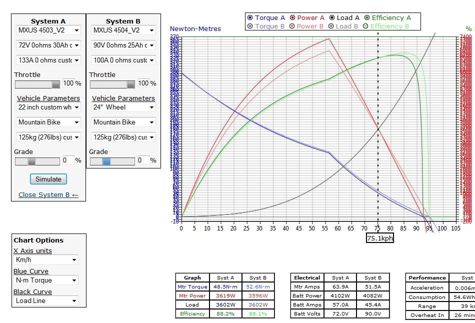

I've had a few stealth owners ask if they can make a simple swap / upgrade to a MXUS v2.
In my mind there would be two challenges:
1)The temp sensor being configured to the Stealth cycle analyst:
- Should be easily done if Stealth dont lock this out somehow:
http://endless-sphere.com/forums/viewtopic.php?f=6&t=66305&start=50#p1013306
http://endless-sphere.com/forums/viewtopic.php?f=31&t=66472#p999176
2) The clyte controller being compatible with a MXUS 3000. I'm thinking it's pretty likely.
I guess it couldnt be done on newer stealths that lack cycle analysts.
Anyone have views on the above?
