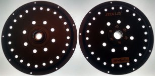

have not been here in awhile wanted to say mu MXUS V3 is working great and can climb just about any road I throw at it although it will get hot on extreme climbing and I still have to get off and push on steep loose soil.....but it can do things my 4065 could never do like climb a steep hill from dead stop
as a comparison,my old setup was 110 volt topping out at 120 and running 25 battery amps lyen control phasor 93 pounds individual cell pack the 4065 had upgraded phase wires
my MSUX is 86 nominal topping out at 96 running 35 battery amps adappto control 105 pounds thereabouts foil packs battery
SO THEY ARE PRETTY CLOSE...but the MXUS V3 is better in all aspects at a cheaper price...also my V2 was pretty much an electric heater even on flat ground
