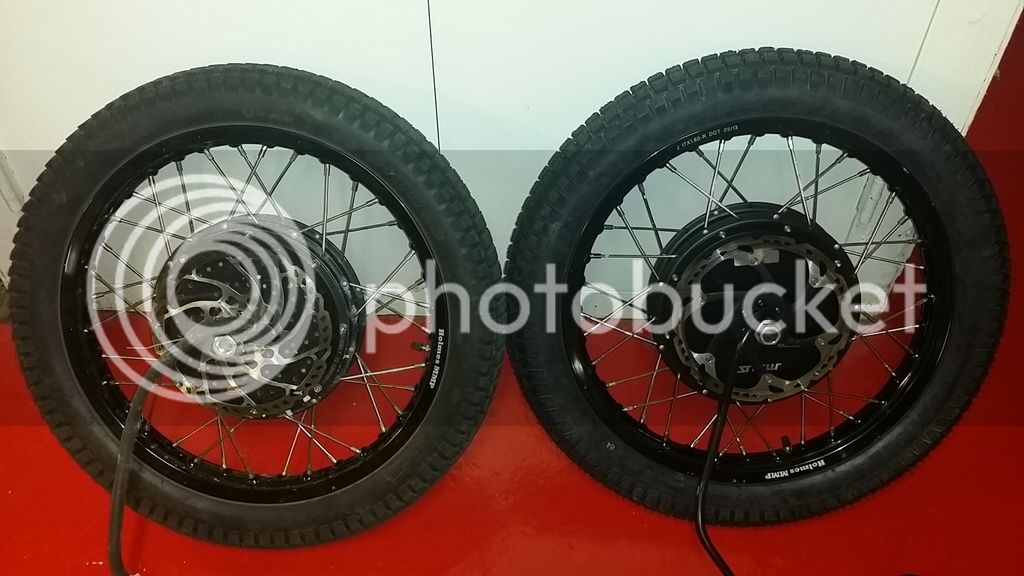

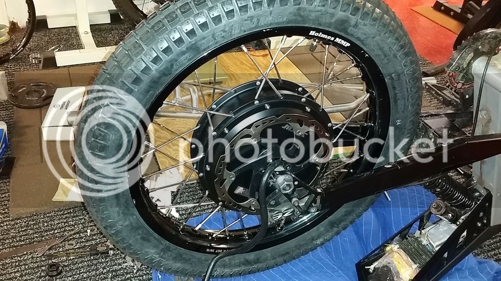

I'm almost done getting my MXUS 3000 Turbo motor hooked up. Then I will be able to make a direct comparison between a Cromotor v3 and the MXUS 3000 turbo. Everything else the same including, bike, controller, and 17"x3.00 wheel.
I only saved about 5 lbs by switching over. I thought it would have been more. The MXUS 3000 turbo weighs more than the older MXUS motors because it has a beefed up axle and larger phase wires.
The Cromotor v3 is not as powerful as the QS205 with extra copper fill, it is also not as heavy. The QS205 weighs about 1 kg (2 lbs) more than the cromotor v3.
If the MXUS 3000 Turbo can get close to performance as my Cromotor v3, then I would say it is probably the motor to use as my Cromotor has plenty of power.
I'm going to be testing it using the same exact adaptto settings, except autodetect of course.
Only thing that sucks is it is so cold and wet out which doesn't make driving off-road easy.
