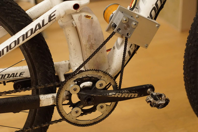

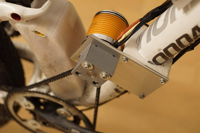

I made some improvements for my motor bracket. The plastic was not dissipating heat and i was constantly overheating. Now im using 6mm aluminium with some 3d printed mold on the frame. Cooling has been improved significantly.
I tried 3 sprocket: 9t,10t and11t.
9t is really rough. I don't really like it.
10t is smoother with less torque. A good compromise.
11t is again smoother but not smooth enough, torque is pretty low.
I feel that #25 drive-train cannot be absolutely smooth like a bicycle chain. The 11t was ticking .. maybe a 13t-15t would be satisfactory.
I am feeding the motor with 40A, any more and the motor cogs and skips at full throttle, not a nice feeling. With 14-15v from the battery and 25-27A it can reach ~370W. I cannot really achieve more than this, the 9:1 reduction is limiting the power.

That's a serious 2kw of power but was it first stage or second stage reduction ?
If it was second stage that's really good, my only concern is that it's really rough. When the motor develops torque i feel the whole crank is vibrating like hell. What was the size of the small sprocket which you used?
Hi it on the 2 stage . My sockets are bigers 56/ 46t
Cyclone motor
It help load teeth better.
I feel it could take 60amp. 75amp before breaking in half
I test it soon.
My chians are cheap. $7
25h# can take it...this my shoping ebike
Good luck

My gearing is 46t - 28t, I cannot go lower then this. I have the same problem as you, bad knees, and I'm struggling on hills. It would be preferable not to pedal at all and that's what I'm aiming for.
I really feel that there is more power in that motor but rpm is not enough. Dumping a lot of amps is not very efficient and a lot of that is wasted as heat. I would preferably set a limit of 20-25A at a higher voltage and make a smoother drive train with a larger drive sprocket.
My battery is 4s6p 250wh and it does sag under load. I saw max battery consumption around 28A(voltage drop around 2v) with 50A motor current but at this level the motor is cogging (skipping) sometimes at hard acceleration. 40A motor current limit is a safe bet with no cogging. Do you experience the same?

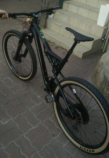

I have the new bike, its Cannondale Habit Carbon 2 SE. Currently has 13kg but i will put it on a weight loss diet until it reaches 12kg. Maximum weight without batteries should not exceed 15kg because i have to put it on a roof rack and i'm not the strongest.
We have 3kg to play with for the motor, bracket, transmission, pedal freewheel and controller. Battery will be removable and im thinking of using 10s2p configuration with 21700 5000mAh cells capable of delivering 15A.
Steepest gradient which it should climb is 25% at low speed around 3-4mph. I have 63 kg so i'm fairly light and won't need a ton of power to climb a steep mountain. My other bike with Shimano E8000 mid drive can climb anything with a little effort and it has a 3 stage gear reduction around 25:1 - 20:1.
