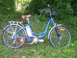

My RMARTIN bike died today.
you really should fix the rmartin so it doesn't become junk. almost everyone has to replace hall sensors at one time or another, it is not as hard as that guy implied. in fact i suspect your hall sensors are mounted on a pcb on the end of the motor, like on the cyclone motor, so it should be easy.
I'll probably purchase the iGO this fall or spring. It's lighter--about 17 lbs and higher torque. If I do, will test the old motor on the new bike, really curious if it is the hall sensors?? I'm still thinking it could have been a loose connection within the frame. Either way will sell off the parts but easier to sell a motor if it's still functional. I believe strongly in recycling so plan on selling the parts cheap (almost give away) and donating the frame, wheels and fenders to the local bike coop.

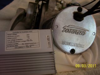

What's the brand name on the motor? One of your pics shows it on the back of the shinny case, but I can't make it out.

Nehmo, I believe all the motors come from one company in China. Feel free to call Sat AM, I'll try and find the exact name or post a pic.

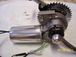

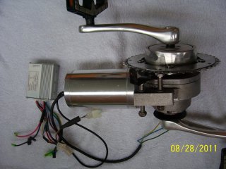

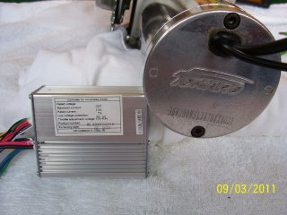

Here is a closer look of the motor/ controller. I received an interesting PM last evening; "buddies bike is an R10 not R12 but it uses the same crank assembly. He got it used and has only owned it a yr but its been good minus a couple little things like the chain popping off when changing gears which got a bit better by changing out the chain and freewheel. He also had an intermittent power loss problem which i tracked down to a wire going from the power/light switch (which i believe is the same as yours) to a plug stashed inside the frame; it took a bit to track down but got it resolved.".
As I mentioned in my earlier thread, not sure what the issue was, I already stripped down the bike so not trying to trouble shoot any issues now. I tried like heck to weave out the wires from the tube but ended up breaking some of the connectors. Finally gave up in frustration; not worth stroking out. So, not sure if it was a loose connection or hall wires.

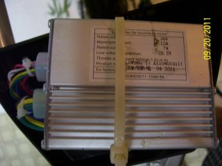

If I do rebuild, the controller is rated at 15 amps, motor 200 watts, could it handle a 48 volt battery????

I wonder if you could just use a sensorless controller on that motor?
Then you will not have to open the motor and change out the halls. I have a sensorless controller or two - wish we lived closer. Anyone live near george with a sensorless controller to try out?

Great idea but already disassembled the bike. Plan on buying a new iGO bike; lighter and stronger torque. If I did choose to repair the old bike, how do I hook up a sensorless controller and what amps/ volts? Thanks.

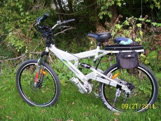

Well, I couldn't go without an EBIKE so broke down and purchased a new RMartin 10. I was planning on buying my next bike from iGO bikes in Quebec but the Rmartins are 200-300 dollars cheaper and offer free shipping. The bike came today. Ride is smoother thanks to the full suspension and better torque thanks to a 250 watt motor. Unfortunately I got a flat tire only a few miles from home so ride was cut short. Tomorrow I'll pick up another tube. Tonight I switched the handle bars with longer-swept back style. I prefer to sit up right rather than hunched forward.
Equipment and effort involved in fixing a flat tire is minimal; hopefully this episode becomes your prompt for preparing for future flats, such that they don't have to end your ride.

I actually purchased the same bike from iGo two months ago or so and had the same thing occur. After taking the tire and tube out the problem became pretty evident. The manufacturer of the rims did not make clean holes for the spokes/nipples, there are some pretty sharp metal edges/points. I suspect that both of us hit a bump or something hard enough that caused the tube to catch slightly on the sharp metal and create a small hole.
I temporarily put duct tape over the holes to solve the problem as I am in the process of replacing the wheels. I would suggest you do something similar or it will probably reoccur. I've also replaced the brakes with hydraulic ones. The difference was quite astounding.

Is your iGO bike 250 watts? Mine is listed as 250 watts but the motor can is silver??? On the Tonao website, the 250 watt can motors are black not silver. My bike's motor shows 250 watts but it doesn't make sense why all the Ebike sites show the 250 watt motors black not silver?
My first impression of the bike: Ride is much smoother thanks to the full suspenion. Torque slightly better but not much. I'm tempted to purchase a Ping 48 Volt 10 amp battery this spring, yeah may shorten the life of the motor but not a big issue for me. Does any know if this motor with a 36 volt 15 amph controller can handle a 48 volt battery??

Is the can silver or black? Mine is silver but stamped 250 watts. Do you think it was tolerate a 48 volt battery???

Yes, will probably repair my old bike this winter, always good to have a working spare. Do you think the bikes can handle a 48 volt battery?? Thanks.
48V is most probly ok, if you can open the controller and look on the input to see what size, voltage that is, of caps on the input and maybe might have to add a resistor to the input to get the voltage to the regulator down, but it should go faster that the 36V. show us a picture of the inside of the controller and we can look at it too.

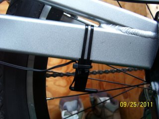

Those bikes are usually speed limited ( under power) to 32kmh/20 mph.
You can over ride this by removing the magnet, usually on rear wheel. However I'm not sure how the motor gearing will handle the faster speed.

Thanks for the advice. I'm not looking for higher speeds just more torque. I live in Northern Vermont; climbing hills is an everyday reality. The bike does come with a speed limit cable but not necessary thanks to my 210 lb body and the bikes 37-volt battery. I have never hit more than 18 MPH without peddling. As I said, I am not looking for more speed just torque. 20 mph is plenty fast for me. The controller is rated at 37 volts 15 amps; will it handle a 48-volt battery?

He also needs more torque for hill climbing, the answer is to increase the amps somehow,( I don't know how to do this) . Not increase the voltage.
The controller on these bikes is rated at 7 amps, 15amps max.
