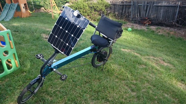

As one who has done some experimentation with solar on my recumbent, I would suggest putting at least one of the panels in front to break the wind. I found doing this on my BikeE reduced the cruising (~40-50kph) power consumption by about 100W average. I believe it's because it creates a nice laminar air flow around my body.
I recently went from a 15W panel to a larger 30W panel up front and have been finding the aerodynamics are now even better. If it didn't start to obstruct my vision or pedalling I would go even bigger.

C D , looking at the picture of your bike-E it looks like you can use a bigger panel on the front , by making a bracket that extends the lower part of the panel out further and at more of an angle .
Also to be able to see above the panel just buy a wind deflector that some motorcycles use on their windscreens .
https://www.ebay.com/p/Universal-Clear-Wind-Deflector-Windshield-Windscreen-High-Spoiler-for-Motorcycle/602181059?iid=192364036766&chn=ps

Thanks for the suggestion...maybe jump over to my thread for further discussion, but I have considered these exact mods as well. Good suggestion. For now I'm sticking with 30W size as it makes it more practicable and manoeuvrable. I need to get a 3D printer first before I can play around with brackets etc to be able to go to the larger 50W panels. I'm also thinking of putting a couple of panels on the back in a 'tadpole' shape as this will also improve the aero significantly.
