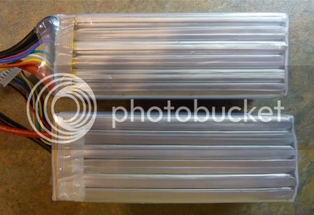

That's why I remove all the opaque blue shrink wrap on my packs and replace it with a few layers of transparent wrap. This allows me to see any puffing and sometimes leaking cells.
I like that approach El_Steak. Visual inspection is simple and probably quite effective. What did you use as the clear wrap?

The clear wrap does look nice.
