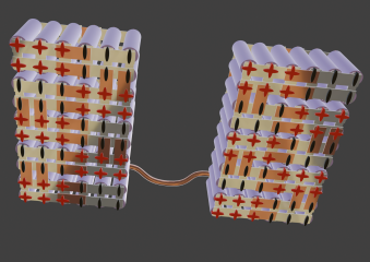

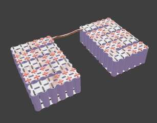

Hi everyone, I am considering building a 72v 24ah battery (20s6p), and I am curious if a segmented/separated battery would be possible.
Reason is for a unique build where space is limited, and I wanted to try and separate the battery in half while still using the same BMS.
I made a rough 3D model of the battery.
Is there any reason why this wouldn't work? My biggest concern would be the wire used to bridge the two packs together. It would be at least 10AWG and very well connected to both packs.
Please also let me know if my series/parallel connections seem OK, or if I have to re-design them. Silver is parallel connections, copper is series.
I am considering using two separate 72v 12ah packs with their own BMS systems, but I am hoping to connect them together like this to reduce voltage sag. If anyone has any experience with running dual batteries to reduce voltage sag, let me know.
Thanks!

Sure. It's been done a few times in different ways. At least one Yuba Mundo build here has a split battery, half in each of the side rails under the panniers; you can lookup the YM threads and find the details. A few other people have done split batteries for various reasons.
You might want to protect those balance wires physically, and keep them from potential electrical noise interference (using a shielded cable from the side that feeds the long wires to the BMS thats inside the other pack...or if it's separate from both, then both sets of balance wires should be shielded. It's possible this is unnecessary, but you don't want accidental shutdowns from any noise generated in the motor phase wires or any other sources that longer sense wires might pick up and tell the BMS that something is wrong in a cell when it's not.
So using a regular bundled shielded cable with a tougher outer jacket rather than the typical ribbon would be a good idea.

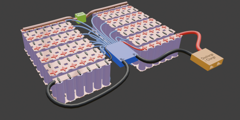

Cleaned up the design, other design had some sus connections. I also wired up the BMS wrong 💀 Replaced with a common-port BMS

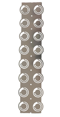

The cell block and interconnect arrangment is much better the new way; you can get lower interconnection resistance like this.
BTW, you can buy rolls or lengths of "plate' interconnect in various widths, includiing ones wiht "fused" cell connects if you want those (they also make them without that--just flat sheets, some with indents to reach down below cell holder lips, etc). Probably some nickel-plated copper ones out there too if you have a welder that can do those and need the current capability.
Batteryhookup carries some; they're avaialble lots of places you just have to make sure you're getting the real metal you're after (rather than nickel plated steel or whatever, like you find in the really cheap stuff). These greatly simplify the pack welding / construction.
