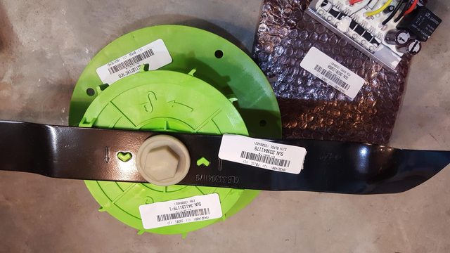

I ordered:
motor - $45
PCB Board - $12.50
Motor base - $5
Fan - $5
Switch box - $10
21" Blade - $15
Bolt to hold the blade on - $3
shipping was $12
Total was $107.50. Four of those items were on backorder. We'll see how long it takes to get in.
My plan is to bolt it all onto an old push mower deck and use some old LiPo batteries for power.
We'll see if there are any "gotchas" with their power system, or if I can just put 80V to the controller and go. If worse comes to worse, it looks like I could probably use my old Infineon controller from my first ebike.
I'm pretty excited! We'll see how long things are on backorder. This may be a winter project.

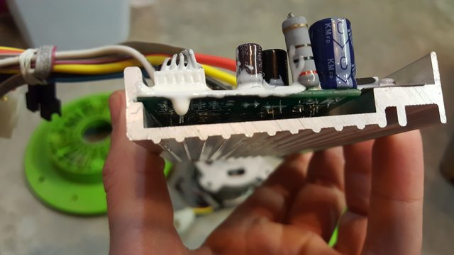

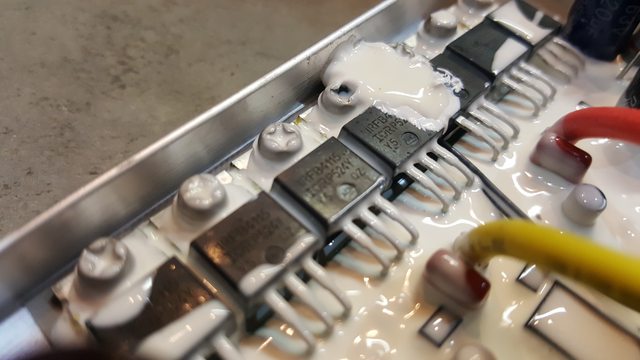

Yes, I took mine apart tonight. Had to remove the 4 bolts holding the motor assembly to the deck.
Yellow wire is COM. I have a feeling I'll need to get a battery to parallel with mine. Tomorrow I can try and see if it starts with just battery positive and neg connected.
Metallover - I may do the same as you if this works out and I like the performance. Make a 40" walk behind. It looks like you ordered all the necessary parts.
I'm a bit disappointed that the fan doesn't hold the blade perfectly level. The fan is the fail point if you hit something hard. Should preserve the motor shaft. Decent design.

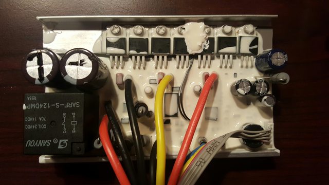

I just figured out how to fool the mower controller without draining the stock battery.
Connect your 20s battery to pos(left) and neg(right) when looking into battery compartment of mower. Connect communication tab of stock battery to middle tab in mower. Connect neg of stock battery to negative of your 20s battery.
This is almost like paralleling the batteries but not, since you don't connect pos battery leads. You could if both were the same exact voltage, but not necessary.
I don't plan on using the 2ah stock battery for mowing, just trimming and blowing.
This is not as simple, but a hell of a lot better than using a different, inefficiently applied controller.

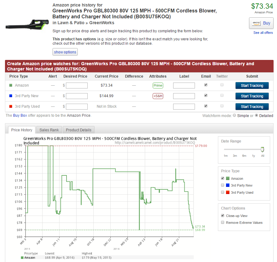

Also, have you guys heard of camelcamelcamel.com? It is an amazon price tracking site. If you make an account, you can set up price alerts for anything.
Here is what they have on the 80v blower w/o battery
link - http://camelcamelcamel.com/GreenWorks-Pro-GBL80300-80V-125/product/B00SU75KOQ?context=browse
Yeh I set up alerts on camel after you posted about it here. I would like to find a dirt cheap battery that is bad and make a custom pack out of it. Since this 80v system is so new, not much available. I have alerts set on eBay too. I bought the attachment capable trimmer on eBay from CPO outlets. I'm a little disappointed the trimmer is so much heavier than my 36v black n Decker and the transmission head gets warm fast. Still have yet to really use it more than a few minutes. It does seem to have good power. The b&d can't be beat for light trimming around obstacles quickly, it's just so lightweight.

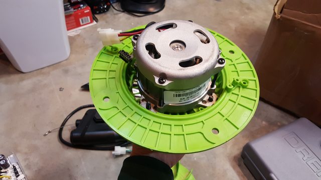

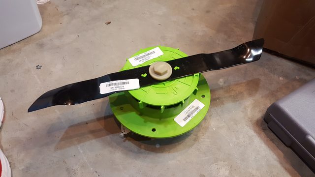

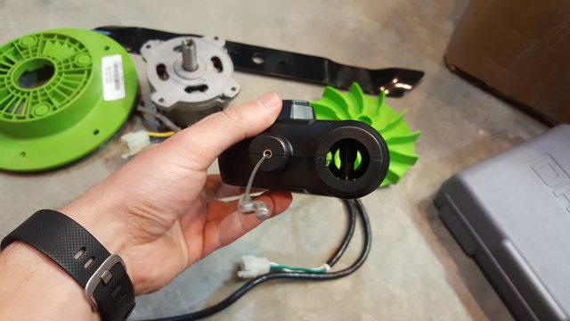

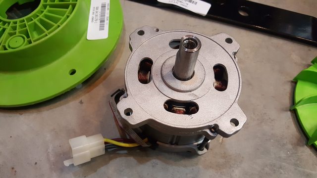

Yeah I got my motor and parts the other day. The motor looks really good for a mid-drive setup and is only 5lbs. The only question is which hall wires are which? Will have to open up the motor to find out, and I'm a little hesitant to that right now.
You should be able to use the flow-chart for 3-phase combos while using a controller at low power?
What's the shaft diameter and flat length? The internal threads on the shaft is a nice feature.
I wonder if that shaft means that "standard" briggs-straton motor accessories would fit on it.
Really that looks ideal for a kids gokart too.

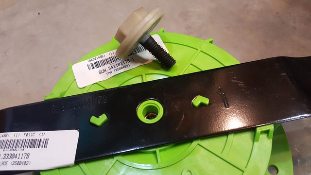

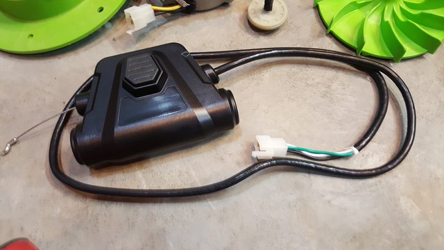

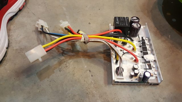

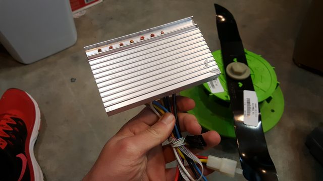

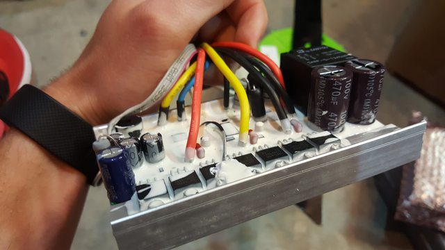

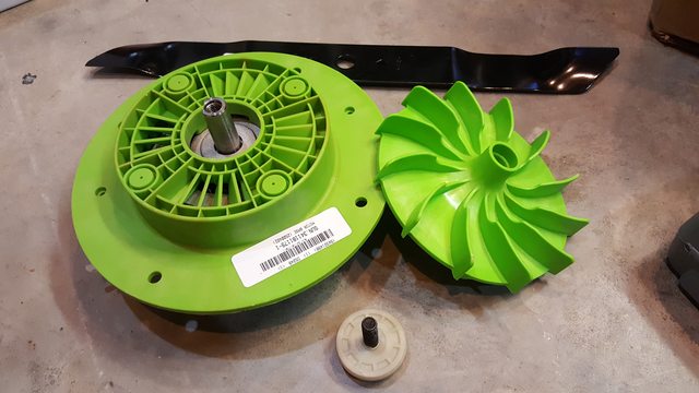

I have pictures of all my parts. Installing this on a gas mower deck 'should' be a piece of cake. The holes from the gas engine might even line up with the electric motor mount. The only thing I'm missing is the connector between the ESC and the battery. I'll need to figure out how to mount the switch too. I ended up ordering one of the 80V trimmers with the 2Ah battery.
The ESC has 4 plugs: 5 wires to the halls, 3 motor phases, 3 wires to the handlebar switch, and 3 wires to the battery. It looks like the controller uses 6 IRFB4115 FETs. There is a thermal pad between the FETs and the heatsink. There's a big relay mounted on the pcb, near where the battery connections come in. It has a temperature sensor in the middle of the FETs. The front of the board is potted in, but the back of the board is bare. I didn't take the board off the heat sink.
The 'fan' part is [probably] necessary to mount the Greenworks blade. The fan and the blade have what I assume to be proprietary grooves in them.
