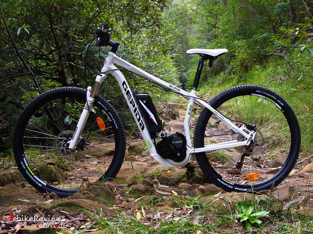

Interesting choice of frames. I changed bikes to not have the motor in that position. Certainly workable and I had other issues that eventually made me abandon my Trek Pure build, but I am happier with the motor being above the low point of the chainwheel. It just seems vulnerable to me. I have a lot of concrete curbs to deal with and that's to unprotected. I'd sooner bang a chainwheel than the motor. We'll see how tough the motor casings are soon enough.
Copied this post from the faults and fixes thread hoping someone will see it here and have a thought or comment.
What does it mean if you have conductivity between 2 of the 3 phase wires on the motor? I have no conductivity from and phase wire to the motor side wall but I do from the yellow to blue wire. Does this mean they are shorted together?
Bob
This is a Bosch motor but the mounting is much better, picking up the points you are raising.
For those interested the review of this bike can be found at Ebikereviews.com.au
Andrew
