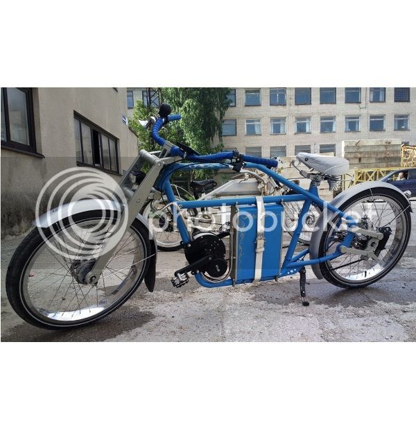

I've already showed here pictures of Liberator Chilly:
In this week we should finish next Liberator, called Insane:
Both bikes have Bafang 350W 36V BBS motor and 20 Ah LiFePo4 battery. About biggest differences you can read and see more pictures in our blog post:
http://liberatorbike.blogspot.com/2014/10/allow-us-to-introduce-liberator-insane.html
0utrider
20Amp! Should be able to go to the moon and back!
Yes, with couple of charging, it should :)
Actually we haven’t tested range of this combo yet. If weather allows, then it would be interesting to find that out within this year. As Liberator is heavier than normal bike – Chilly is more than 30 kg, maybe even close to 40, then it spends more energy too.
We tested range of this Liberator Little Blue in summer:
This bike has 750W 48V BBS motor and 30 Ah LiFePo4 battery. With one charge we managed to ride ca 145 km:
We didn’t do ecodriving, instead, average speed was 25 km/h and some sections even 40 km/h. Approximately 20 km was purely on electric power, with speed of 25-35 km/h. With ecodriving there is possibility to achieve 180-200 km range.
Off-topic, as this bike doesn’t have BBS, Liberator Jäägermeister will have even bigger battery – more than 40 Ah (don’t remember exact amount). When it’s finished we’ll see, what range it will have.
