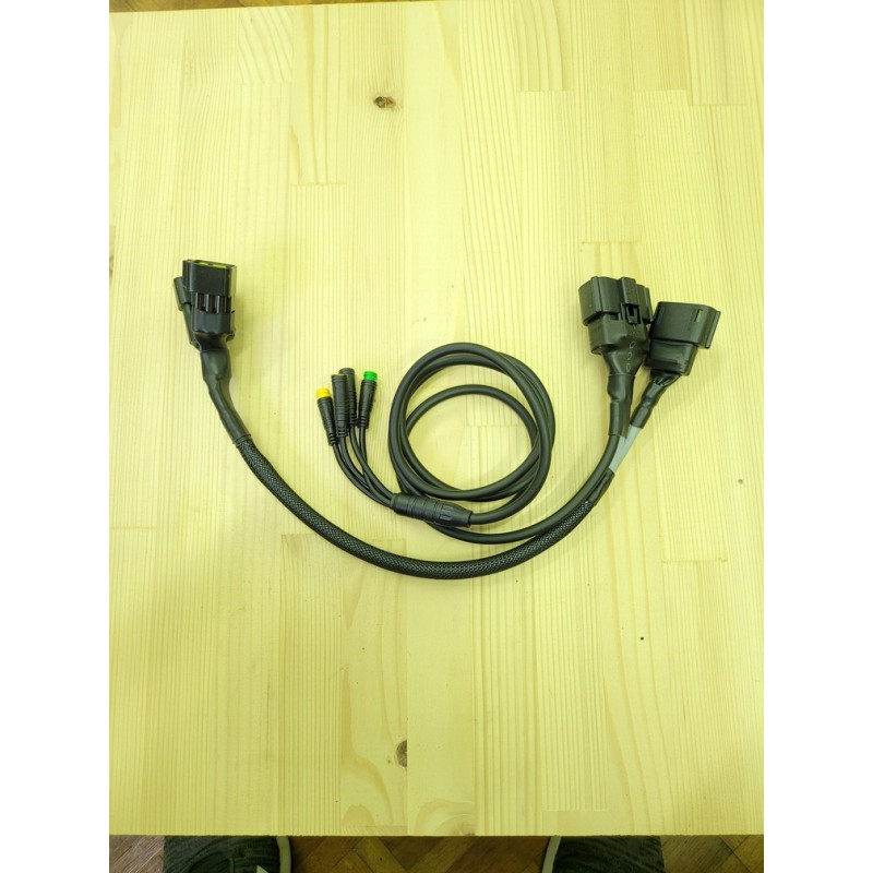

Wiring harness (6p + 16P):
With 16P i can connect throttle (3 pin) , brake (x2), ignition and Display (5PIN) and a Red wire to B+ on controller with fuse.
https://store.bull-bikes.si/en/home/38-sur-ron-wiring-harness-basic.html
Well, if all parts connected to that harness were supplied with it, then they should work with it if it's wired right. If the throttle wasn't supplied with it I'd recommend verifying the wiring is correct for your throttle. (might be a good idea anyway, to verify all the wiring, in case something was miswired by whatever place actually made the harness).

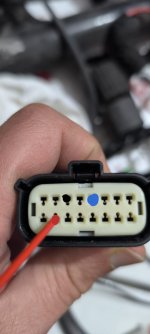

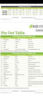

I contacted the seller because now I think the wiring he provided me was wired badly. looking at the controller pinout I find myself in this situation now (I think the wiring is wrong and I hope the controller is not damaged too 😞):
P.s. the numbers of the PINs writed near connectors are of the controller.
hi, the problem of my asi bac8000 is on the 5v line (pin 4 and 8), short with gnd. so i will have to have it repaired. what could be broken inside? do you know what is the electronic part or component that manages +5v?
