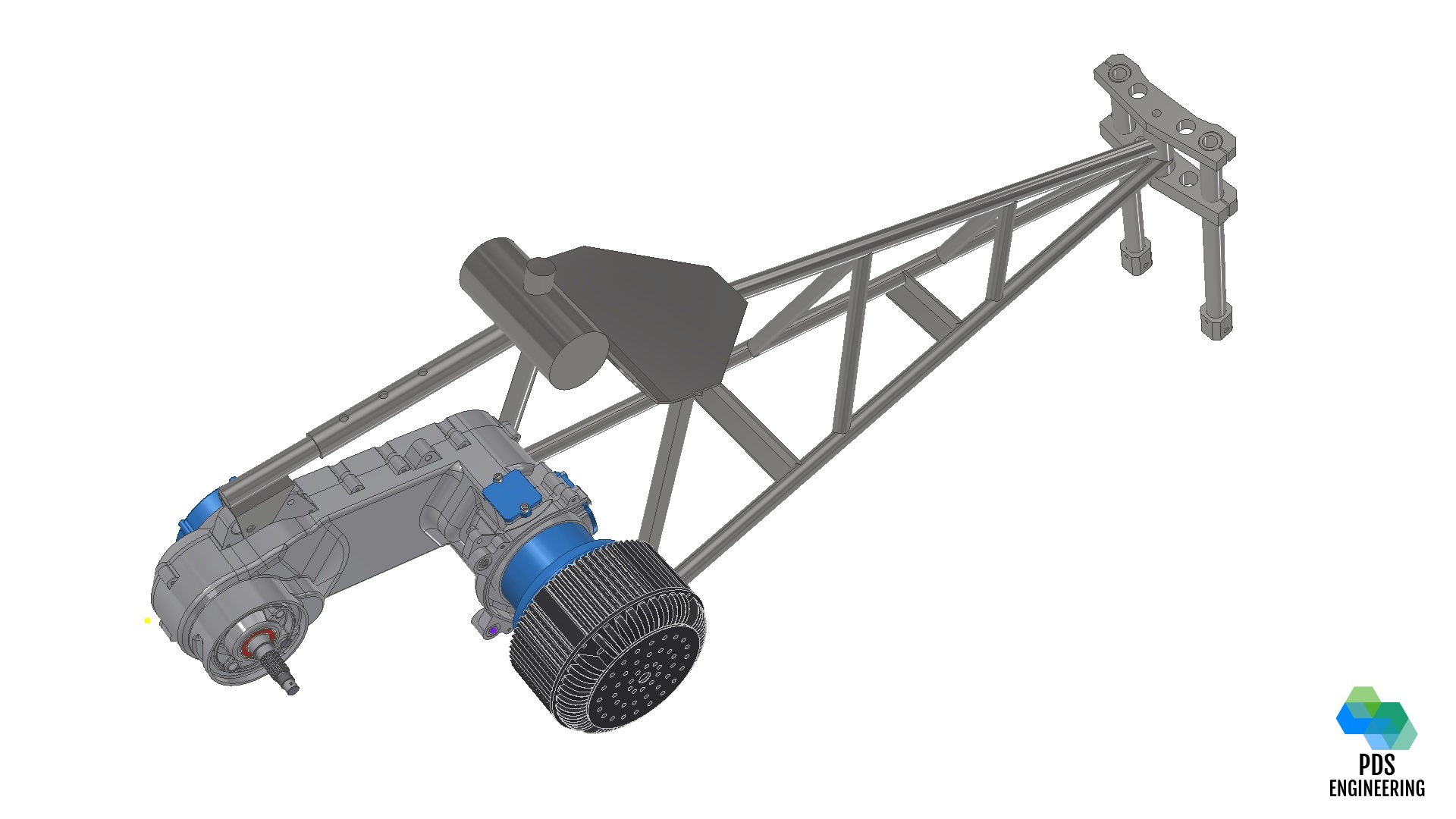

Hi to all!
Today i introduce my project in this space.
I started to think about a complete plug&play conversion for mopeds when i started reading about many limitations and constraints for old motorbikes and in a special way for 2 stroke bikes.
I think that 2 stroke motorbikes and mopeds are such a big fun to drive and they are easy to buy and maintain, since they have a huge diffusion all over the world.
As you know, these two wheelers don't have a large life ahead, due to environment restrictions.
I think that, at least here in Italy, 2 strokes will be banned in a matter of years.
So i thought about this plug&play conversion for Piaggio mopeds that allows everyone to swap the electric engine in place of the original (or not :twisted: ) 2 stroke engine.
No workaround, no mods, only plug the kit and ride electric!

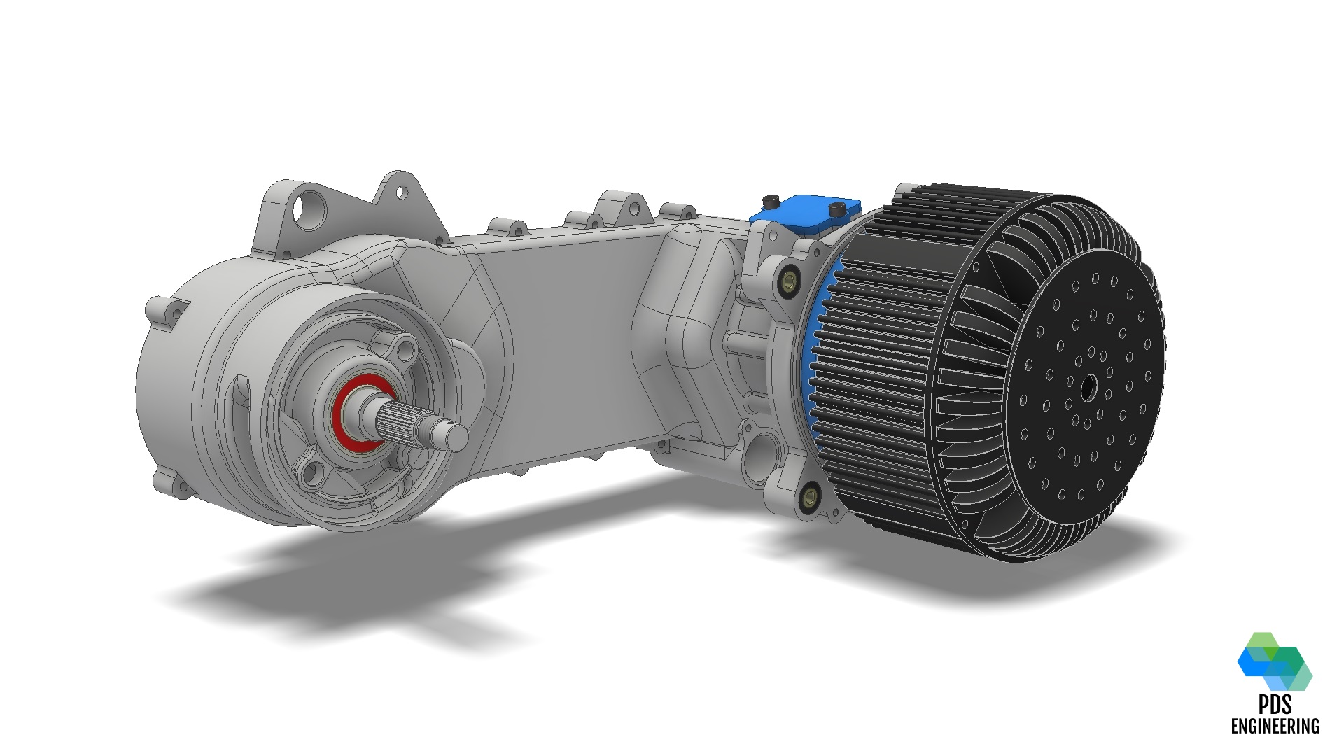

I'm still in design phase and i'm working around the motor flange and the shaft that will connect the motor to the CVT transmission.
By now i've chosen the following parts as the centerpiece of this project:
-5 kw HPM5000B fan-cooled BLDC electric engine (OEM Piaggio engines' power is something north 2 kw)
-VEC300 motor controller
-Battery pack
-Wiring
-various ancillaries
Here some screenshots of the project:
I'm here to read about suggestions, criticisms, and hints.
Thanks for the time you'll dedicate in this thread, i'll be grateful.

it looks very well designed. What CAD software do you use ?
I guess the target Moped would be the "Piaggio SI" or "Ciao" - If so they have very skynny frame thus you could straggle to find the room to hide the battery pack.
Is the motor 48V ? To reach 5Kw you will need more than 100A on a 13s pack

Looks really good. Is there a way to adjust the belt tension inside the case?
Thank you so much!
So, there is no way to adjust the belt tension in the case. Major adjustments in this transmission come from variator roller and springs and from clutch springs.
Hope to see more.
Ciao, thank you for your appreciation! :D
I use Autodesk Inventor 2021 as CAD software. In past months i used also Solid Edge and CATIA but this SW is the best compromise between performance and ease of use IMHO.
About the "moped" target i made a mistake. I always have the doubt that anyone outside of Italy could think about micromobility when I say scooter, so i use (wrongly to be fair) the "moped" term.
The original target is all the Piaggio scooters like ZIP, ZIP SP, NRG, NTT, Gilera Typhoon, etc.
So, the motor is 48v and about batteries I've seen something on the web but i didn't go further about this matter yet.
I'll have to do my calculation and see what the market offers :D

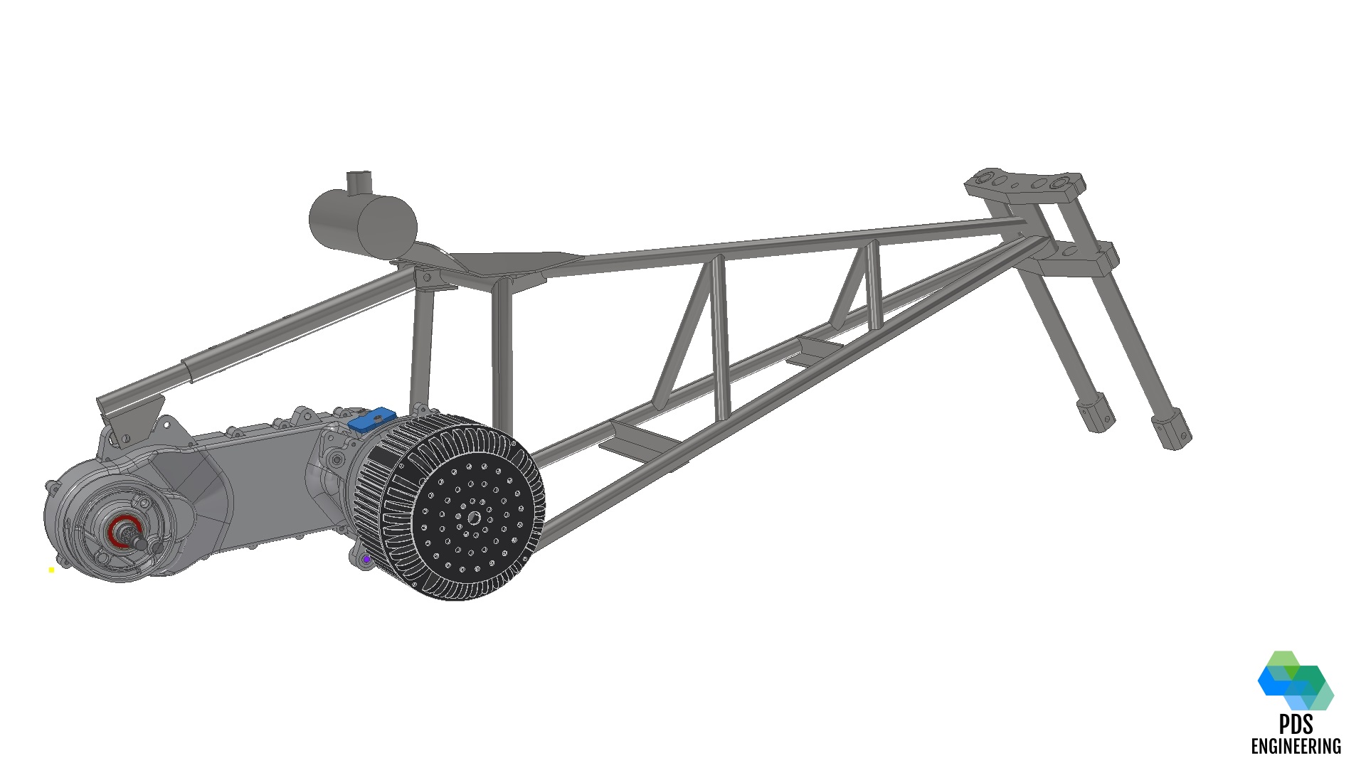

I modified at a certain point the engine mount due to the use of an elastic claw joint compliant with the torque and speed of the motor.
The mount is not so tiny anymore, but there is no more issue about mounting and dismounting the motor, because there's more room for hands and screwdrivers.
I made a trial using a Kiesler Racing frame purposely designed for Piaggio engines and the result is better than expected.
Next step is the shaft design.
I have a design in mind, now it needs to be optimized, using original bearing inner diameter as constraint.
That's it for now. Hope to come back with new updates :D
Enjoy the screenshots of the progress:
