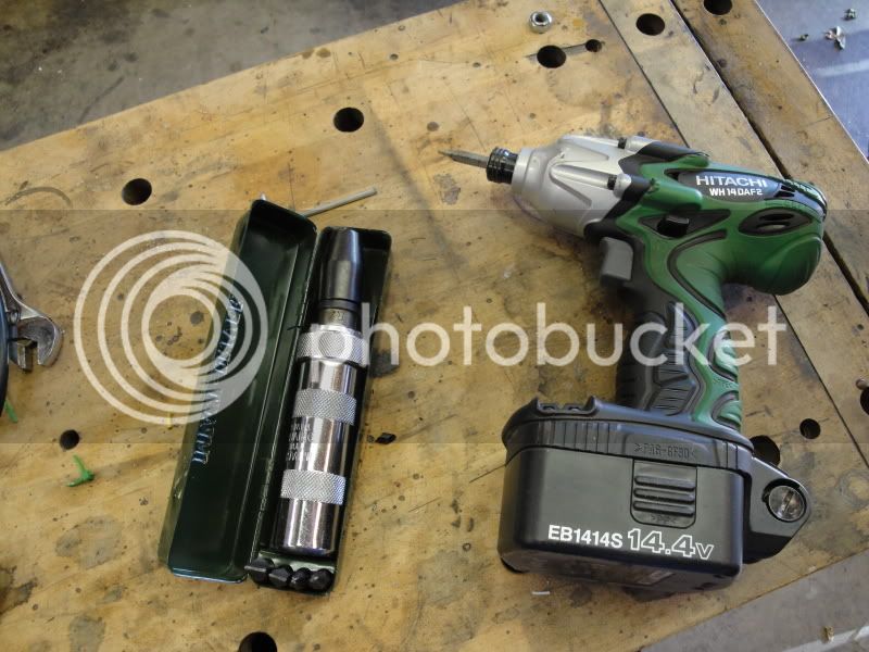

You need to use a impact drive to get these out. You will find it hard just using a screw driver. Mine came out no problem. Make sure you replace them with stainless m4 hex bolts.
Would anybody recommend putting the hall sensor wires on the other side of the axle? So one side would be for the phase power wires and the other for the hall sensors. It would just mean pressing out the axle and machining a grove into the axle like on the phase power side. That way we would have more space and thus reduce the risk of cutting the wires while riding.
If you have the right tools the screws are not too hard to remove. Having an electric impact driver helps, but what really does the trick is to bash the screws with a manual impact driver hard a few times then use the cordless driver. The one I have I bought from Harbor freight years ago. It was cheap. I don't use very often, but every once in a while it's indispensable.
