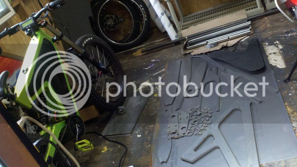

Parts are back from the waterjet machine, kind of a before and after shot:
That bike looks so darn good in this pic! 8) How long does it take to weld all the pieces together?

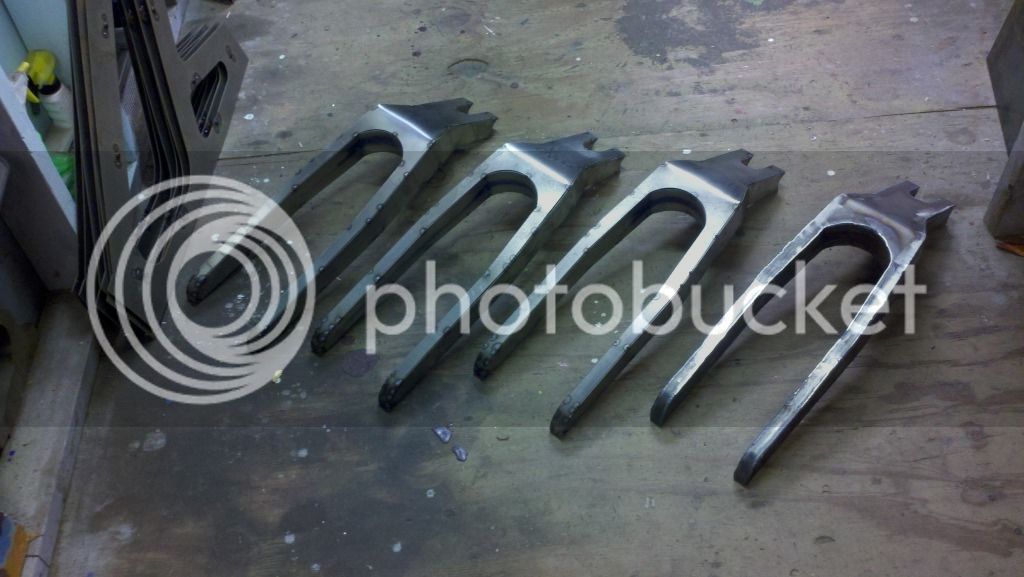

Finally have enough parts to get started building. Here is a time lapse of the first steps of building a swingarm. Handbuillt in the USA. From here they go into the jig to get the dropouts, bearing carriers and shock tabs welded on before it is complete.
Thanks to all who went through with a preorder and hung in there during the startup delays. One of these swingarms might be yours. Getting the CNC parts back early this week and should be able to start getting frames out very soon, and I will get a better idea of how long each one will take to make.

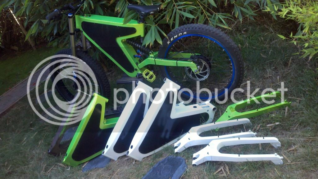

Frame#01 almost ready
I machined a few more parts, some brass inserts that will prevent weld from penetrating where you don't want it to, and save from having to do any grinding.

Green machine- the swingarm alone takes several hours to build, there are several stages that each take an hour or two. Tack weld together / form it, then come back and fully weld the edges, grind smooth, then put in the jig to add on the bearing carriers, shock tabs and dropouts. It is all pretty labor intensive but I am trying to find ways to outsource some of it to local shops.

Finally coming along... First 3 about ready to ship off. Quite a bit of work to get to this point! But I do enjoy fabricating.

Thanks for the update David and hope you didn't hurt yourself. Coming along nice. Ohzee yours must be the unpainted one at the end, number 4 painted all over it.
Can't wait to see my candy blue frame in the next update.
