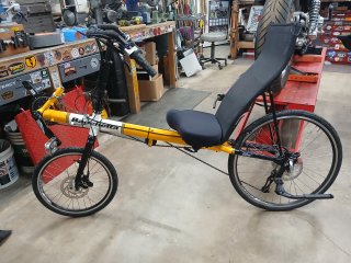

I was hopping to get some recommendations for electrifying my Bacchetta Giro.
I am 65 and mainly ride the local streets of our town, I have a Rans Stratus with a front wheel kit from E-bike kits in PA. but would be open to a mid drive on this also??
Depends on what you want. Want minimal assist power but have some massive hills to climb? Mid drive shines. Most other cases I'd choose hub.
What kind of power levels and speeds are you hoping to get?
Just want it for occasional help with intersections and large hills, my main goal is exercise, getting in shape enough to maybe ride 20 miles or more without it.
If that's the case, and you are not the type of person who enjoys high amounts of speed, a small geared motor on the rear wheel is probably a great choice.
I had really good experience with a little G310 on the back of my Giro 26. I didn't need to climb steep hills but did want more speed, so I actually used the version intended for 20 inch wheels. It worked well, as would the standard winding, I suspect.
