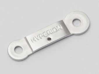

I obtained a sample of some common welding strips for testing. The part that goes between parallel banks is 7mm in width, thickness is .15mm. I wanted to determine the current capability of this small section of strip (about 20mm).
I connected the strip in series with a 60V supply and a load that draws 10A. There was a question in my mind regarding the proper test voltage, either the differential voltage between cells (4V) or full pack voltage, so I opted for the worst case just to make sure. The supply has it's own volt and current meter, and I put an additional meter right at the strip for verification. Please refer to the pics.
The result was that the strip remained stone cold, no heat at all, none.
I measured 0.018 V across the strip. So the resistance is:
.018V/10A = 0.0018 ohms. According to my math (somebody please check it), the power dissapation is .018V * 10A = 0.18W.
Granted that is not nothing, but seems negligible. Strange, huh? What's going on? All the related posts in this forum says that strip is only good for 5-7 amps! I held the strip in my fingers for several minutes, no heat at all. I'm not getting any correlation, not even close.
Did I do something wrong? What am I missing? Is it just my alternate reality? Can some technician or engineer verify my results please?
