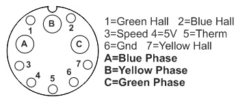

If checked the motor plug coming out from the controller that would hopefully tell me if no voltage its the controller that is a brick, but which holes do i test for voltage as i do not want a shock or fry something??. Thanks
Phase yellow to blue is 38.8 ohms
Phase green to blue is 38.8 ohms
Phase yellow to green is 38.8 ohms
Hall yellow is 3.33v
Hall green is 3.33v
Hall blue is 3.33v
Grey what ever that is 0v
Red 5v is 5v
White speed is 3.2v
These are my results from testing the L1019 plug from the controller to the hub.
I think but not sure if its the the hub that is bricked. Whats your comments please guys
