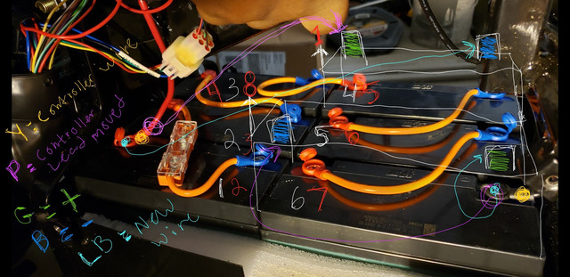

I think by making this diagram for you I know what I may have done wrong. The 8th battery instead of adding it to the series like I did in the picture I attempted to add in series as then 7th battery instead which I made three wires for instead of only having to create only two new wires like in the picture. Im pretty sure it was done properlly as the voltage was right on the speedometer. Any input as to what could be wrong assuming I did it right would be appreciated.

Sorry the website flipped the image the whole image is the bottom of the bike. The drawn white bo es represent the placement of the new batteries. The power inverter has to be upgraded in order to use a more powerful charger to charge the additional batteries otherwise the new batteries need to be charged seperately. When I say proper voltage the Speedometer showed 100v, 101v at first but dropped down to 100 after some time passed after adding the batteries. Im going to retry later today or tomorrow based on the drawing thays hopefully easier to understand now lol :roll: . But assuming I did it right the first time could the controller or throttle not allow higher voltage? Something else? Btw the people that make the Sabvoton controller Im sure has made an appearance here are thr same ones that make the controller in this bike.

Edit: Forgot to mention the red numbers represent the order of the batteries after adding in the two new batteries. The battery furthest away becoming the first in thenseries and the battery closest becoming the last in the series.
Your red numbers are wrong. But the point is I can't see the whole thing so there's too much guessing. I'm assuming if you get it wired as I was saying it will work, but I can't see to say I'm sure.
Are they wrong? I thought the positive lead on one end of the series is the begining and the negative lead on the other side of the series is the end. The white box (battery) furthest away being added to what one end would become "1" and the box closest taking the place of the battery with the negative lead on the last battery would then be "8".

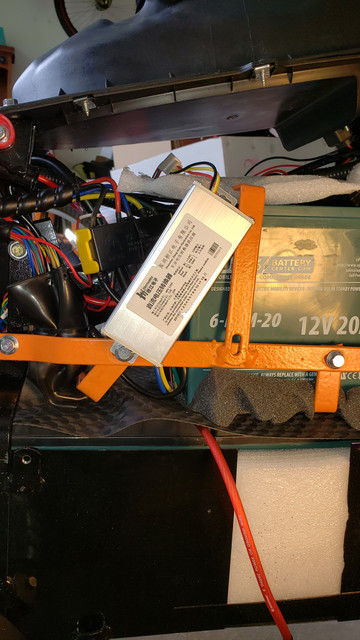

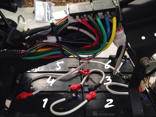

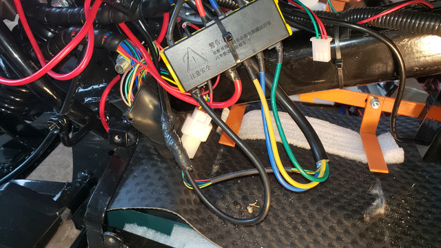

The first picture is from a forum where I learned what to do for the most part with some of the cables moved by the owner to be zipped tied out of the way. My batteries (previous post) where in a different order and my wires where already out of the way on my newer model. Mine also came with bars the other guys didnt have which seems to have been added for the purpose of adding two additional batteries (second picture).
Link to an identical controller that does not have the spiral housing like mine does.
https://m.alibaba.com/product/60613347076/Yuyang-King-YKZ7280JA-V1-1200-1500w.html

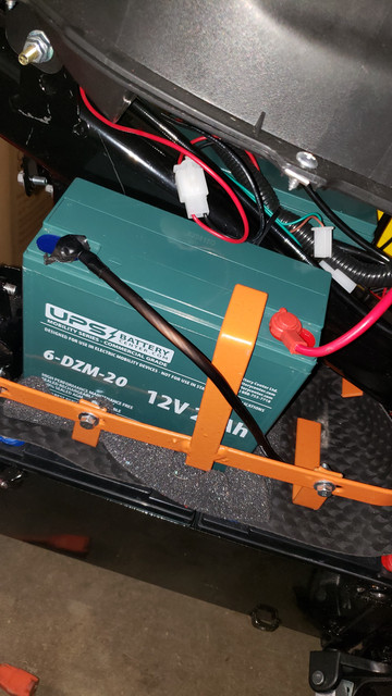

Well I know without a doubt this time the batteries are 100% in series but I get no throttle response, lights, brakes, speedometer comes on the only strange thing is the speedometer shows 6-8mph when the bike is not in motion. Out of curisity I flip the breaker while holding the throttle and for a splot second the throttle works before the power drains. Im assuming either the throttle cant handle the extra voltage or maybe there is some sort of overvolt protection if that is a thing.
Since ive been messing with it its gone from 101v down to 99v.
Your numbers are wrong because they have been written in a way that can be interpreted several ways, the most likely way would definitely be incorrect but I'm not sure that any interpretation would meet reality.
The 6 original cells should not change number, that's just practical. The 2 new should be 7-8. They should be wired together and added at one end of the chain. The other end should remain untouched. Again, just practical.

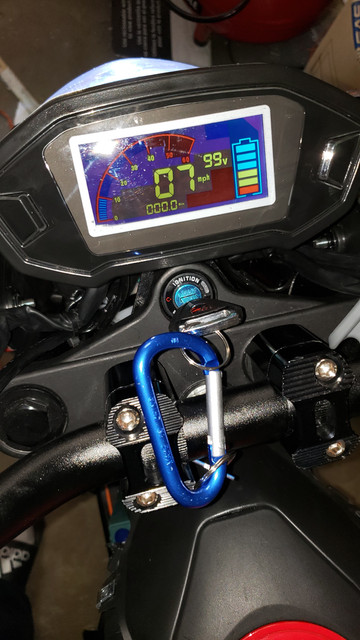

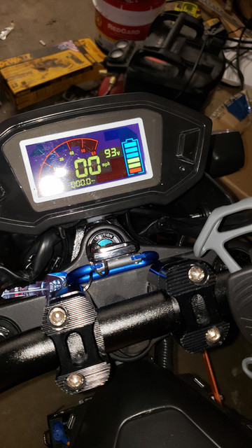

I read that the voltage could determine the state of charge and the voltage on these batteries is roughly 12.74v. Does that change what you suggested trying to charge individually? Also earlier today I attempted running just one additional battery which would be the one added to the end of the chain as you suggested and still no throttle. Do throttles have to be upgraded or is that not a factor? I can say for certain that my grom has a different controller than ones you may have seen as on adventurerider forums where I read on this 2 difderent groms from the same manufacture spread over a few years had different controllers. Also there are other differences like the oramge bars you see, a mat, foam, and even a 40amp fuse on one of the wires in the series.
So I went to Walmart and bought an individual battery charger. The voltage before charging was 12.7 and after a few hours I took the battery off the charger and after resting a minute or so the voltage was 13.9 (14.3 fresh off the charger). The first image is the battery in series with no throttle, second image is go show where the negative was and where the new wire was connected to verify it was in series. I bought a new controller which will be here next week and Ill get a different throttle if you confirm that can have an effect. At this point I can only imagine its the throttle or the controller.
image hosting
image hosting
Voltage on speedometer with the one battery added and the original batteries charged up.
image hosting
I suggest double checking the display voltage with a real voltmeter just to verify.
I don't have experience with that exact model, but there frequently is a over voltage protect feature that can prevent it from running. From the battery positive, there is typically a fat red wire going to the controller. There is also a skinny wire that goes to the key on/off switch. The old trick is to keep the fat wire on the full voltage, but put the skinny wire one battery down so it sees a lower voltage. This fools the controller and allows operation above it's limit. Downside is a slight uneven discharge on the pack and inaccurate voltage reading. You can usually tell your state of charge from the reading you get.

Thats good information thank you. At this point I believe Ive confirmed that newer models of this bike have the new generation of YuyangKing controllers which now include ovee volt protection by default. I have bought a new YuyangKing controller with higher voltage input 40-144v and the manual says it has overvolt protection. Once I recieve the new controller I will try again and if it works Ill know it was the controller and hopefully others who get the bike can benefit from this thread.

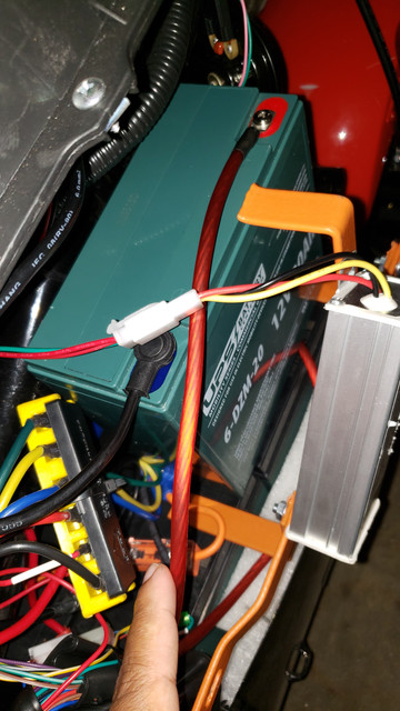

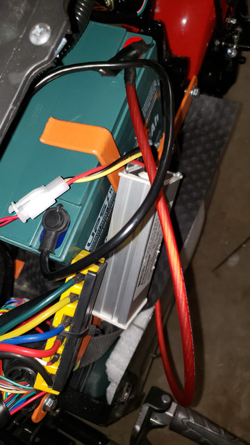

There is a 40amp fuse on one of the wires in the series as seen in my ealier posts. Im no electrician (obviously) but my new controller has a 50a minimum should I remove the 40a fuse?
While one would assume you'll wind up with a bigger fuse, I'm curious to see what happens if you leave that fuse there with the bigger controller. It's not like you have another use for it after you burn it out.
I was thinking of removing the fuse as it is not present on the older models and just seems to be an extra layer of protection that isnt really necessary. If anything I would install a larger one but I dont know what type of fuse it is I just figured from experience thats what it is.
So without a doubt it is the controller for anyone who wonders here with the same problem. Also the 3 speed is actually 2 speed and speed 1 and 3 were reversed. So anyone who comes here who needs a little more info here is a copy of my post on a different forum:
Good news! After several days of diagnostics and looking for help I have found out for myself what the issue was. It is without a doubt the controller, it now includes overvolt protection on the newer models so simply adding a battery or so is not enough. You MUST upgrade the controller (recommend aliexpress app get the same company YuyangKing for easy swap) and the DC to DC converter (can be found on amazon) if you do not upgrade the converter you can have other problems so either follow the bypass guide in earlier posts (I believe pages 18-35 has the most info) or upgrade it as well.
Other things that were wrong or different than other/older models Ive found along the way are as follows:
1. The 3 Speed wire is actually a two speed and 1st and 3rd speed is reversed. Speed 1 is the highest and Speed 3 is the lowest, Speed 2 is the same as 1 and the Speed 2 wire is missing.
2. There is a cord plugged into reverse but the bike does not have a reverse function. I believe what this cord actually does is cut the engine if you use either brake (front or rear). I personally unplugged this and that is the only change I noticed as I can now spin the tire while holding the brake.
3. The negative/ground wire from my motor was cut and spliced back together which I believe may be causing a small issue due to increased resistance. I believe this may be slowing the bike down slightly though I cant say for certain as all my ridding previously was done on speed 3 which I thought was the highest speed.
EDIT: I forgot to mention other controllers have a slightly different wiring configuration. High Brake and Throttle wires are originally combined into one connector and on other controllers like my new one high brake has its own connector and throttle wires are seperate in their own connecter. You will have to cut the connectors on both the old and new conmectors to move the old connector ehoch has High Brake and Throttle Wires together as one. If you are not comfortable with this find yourself a different controller than the one below or you will have to change the brakes and throttle too.

The fuse is not redundant. The models with no fuse really should have one. It is there in case there is a short-circuit condition.
