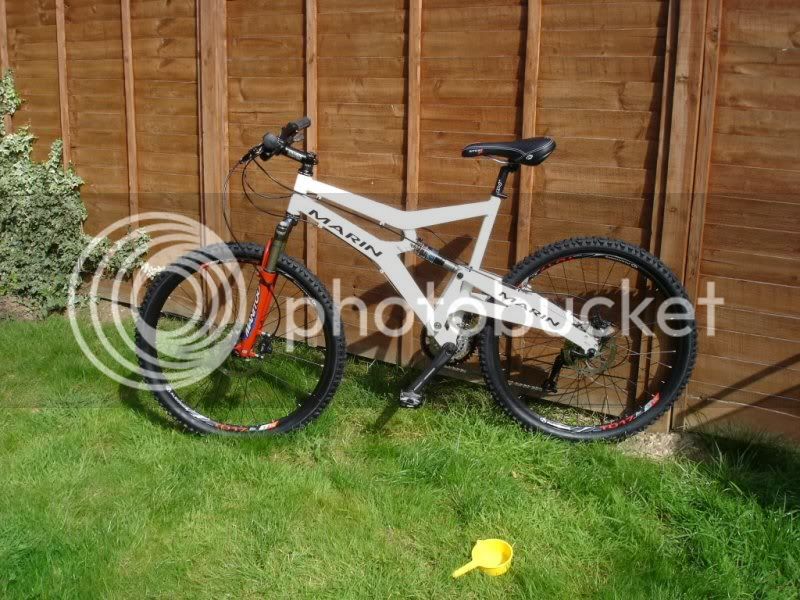

Ok here are some pictures.
The bike as it is now. I bought the frame, forks and rear shock off eBay a couple of years ago and had it built up by a local guy that runs a bike shop from his shed. He's very good!

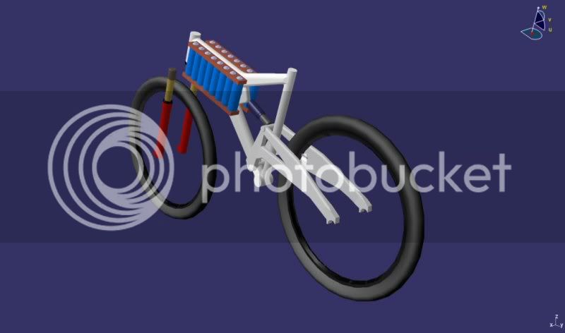

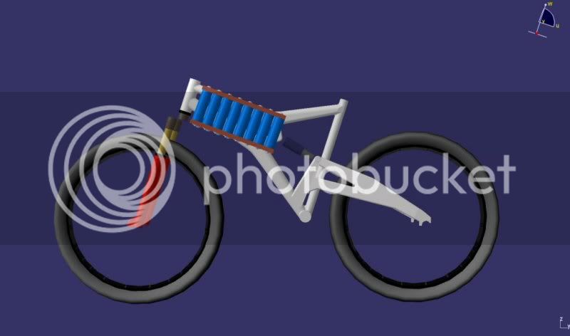

The next few are my first mock up of where I think the pack should go. I still need to figure out how to mount, protect and cover the battery in this location. I want it to be solid so I can go off road and not be limited to commuting as with my current bike.

Looks like a good start! Are those cells bare or in a case? I don't know what motor would give you 32 with that battery, but I would imagine, it would be on the slow side getting there. I can tell you with that battery and a standard 30A controller, I get 27 MPH with a 9 X 7, but if you run higher amps/volts I'm sure you can get the speed you want. I know there are different windings of 9C motors, but it seems most of the faster windings suffer at the low end, but with the 9 X 7 it seems you can just add a higher amp controller and voltage and still keep the low-end torque. I know that some have achieved 40 MPH with 60A and 72V, so I imagine you could scale that down a bit for 32.
Yes the cells are bare in the mock up. The only thing I added was the orange building blocks. I think I will be attaching them to a back plate mounted on the frame and then box them in some how.
