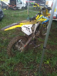

Hi guys,
Since the thread I posted few months ago I found a pretty good deal on a RMZ250 from 2008 nearby. Even thought I haven't figured out everything yet I decided to pull the trigger, start building it and to learn as I go. So far the bike will remain as it is, I am not willing to put a lot of time and effort if I don't like it in the end (I am also rebuilding my 2 stroke at the same time, which has the priority finance wise). If I end-up enjoying the e-RMZ I will take everything appart and give the chassis a full clean-up/makeover.
So far I got the motor mounts from Lithium-king, sadly I messed up the measurement and I will need to grind the forward hole a little bit on the mount and will probably do so on the frame too. Probably 3-4mm off the mark, I knew that the measurement would be tricky but I didn't think I'd be this far off the mark. I installed my controller in the airbox, in place of the airfilter/filter mount (you can see it in some of the pictures). This seems like a good position to me as it allows some airflow to reach the controller's radiator. I also did most of the wiring, using waterproof connectors instead of the ones provided with the controller. Now the the motor is in place I need to figure out a way to make a battery holder and the final dimensions for my battery. One of the old motor mount located near the top of the rear shocks is in the way, I might cut it off in order to keep the battery as rearward as possible. Another point that was interesting it the brake pedal situation. I'd like to keep the rear brake at the foot in order to keep muscle memory for when I transition back and forth with my 2 stroke. I picked the motor as it is supposed to allow for the use of a brake pedal but the tip of the pedal is touching the hall-sensor cover. I will see if I can space it out to run it properly, otherwise I will need to run it super low which isn't ideal.
So far here are the specs of the bike:
- Bike: RMZ 250 2008
- Motor: QS138v3 70h
- Controller: Fardriver ND96680
- 13t front sprocket (lithium king), 48t rear sprocket (came with the bike)
- Throttle: CCXT e-throttle, sold as a Surron throttle.
I have a few questions that came up along the way, hopefully some of you can enlighten me.
- My goal is 25kw in my normal map and 30kw for a "MX" map. I picked the ND96680 thinking that it would be well able to it, but looking back at the specs the line max Amp is limited to 250A and phase amp is limited to 680A . So is it possible to reach 30kw or not ? Going by the line amp my max should be around 24kw, but if I go by phase amp I would be able to reach my 30kw comfortably. I find this confusing, like how is it possible to have more phase amps than the max provided by the battery ?
- In some builds I saw some master switch of fuse between the battery and the controller, but many (most) builds don't seem to include one. Is it necessary ?
- As for the battery I got in touch with Amorge asking for a battery around 5kw. With the budget that I am willing to put in this it could either be a 26s10p with Samsung 50s, or a 26s12p using EVE 40P or 40PL. Which one seems best in your opinion ? If I did my research correctly, the EVE pack would be slightly heavier (~1kg) but it might be cheaper and would have better performance with less V sag.
I might try the bike with a 72v Talaria battery from a friend, just to get a first idea of how this can turn out. Some rachet straps would do to install it and ride the thing on green lanes 😬

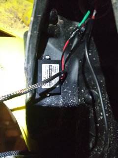

Yesterday I finally got a chance to finish the installation of my motor, cable routing and all It will have to come out once more to install the battery but all fits very well which I am happy about since I only have very limited tools (dremel, hand file, hacksaw). If you take your time things are possible.
This morning I added to weights on the bike to simulate the final weight and move them around to see how it affects weight distribution. With an extra 31kg I got a total weight of 108kg which isn't bad. I think Amorge said the parcel or the battery will be 27kg, not sure. But the theoretical weight of the 286 cells should be around 20kg, not sure how much the connections and metal box weight but the 31kg should be way over the actual weight. As for the front to back weight balance, moving 15kg from just behind the steering column to above the shock head I only managed to shift 1.5kg of weight which all things considered is pretty insignificant. It also means that the shift in battery position (maybe 1 or 2kg across a few cm) will be absolutely negligible. So the battery placement will definitely be more dictated by easy of manufacture rather than CoG from now on. This also make E&C claims that their kit allows to maintain the YZF balance pretty dubious, not that is doesn't maintain balance but rather that few cells here or there are not enough to dramatically change a bike balance (if 15kg across 35cm only manage to shift 1.5kg at the axles).
Quick update. As I am still waiting for my batterie to arrive from Amorge, all I can do is make sure everything that can be done is done.
First thing was the fuse. I managed to find a fuse and fuse holder that are not massive but that are rated for "high" DC current. I found both the fuse and the holder on Aliexpress, it is rated for 150V DC and 400Amp which should be plenty safe for my 96V system with 330 line Amp.
So far my electric system will be as follow, if you see a major issue please let me know.
Battery Red > Fuse > Controler > Battery Black.
I wired a On/Off switch on the controler to start and stop the bike.
I also made a battery stand on which the battery will rest. I am still unsure if I should strap it or wedge it with high density foam. I think strap is a safer option. The stand is made of L-shape aluminium bars, put side to side on each side of the motor mount. I riveted the bars together to make sure all was aligned when drilling the main holes. L-shape bars are 6063 alu, 30x20x3mm profile. It should be strong enough. Hopefully the battery will seat well on that stand and in a good position.
I also shortened the motor cables as they were too long and making a mess in the airbox. While I was at it I took the opportunity to shrink wrap them in black. That is pointless of course, aside from being better looking in my opinion lol.

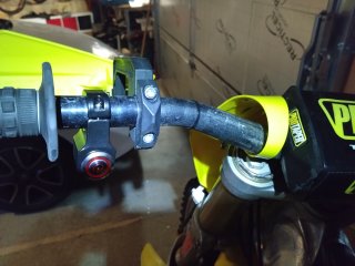

Quick update, today I received my battery from Amorge (BAK45, 96V, 49Ah) so I instaled it and got to go around the block with the bike for the first time ! I played a little bit with the parameters but since I am still recovering from a knee surgery I couldn't even put my right foot on the peg so needless to say tye testing was pretty limited. Still, it was nice to habe it finally running. Few points:
- I put 330 line Amp and 680 phase Amp. At first I thought it was quick but not that quick. Later I played with the map switch and guess what ? I was testing the whole time on the mid power map ! When I switched from what I though was the max power to the actual max power that was a massive shock lol. I couldn't keep the front wheel down 😂
- Currently the battery is connected with the extension provided by Amorge but I would like to put the discharge cables at the from as they as really squished by the resevoir right now and it can't be great. I looked around for QC10S plugs already setup but they are at best 6AWG when Amorge provided a 4AWG cable. The total length of the extension would be somewhere around 50cm. Do you think 6AWG could work ? I am not too keen to make my own from scratch to be fair.
- The cheapo Surron throttle is doing fine so far, it seems easy enough to control with some basic paramters in the FarDriver app. I will need to expriment more, especially for low speed throttle control for pivot turns, double blips, etc.
Aside from that the bike runs great, I need to play around more with field weakening and regen. I'd like to have a usable bike for when I will finally be able to take if offroad. Then I will have to deal with suspension, tire setup, etc. so I'd like to not have to do too much on the engine when the time comes.
