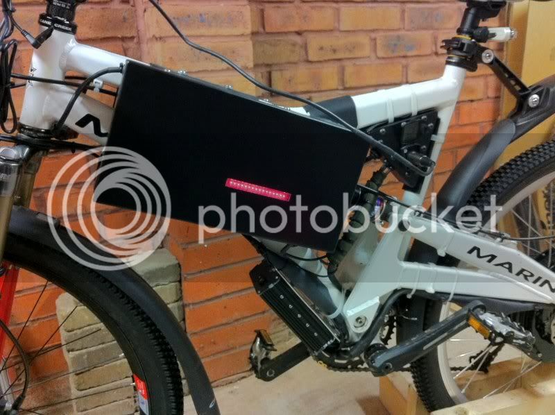

Just read through your build that's one mice job you done there.
I do have one thing to say about your batteries and BMS, you are using headways that have a high output on them but if I am not mistaken you are Using a ping BMS with them the BMS should be great for charging the headways I am putting a "48V" battery pack out of LiFePO4 from hobby king equally high output, with a ping BMS for charging the pack. Unless ping have made a radical improvement in how they make their BMS they will have a amp limiting circuit on the BMS Alongside the LVC circuit, this will probably limit you from getting the best out of your headways you may find that the BMS cuts power from the battery if you try to draw too many amps it ust to be 40A for the big 20aH packs ping made that may have improved now, if you do find that the pack is cutting out on you when you are drawing high amps say on a hill or at the traffic lights let me know.
I have an alternative way of using the batteries with a ping BMS, I have fitted 2 of my 8 channel LVC boards to my pack they work just like the LVC/HVC boars that gary sells but only have the LVC circuit I hope it will be ideal for use in your situation and for the test pack I have just finished building for my wife, you get the LVC protection you need when ridding the bike with the ease of charging that a ping BMS gives you.
You would need 2 of my boards plus probably 4 silicone covered balance wires I am bound to have them in stock.
See if the setup you have gives the amperage output you want and so the speed you want if not and you want mor power than the ping BMS will give you come have a word with me I willshow you how to take the amperage limit out of the ping BMS equation.
Geoff

Thanks for your comments and suggestion's. The Ping BMS I'm using is the high rate version. IIRC it is good for 60A continuous and upto 100A for a couple of seconds. I think it should be fine.

Yes that BMS looks like it will do the job my last ping battery was several years ago and things have progressed for the better since then, my idea is still good for those out there that started with a ping a few years ago and their BMS survived when the cells would not hold a charge, this is what I have done I did not buy a new one just new cells.
I'm in Nottinghamshire about 250 miles from you, but if I book in advance about £30 away on the train with my train folder for decimate and my mountain folder if I am lucky.

Your battery box hang on top on the frame. It gives you great balance and this similar Rebelpilot's ebike. It made me want relocation my 20s2p to front as similar yours.
