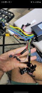

I have Joyor S5, and i wanted to replace controller and throttle since my display was broken and i have already repaired controller before. I ordered from Amazon controller and throttle bundle and now when i connect controller with scooter battery and motor wires, my display turns on but throttle does not work. When i connect "self learning wire" on controller and turn the scooter on my motor is sponning 4 km/h constantly without throttle. Also interesting thing is when i connect three pin from controller with three pin connector on my back fender light and when i turn scooter on my motor is spinning on maximum speed (1st gear 18 kmh, 2nd gear 25 and third gear 50 kmh) can anyone please help me, i will post pictures down below so you can see everything. If you need any infos please just write me here on on my whatsapp +491786102812

Was the self learning wire still connected? The self learning wire needs to be unplugged after the motor is confirmed to have proper spinning direction.
It's not connected (just in this picture). When this wire (white) is connected, when I turn on the e-scooter, it automatically started motor and goes 9kmh thag go down to 4kmh and stays there, after i unplug white wire, when i turn on my scooter, my throttle does not response in any gear

Per what I see on the Amazon listing (guessing, since you didn't provide the link) the red black white is the throttle connector, unless you fried it by connecting it to your brakes. The trigger throttle has a single white wire, 3 pin connector, the white being the throttle signal. which should line up with the white signal wire on the controller's 3 pin connector.

Problem is that that i have bought bundle ( trigger with built in display and controller, display/throttle has 5 wires connector which is connected to the controller and from controller there is 3 wires for motor and 6 wires connector i guess for hall sensors ( i think i wrote this correctly) but also my controller has pin with three wires maybe for separate thumb trigger without display. Here is the link

And when i connect my display/trigger to the controller and than connect controller with battery and motor ( 3 separate wires plus 6 pin connector ) i can turn on display, when i spin wheel with my hand display recognize speed but when i shift in gear and kick the throttle nothing happens, i go to p settings changed zero to non zero and non zero to zero start and nothing happens
I own this controller. You need a separate throttle because the trigger throttle does not work. Trust me!

Your link shows that the throttle also has a single white wire connector, like the one I linked, which needs to connect to the throttle connector that you mistakenly connected to your brake lights for whatever reason.

Those are only wires from my scooter (blue yellow green) 6 pin connector and battery :) i dont have anywhere to place white with one pin :) it should go from throttle to controller and from controller throught 6 pin

Ignore the single BROWN wire coming from the 6 pin trigger cable. It use to be a headlight/taillight, however it's missing a wire, but the controller already has a two-pin connector for tail lights (red/black), so Ignore it. The trigger throttle does not work; you must use an external 3-pin throttle and connect it to the throttle plug (red,white,black).
For brake lights, you have to make a custom connector (black/red and cut one of the brake signal).
