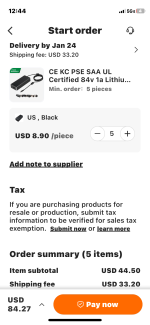

Yea I’m looking for something 60-90 watts that is small and no fan.
would these work?
Ill use a bms but still rather not have such extreme voltage adjustment possible from a tiny screw
In the past I had a couple custom made 87v, silent, 80watt, small supplies made by a place on alibaba but they won’t make anymore. They were only like 30$ but lasted maybe a year. They were ideal for traveling being light and could fit in my pocket.
I put an ad on freelancer to make it.
