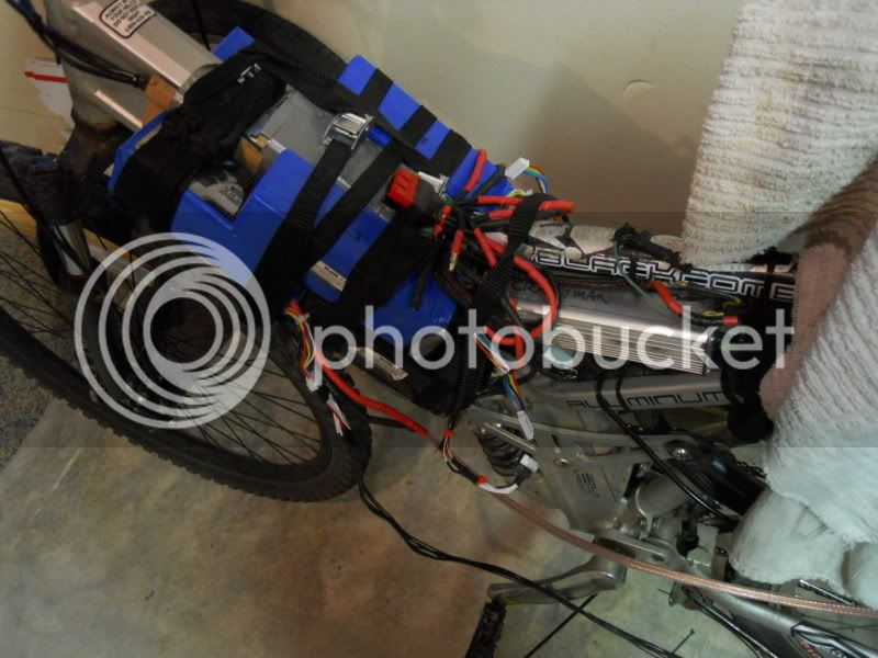

This is my lipo setup 44v 15ah 50v hot off charger (6x 22v 5000mah 20C Turnigy packs using GGoodrum parallel adapter boards)......
file.php
file.php
file.php
Charged with 48v 320-48 Meanwel PSU balanced with
Battery Medic combined with a GGoodrum battery Medic Booster
Weighs around 6 kilo including ESC and throttle interface (about 11 pound?)
KiM

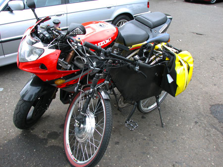

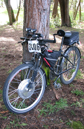

Chem: Originally LiFePO4, then switched to LiPo in February and never looked back.
Volt: 37V for many moons, then up-volted in June to 55V
Cap: Depends on use – Commuting 20-30 mi: 15Ah; Century rides or trips into Seattle: 50Ah @37V or 35Ah @55V; Touring: 60Ah @55V.
Cost: ~$2k; does not include bms, chargers, bags, returned faulty items, or any other related battery toy.
Before June, I had 10s3P in the front Triangle bag for commuting. The Trunk bag is added to augment an additional 10s6p or 7p for century rides or heading into Seattle.
Detail of Trunk bag:
The Trunk bag wasn’t fastened down all that well so I ended up using an old inner-tube with the stem cut out as a nice stretchy tie-down; couldn’t find a decent picture of that…

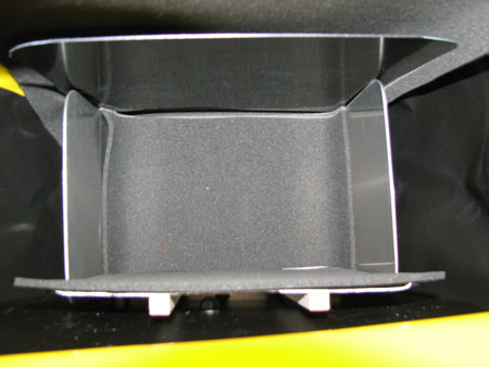

When touring I use the Ortlieb bags. The bike has pretty much remained in this configuration ever since ~ using the Trunk bag for commuting, or the Ortliebs for longer journeys.
<sigh> It's not the best setup: Like the Trunk bag, I have to tie down the Ortlieb bags with a cargo strap to keeps the bags from flying off :roll:
Inside Ortlieb Bag, I created a u-shaped framework from some thin aluminum and I bonded 1/8th-inch thick high-density closed-cell foam (HDCCF) for cushion. Also fab’d a back wall in the same manner with balsa standoffs to get the batts away from the protruding crown nuts (at the bottom of the image) which faces the inside towards the rack. On the opposite side I used a black sheet of 1/16th thick ABS with a large swath of HDCCF padding to protect the batteries from whatever external elements that may come crashing in, and yet the outer wall still remains flexible.
In this view the batteries are loaded five layers deep, each separated by one sheet of HDCCF. I used my socks to fill in the voids front (L) and back (R).
In all, I have not been terribly thrilled with any of my bike bags; they just don’t do the job well for long-term and repetitive use. I am resolved however to remedy the situation: I purchased a walking-foot sewing machine, and I bought a shed-load of material for making my own saddle bags – which I will get to as soon as I put some other fires out: Film at 11! :wink:
Note: All batteries are Zippy FlightMax 15C/2C 5000mAh from HK. Out of 36, a handful are a little swollen but otherwise fine; they survived the tour without additional gowth :)
Enjoy, KF

999zip999 said:
Hay Kingfish, How much does your bike weigh total how far and how fast, top end ?
Bike Weight:
This is an estimate as I have not had the bike weighed other than by Amtrak…
On that journey I removed the Ortlieb bags, my packpack, and the front-mounted Harley-Davidson tool bag. The toady said my bike weighed 60 lbs (presumed that included the heavy cardboard box pictured below).
The tool bag and backpacks remain unknown deltas; if I had to pick a number the tool bag was 10 lbs, the small backpack with water, camera, and food was about 15 lbs, and main backpack was close to 40 lbs (more food, more tools, clothes).
The Ortlieb Backroller Classic:
I split the 36 batteries between the two bags evenly. Their weight is calculated to be 1.27 lbs * 36 = 45.72 lbs. I don’t think any of the supporting framework weighed more than a pound really. Meanwell charger assembly (2.38 lbs * 3 = 7.14 lbs, plus wiring), hiking boots est. 5 lbs, plus more clothes for padding, cabling, and the weight of the bags (5 lbs). Funny thing is that Ortlieb doesn’t publish the carrying capacity other than in volume :?
So let’s add up what we know:
  • Bike sans cardboard est. 50 lbs.
  • Batteries at 46 lbs, Charger at 8 lbs, Ortliebs at 5 lbs = 59 lbs.
  • Probably best to point me 50 lbs of stuff.
  • Me: figure about 150 lbs wet.
  • Total: estimate 309 lbs. which is within the predicted weight budget.
Farthest Distance:
Farthest in one day on a single charge was 173.3 miles with caveats: I stopped for about 45 minutes at an unplanned location to appease my mother; the ride into and out of this homestead was very steep and all the charge that I had made whilst sitting there was burned off getting back out to the main highway – so I consider it a wash if not a loss. The batteries were configured as 15s9p, and topped up to 63V. Based on what I learned from Day-1 of my trip, when the system reached 54V I had about 10 miles left to find a Pepsi machine :twisted:
Top-End:
On the flat, 36 mph easy at any time with or without a load. On the road trip I hit 45 mph going downhill with a logging truck on my arse. Just this weekend the CA says I hit 49.5 mph someplace; I met up with LFP/Luke for Seattle Seafair and there was one spot where I was tear-ass down MLK Blvd heading north towards Madison Ave with him in front on his motorbike: That was a fun ride! So it might have been there; I don’t know for sure.
LiveForPhysics/Luke’s ride and my P0 chained together at Lake Washington Blvd Park. Sorry - forgot to take pics of the Hydros racing.
With all that weight in the back the front tire slips a bit so it could be a phantom accounting. That morning I discovered this: Continental Contact Reflex completely worn down to the carcass.
Had it replaced with a Specialized Armadillo 26x2 on the way to Seafair by Gerk’s in Redmond. That's one beefy tough tire! We were able to re-use the Specialized Desert tube.
That’s wot I knows, KF
