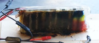

OK Wow. So we managed to do the tests just over a week ago, with both a high speed (240fps) camera and an IR camera recording the experiment. We were initially trying to cause a cell venting with with the bare unpotted packs but it proved trickier than expected to have a "short circuit" that would drain enough current to cause the cells to go, but not so much current as to vaporize the connecting tabs. However, with the potted units the tabs were in good thermal contact with the resin and that seemed to allow them to handle more amperage without melting apart. In the end, a long spool of copper wire served as the perfect load for this, giving us an initial ~25C discharge rate on the cells.
Have a look at the results:
https://www.youtube.com/watch?v=oBlac5gWLfI
[youtube]oBlac5gWLfI[/youtube]
It took almost 2 minutes of short current flowing during which the batteries drained over half of their energy, before finally something went open circuit. At that point in the test you can see that cell#4 is clearly hotter than the others, but it's not until the current has dropped to 0 amps that things really get exciting, and then one by one nearby cells that were just hot now start to go thermal too. We sped up the IR video feed to 5x rate but whole process took about 20 minutes before the pack finally started cooling again.
To the credit of the cells and the enclosure there were no flames or fireballs, but still quite a lot of unpleasant smoke and charring. Here's what the pack looked like after the fact. The blue/red/yellow colours on the right was us just doing a quick experiment with drops of dye on the fibreglass cloth before potting.
it appears that the spot weld on the terminal of cell #4 was where the heat was concentrated and what led to forcing #4 into thermal runaway.
was there anything obvious about the type and number of good weld contacts on those spot welds that seemed notable? did #4 go open circuit because it popped the pressure relief plug?

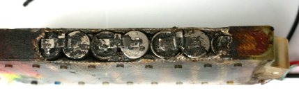

So I did my best to cut away and scape off the charred fiberglass under the bottom of the pack to see if anything looked different around cell #4. Have a look:
First, I was surprised by just how in tact most of the enclosure still was, even though the resin had been burned/charred right through in some places, the glass fibers maintained a full wrapping and it took a lot of work to cut away a section like this. Secondly, there didn't seem to be anything anomalous with the tab or tab weld around cell #4 (4th from the right in this picture, since it's upside down relative to the video). And finally, I was surprised at just how clean and in tact the cells and tabs were. I suppose it's just because there was no oxygen in the environment while they were heating and venting so that the metal wouldn't corrode.

i could not see any defects in the welds on the 4th over, but the 5th shows a big divot that is missing from the serial strap where one of the spot welds would have been.
i think your video is more experimentation than allcell has done. it appears that the heat is transferred through the metal tabs and not through the case and i was thinking that maybe the spot welds would show why the resistance heating was focused there on the ends of the cans in the FLIR. it could be the connection between the current collector and the can inside too.
since the heat is transferred through the metal tabs and into the case through the current collectors then that section at the top of the separator where the current collector is located may be heating the separator enuff. you should be able to find some data on the melting point or fatigue point of the polyolefin the separator is made from. then use a grinder and cut off the tops and look at the current collector and separator. if not melted in place you may be able to extract it and unroll the jellyroll. and look at the contacts between the current collector and cap under the popoff to see if any are distinctive.
i just do not see how the phase change material will have much effect on the heat transfer through the metal parts. it does not appear to go through the cases but the fact that FLIR does not show case heating may be indicative of the fact that the heat is transferred away from hot spots inside more effectively when there is large surface areas to radiate from.

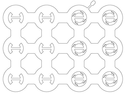

The first image is a drawing (for a laser-cutter) of a metal bus-plate that provides four "S" shaped fuses per cathode/positive "button" (the six cells on the right-side half), and the pic below is the single fuse-wire to the cathode of an individual cell in a Tesla automobile pack.
Yeah, but to the topic of this particular thread, the presence of potting material around any thin metal tabbing material seems to dramatically increase the current handling capability before the fuse section would melt apart. So if one was to take a pack with laser cut fused tabs like this designed to open circuit with excessive current, and then pot the battery as I'd done, then there's a good chance the fuse behavior would be heavily altered and wouldn't offer the same protection that it does in still air.
As a result of these experiments, I'm heavily leaning towards having a fixed SMT fuse on the BMS PCB, so that in the event that a BMS fails in a way that the ouput fets are fried (and hence always ON), then if there was a short on the terminals there would at least be a fuse to prevent the scenario that I video taped. We'd just have to be exceedingly careful that in the BMS design proper there is no chance of the fuse ever blowing during normal use, since it's not replaceable. Previously I'd been counting on the tab material providing the fail safe in this scenario since that's what happens in open air. Not so much when it's potted.
