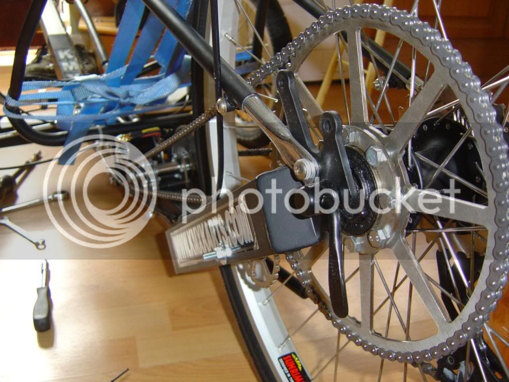

what I'm putting on my trike -
wheel sprocket is on freewheel LH threaded onto hub disc mount
and a closeup of the 2 stage reduction bit. BTW I've lost faith with roller chain for the first (high speed) stage since my first one threw out all its lubrication....
might give you some ideas ;^)
All the custom parts are laser cut stainless 3mm thick. Except for the 12mm jackshaft. That includes the wheel sprocket.
