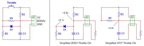

I believe that will only charge the cap to 5v x 1K/(2.5K+1K) = 1.4v
I think something like this will work:
This should have a charge/discharge response like the blue curve below.
  • The cap charges to point 'A' - the voltage set by the voltage divider formed by R1 and the controller pull-down (somewhere between 10K-68K depending on the controller). Ideally that voltage is about 4v.
  • When the button is released, the cap discharges through D1 and R2 to about 0.7v at point 'C' (pretty quick). The lower controller throttle limit is about 1 volt so motor power should stop at 'D'.
  • The cap will continue to discharge to 0v through the internal controller pull-down resistor in parallel with R1+R2. (slower)
The value of R1 is actually kind of important and depends on the controller pull-down resistor. If too large, the throttle won't reach WOT voltage (about 4v), if too small, WOT voltage will be reached before the cap is near full charge and the available time delay will be shortened as shown in the green curve above. In that case the cap voltage exceeds the max controller input voltage (WOT) at point 'B', wasting the time delay between 'B' and 'A' (the horizontal distance).

Okay - here's yet another version. :D Try the circuit on the left below:
We add R3 to the earlier circuit to set the baseline ZERO throttle cap voltage which is assumed to be greater than 0.7v - the D1 forward voltage (middle image above). D1 makes this more than a simple resistor divider, but the effect is similar with R2 and R3 as the primary contributors. When the button is pushed, a slightly different divider is in play (right image above), raising the cap voltage to the WOT setting. When the button is released, C1 discharges quickly through D1+R2 and stops discharge at the ZERO throttle divider voltage. This should give curves something like this:
Because R1 does not play a role for quiescent ZERO throttle, use that case to adjust R3 first. Setup should probably go like this:
Choose a value for R3 such that SIGNAL is about 0.1v below the voltage at which the motor does not run or creep (~0.8v):

Choose a value for R1 such that SIGNAL is 0.1v above the voltage that gives max no load motor speed on the stand (~4.0v):
  • unplug the motor phase wires.
  • with the button shorted, adjust R1 until the meter shows the target value
  • test with phase wires plugged in to verify motor achieves max no-load speed
R1 will probably be 12K or less.

I think for your ebikes.ca controller R3 will be in the neighborhood of 40K. If R3 is too small, the motor will not turn off completely, so erring on the high side is good. If you are trying to really tweak this in to match your motor ZERO and WOT voltages, the extra +/- 0.1v mentioned above is to add a little margin of safety for temperature and component aging. Obviously some trimpots could be added for R1 and R3 to make this easier, but...

Anyway, I've ended up with R3 at 128k (3x64k in series), which seems a bit higher than you were expecting, then R1 at 10k and R2 at 1k. Works ok. goes from 0.4V to 4.1V or so. Not perfect, but took a lot of messing around to balance things. Burnt myself a couple of times with the soldering iron trying to replace resistors!
There was some weird stuff going on when I was trialling just R3 - it would go to a set value when I turned the controller on, then after about 2 seconds, jump right up to 4.8V or so. Same whenever I changed the R3 resistor. Anyway, I think I've got there. Perhaps the time delay for WOT is a bit long now, for some reason, so may need to go for 50microFd for the cap.

There is a bit of a discontinuity near 0.7v. For large R3, D1 does not conduct and the pull-down is in play (around 70K in your case). As R3 is reduced, D1 will begin to conduct and R2 comes into play - very small at only 1K. I didn't make a big point of it above, but I was assuming the case with D1 conducting so the throttle voltage would be about 0.8v to 0.9v. This funny response to the R3 value would have been easier to see and adjust with a pot - hopscotching around with fixed parts probably hid the behavior - sorry 'bout that. With the 0.4v low level, it looks like you are still running on the pull-down - which should be fine.
I'm not sure about the funky R3 values that caused the jump to near 5v - looks like the cap was able to charge fully for some reason (check to see that D1 didn't get zapped in the experiments) - I need to think about that one.... These fully passive component solutions are always a war of compromises because of trying to balance fixed curves and behaviors without active parts to fix things up.
