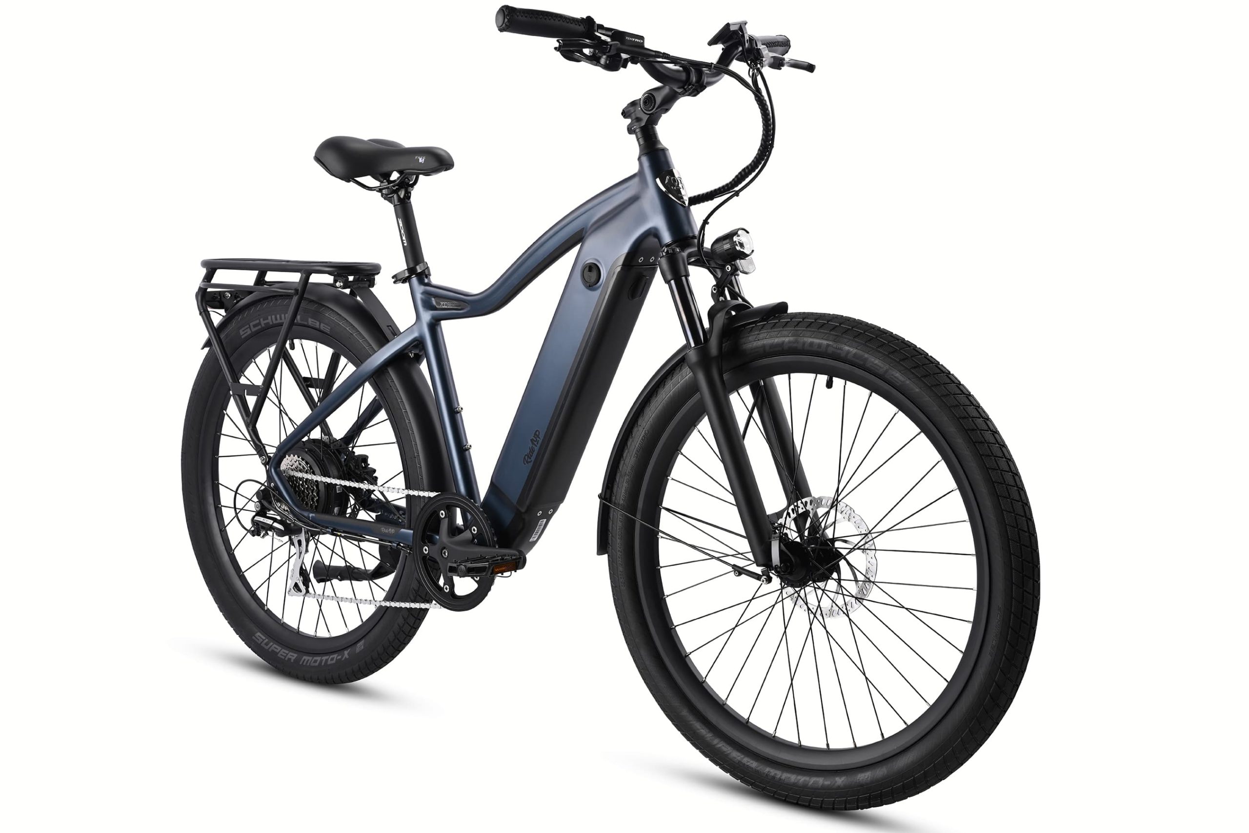

So, right here, behind the chainring. The thin part under the battery. This is where the controller is currently installed. I'm thinking of cutting a 1" hole for a round vent and maybe one on the other side as well. Would introducing these 1" holes on either side create structural issues to the frame? There is already an opening under the bottom bracket for air to pass upwards and the vents, I believe, would let that air flow up and out of that cavity.
The vent would look something like this.
I’ve been monitoring the temp in that cavity, between the battery and the bottom bracket. I have a temp sensor glued to the outer part of the controller, just behind the FETs. It never gets above 50c. I’m sure the inside of the controller is hotter. I’m just thinking of how to get more airflow in that area, as opposed to externally mounting the controller. The controller is 48v 25a (max).
If the outside of the controller in an enclosed space with little or no airflow reaches and maintains a certain temperature, then the inside of it will be the same temperature.
There will be momentary increases at the FETs, but if the case at the FET location does not increase in temperature momentarily after high-current motor demand, then the system is not peaking to much above what you see outside.
The best thing you can do to cool the controller other than external mounting would be to secure it to the frame / housing itself, at the area of the casing that the FETs are mounted to, so that it conducts the heat directly to the frame, which then already has aircooling and a lot of surface area. This is best done to an unpainted area of the inside of that housing, that's flat enough to mate fully with the controller's flat casing area.

Ok. Good to know. Sounds like Im in good shape then. Usually the temp is 35-45c and nears 50c but never exceeds that.
