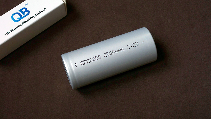

Queen Battery QB26650 2500mAh
The heat shrink tube tells us only the model, capacity and nominal voltage.

Measured dimensions: 26.6mm (diameter) × 65.1mm (length).
Measured weight: 84.93g.

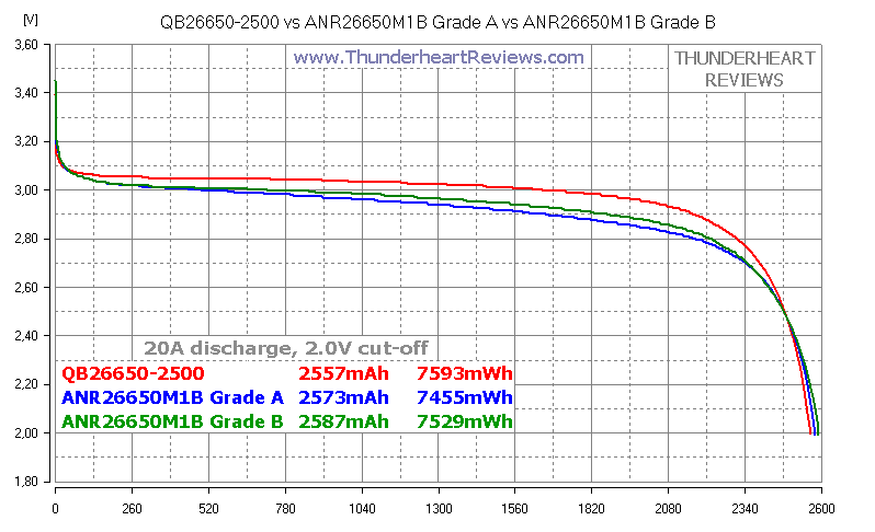

More than a year ago i tested and compared A123 Systems ANR26650M1B Grade A and Grade B cells using v.2.0 of my battery holder. It's a long time i'm using v.3.0 so it wouldn't be 100% fair to compare tests done using different holders, so i decided to re-test A123 cells in v.3.0 holder at 20A discharge. I did each test 4 times for each cell and here we are:
Just look at those numbers! How close they are! ANR26650M1B Grade B has the highest capacity and QB26650-2500 has the lowest but the difference is only 30mAh!
The picture changes when we look at the energy - QB is the best and ANR26650M1B Grade A is the worst. The difference between them is as low as 138mWh!
Let's forget about numbers and look at the curves. ANR26650M1B's curves are good as they should be, but look at QB's curve. It's even better! It doesn't go below 3.0V most of the time (approx 65%) while A123 Systems' cells fall below it relatively quickly. I started to go into numbers again... Well, i just like the QB's curve more))
Now let's look at this comparison table
A123 Systems' cells are winners in capacity and max continuous discharge rate while QB26650 takes the gold in energy and max pulse discharge rate. They all can be discharged down to 2.0V which is very good because most of LiFePO4 cells are limited by 2.5V.
