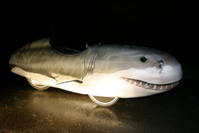

Does the quest come in any other color besides yellow? Everytime I see one, I think of a banana. :)
I think one in DayGlo Pink would be really nifty. Highly visible, very fast....
On velomobiel.nl you can choose between red, white and yellow. RAL colours. But you can also let it be custom painted. It will set you back €600,-. Some people even let their Quest be airbrushed:
