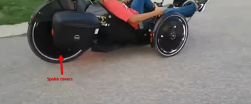

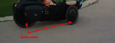

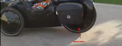

As the top of a wheel is heading into the wind at twice the speed of the bike itself and as aero drag goes up with the square of wind speed; These Aerodefender mudguards make a lot of sense:
https://www.bikeradar.com/news/null-winds-technology-fairing
(I NB that they don't cover more of the wheel as that would cause unacceptable instability in cross winds, so you only want too cover the bit of wheel moving more/mostly into the wind)
They look ass on a bicycle, but I think that on a velomobile with outboard or open front wheels something similar may actually look pretty good.
Both the front and rear models should look even better on any recumbent bike, but thats a matter of opinion.
The spoke 'fairing' things in the pics look pretty ass too but the physics makes sense on anything doing more than 20mph? most of the time.
As they weathercock, they will ameliorate side winds some vs a std spoked wheel while actually providing a modicum of forward thrust if very slightly sprung to 'return to center'.
I think a better, more aero, slightly sprung, carbon/glass fiber 'Spoke Sleeve' thing would be a goood idea for aero enthusiasts and any fast moving bicycle, like E-bikes, in general.
