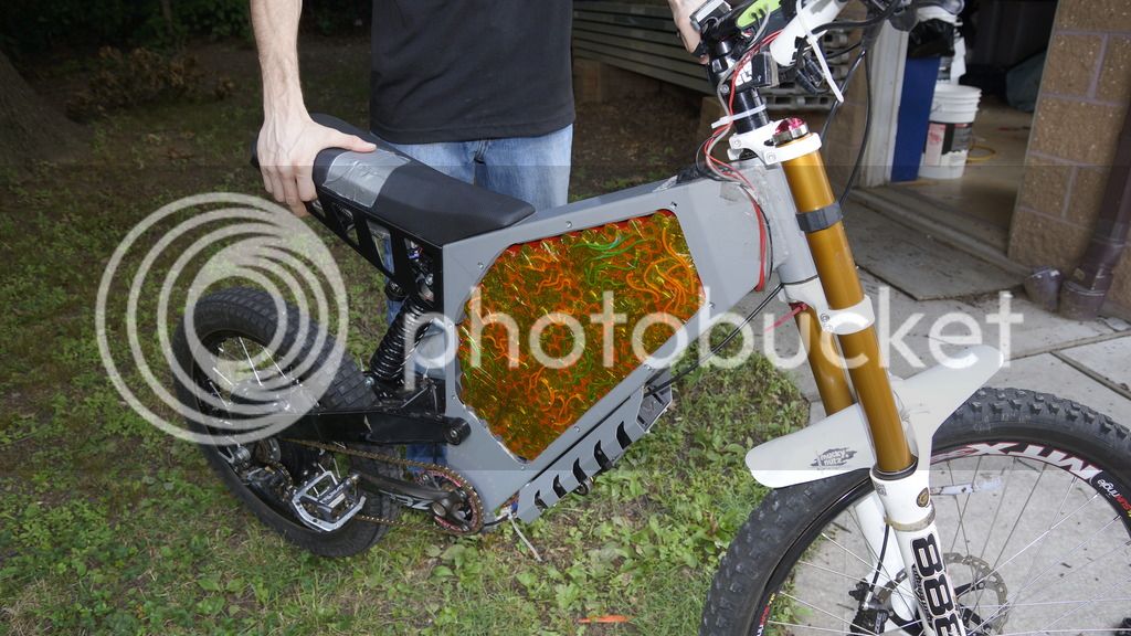

Took my side covers off to use blue locktite on the bolts and decided to check out my 280 cell battery.
Still in perfect condition after months of use. Voltages of all cells are all within .005 of each other as I never got around to putting the cells in parallel.
Pack is still tight inside the closed cell foam. When I put the side covers on I place thin foam sheets on the sides which squeeze the pack from the sides, the pack sees very little movement.

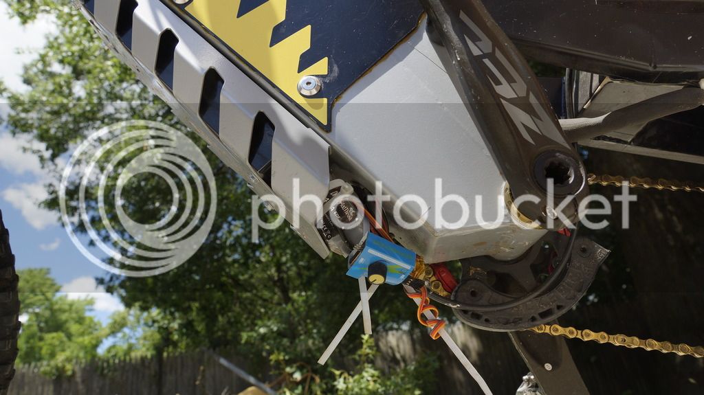

Looks secure! Do you have any shots of where you stuffed that mass of cables coming out of the Adaptto?
I wish the leads were longer as I don't like the big jumble of wires sticking out the bottom. I may move the controller further up the frame to have the controller shield cover more of the wires and wrap it in a neoprene sock like we use on chain stays. The controller will stick out the top but that is better than the wires hanging down low. Whenever I splash through water or wet mud, that controller trys to go into charge mode so I need to protect those connections better.

Actually Qulbix made it so that the wires come out of the controller and get stuck up into the frame through a hole. It is a very neat setup. I plugged all my connections together then stuck then into the frame. There is another hole in the back of the bike where the motor connectors come into the frame.
Unfortunately I don't have a clear shot because I mounted my hub cooling speed controller and servo tester temporarily there. But in the picture you can see the wires would just go right up into that hole and all the connectors would be in there.

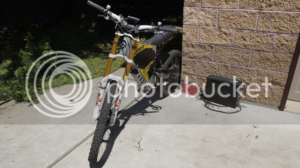

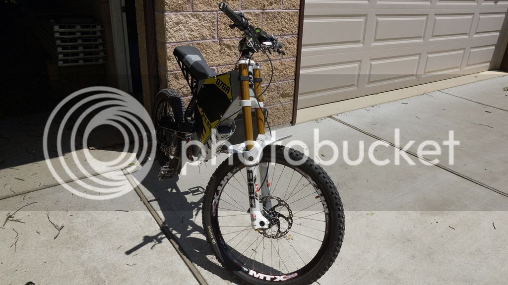

Finally got done putting the rest of the stickers on the bike, especially the front one so my bike is finally complete except for paralleling the battery cells and hooking up the BMS. I am very happy with the looks of the my Q76R bike. I am also very happy with the handling and don't see how the bike can be made to handle any better.
I of course need to repair the torn seat and get rid of the duct tape.
I don't know how Qulbix does it with just a one person operation and continues to come out with new and improved frames.
It also seems that every new frame he makes is custom made to what I want. I will be shocked if another frame comes out that makes me want to upgrade from my Q76R. But I've so far bought them all, raptor 165, raptor 140, and now the Q76R. I never built the raptor 140 because of the Q76R.
