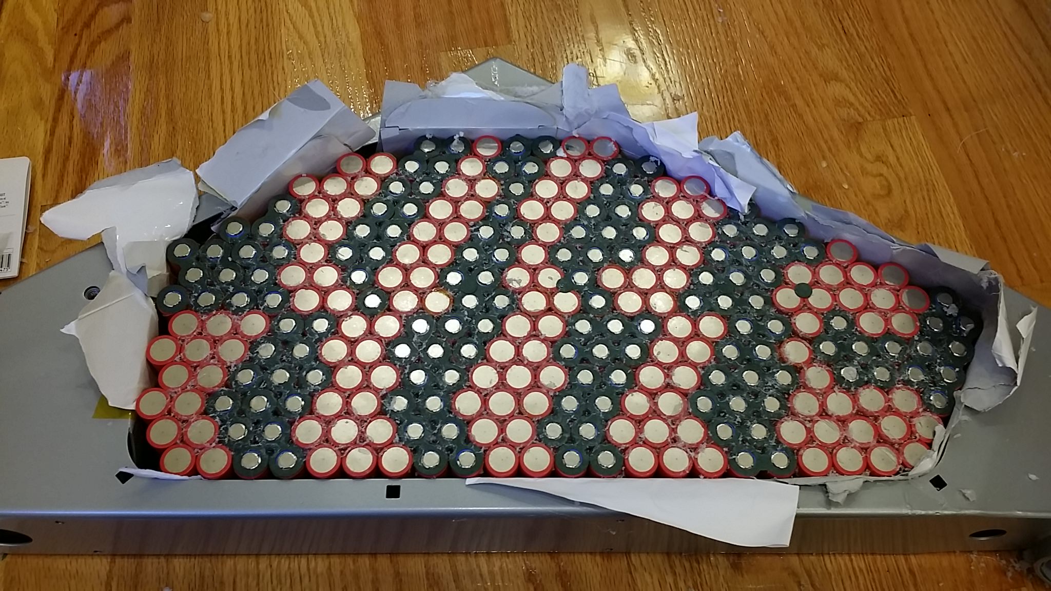

Hello everyone, first of all, thanks for all the information you have shared.
Forgive me, I use a translator, I have a basic level of English.
I present to you my humble, but powerful Q76r 20s 2p (multistars 4s 10A). I acquired the frame and motor (Qs205 v2) in the pre-order, two and a half years ago.
The reason why I register in the forum is because soon I want to update my battery to the maximum (cells 18650 20s 14p). I like to travel more than 100km, my record was 135km in eco mode, helping a lot with pedaling, definitely getting too tired. I need to go like a gentleman (Boost mode + 50kmh on dirt roads without pedaling), not like a grandmother (eco mode 15-20kmh pedaling).
I have doubts about which would be the best design for the battery, I really like the design of Offroader but I think it could be better to use a sheet of 0,3mm (Nickel) joining the 14 cells, With the same position of cables welded to the nickel used by Offroader in its design (7x16awg), one cable every 2 cells
You understand me?
What do you think about it?
Would there be a better way to make it so that the balance is perfect?

Hola amigo, beautiful build. You have some quality components there and the only way to improve your build would be to have more battery for more range/performance. No doubt building a battery like Offroader has would be the best improvement. Again, your bike looks beautiful. Any chance of you making some videos of you riding in Spain?
I would definitely build the same 280 cell battery I have using the same red Sanyo 3500 MAH cells I use. This pack is amazing, and seems to be holding up over the last two years. It has only lost less than 1% of its capacity last year also. It has so much capacity and gives you so much range.
I have never hooked up my BMS or even put the cells in parallel yet, but you should do that. Last time I checked not a single cell has come out of balance.
Just a heads up, it looks like you have the 1st version of the Q76R, that is the same frame as mine. You will have a difficult time getting 280 cells in the frame, you will have to glue the cells together while compressed into the frame in order for it to fit 280 cells properly. You may also need to slightly file your frame opening also in areas to fit the pack easier. Qulbix did a revision on the Q76R and it now has a bigger frame opening and probably much easier to fit a 280 cell pack.
By the way your stickers look you have the old version, or the same as me. While 280 cells will fit, you have to really compress the cells together and glue both sides of the cells like this through the hole the cells make when held together. Its a difficult job to do. One tip is I would make sure you cover all the terminals (negative and positive) of the cells with Kapton tape so you do not have to clean glue from the cell contacts when you have to weld the nickel to them. I spent hours cleaning off glue from the top of my cells, and you have to be careful because alcohol will instantly kill the bond of the glue. Alcohol is actually the best way to break away cells after they are glued together.
The other thing you should take into consideration is that .3 nickel strip is very difficult to weld if its pure nickel. I couldn't weld it properly because once welded I could pull the nickel off very easily. You would really need to use .2 nickel strip max, and I used .2 nickel strip. You could also possibly weld two strips of .15 nickel. You need to test your welder and see if you can weld .3 nickel, just pull on the strip hard after you weld it and it should be very firm. If you can pull it off then its no good. When I used .3 nickel I was able to pull the strip off easily. With .2 or .15 it was very difficult and the nickel would tear the cell apart.
There is much debate on how much balancing the current draw through the cells matter. Some say it doesn't, some say it does. You may not really need to be as precise as I have with balancing the current draw. It is very time consuming to build the pack the way I did, but it definitely stays balanced as I have not put my cells in parallel yet and my cells have stayed perfectly balanced. You may only need to use wires on certain areas of the pack and not others.
If you do it like I have and solder each of those wires to the strips, make sure you use a fan and have very good ventilation as you will be breathing in a lot of solder. I would also get a good soldering iron like a Hakko 951 or if you are in europe a JBC station.
I wish I had my hakko 951 when I built my 280 cell pack.

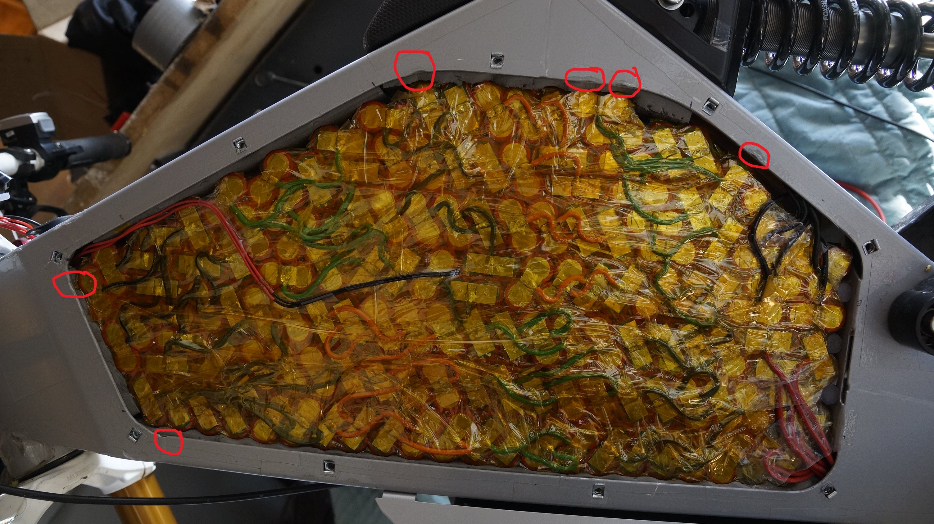

(You may also need to slightly file your frame opening also in areas to fit the pack easier)
I do not understand very well
Be careful with these cells that touch the frame a bit, ensure the perfect fit, right?

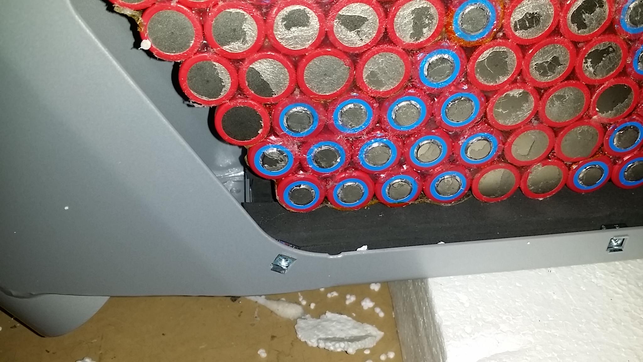

When you build your pack you will first have to place all 280 cells in the frame. Then you will have to take paper or cardboard and wedge it around the edges of the pack to really keep the pack extremely tight. This makes gluing it difficult and messy, you will have to glue through the little holes and squirt glue down between the cells when the pack is squeezed together. The glue will only go about half way so you will have to glue both sides.
If you take a look at how I did my pack in the picture, you will see that I wedged paper all around the pack to squeeze all the cells together tightly. Then I glued them when they were all tight like that.
In this picture you can see the mess I made getting the glue on the cell contacts because I had to wipe away the excess glue, this was extremely time consuming to remove and took me hours. You need to place Kapton tape over the contacts to avoid this, or even scotch tape will work but will leave residue behind that will need to be removed without getting alcohol on the glue that is between the cells as that will weaken the glue bond holding the cells together. SO you have to use a Qtip and be very careful. Just put tape to cover the contacts before gluing.
Actually, the reason for the glue mess was because after I glued the cells together there was glue sticking up that would have gotten in the way of the nikel strip, I had to use a hot clothes Iron to melt the glue flat as there was no way to easily cut it down. When I used the hot clothes iron it melted the glue over the contacts as you can see in the pictures.
A tip to glue the pack is I used a small metal round rod to push the glue down through the hole. What I did was squirt glue into the hole, then used a metal rod to push it down about half way, then squirt more glue, then pushed it down again. This is because the glue will not fill the whole easily unless you push it down.
Even with the pack being built squeezed tightly, I still had to very slightly file down certain areas of the frame so that the cells would fit in without rubbing the edges of the frame opening when inserting the pack. This is only when inserting the pack as once it gets through the frame opening there is plenty of room. I also reinforced the edges with 3M paint protection film and painted them so they are not so easily seen, but if you zoom into the picture you can see where I circled in red, where I filed with a rounded file the edges of the opening where certain cells were rubbing when inserting the pack.
What will happen is if you rub the edges of the cells when inserting the pack into the frame it is possible that you may short different areas of the pack if you cut into the outside of the cell. Imagine shorting two separate parallel groups through the frame while inserting it??? The 18650 cell shrink wrap can easily be cut into if you are forcing a pack through the frame opening and rubbing against the edges.
