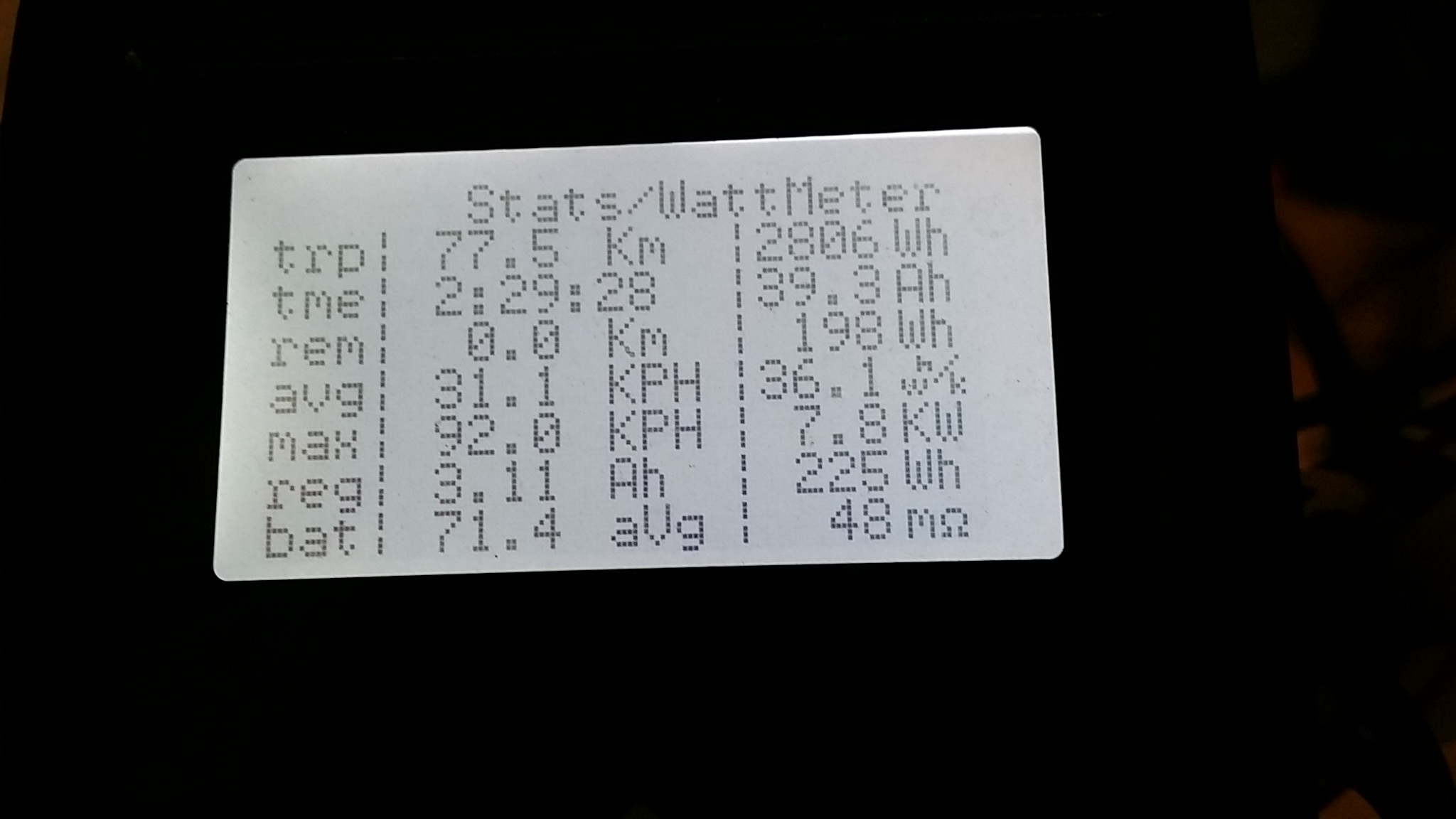

With the first autodetection 2 years ago I got my best mark, i obtained 13,4kw. I do not know what configuration I had, I do not remember well.
I touched and touched the configuration.
Finally the Boost mode I was work at 60-62km / h (I don't know the kw, I forgot) but I settled for that.
After manually calibrating the motor, now reached 8,6kw (Probably they can raise more the kw, I only tried to accelerate in slight slopes, I would have to try to accelerate in very inclined zones to see if the demand of energy goes up.) at 71km / h on land in Boost mode, perfect speed to feel the adrenaline on dirt roads, but with great care, more than for me, for others (People who may appear suddenly, we have to be respectful, if we want to be respected).
