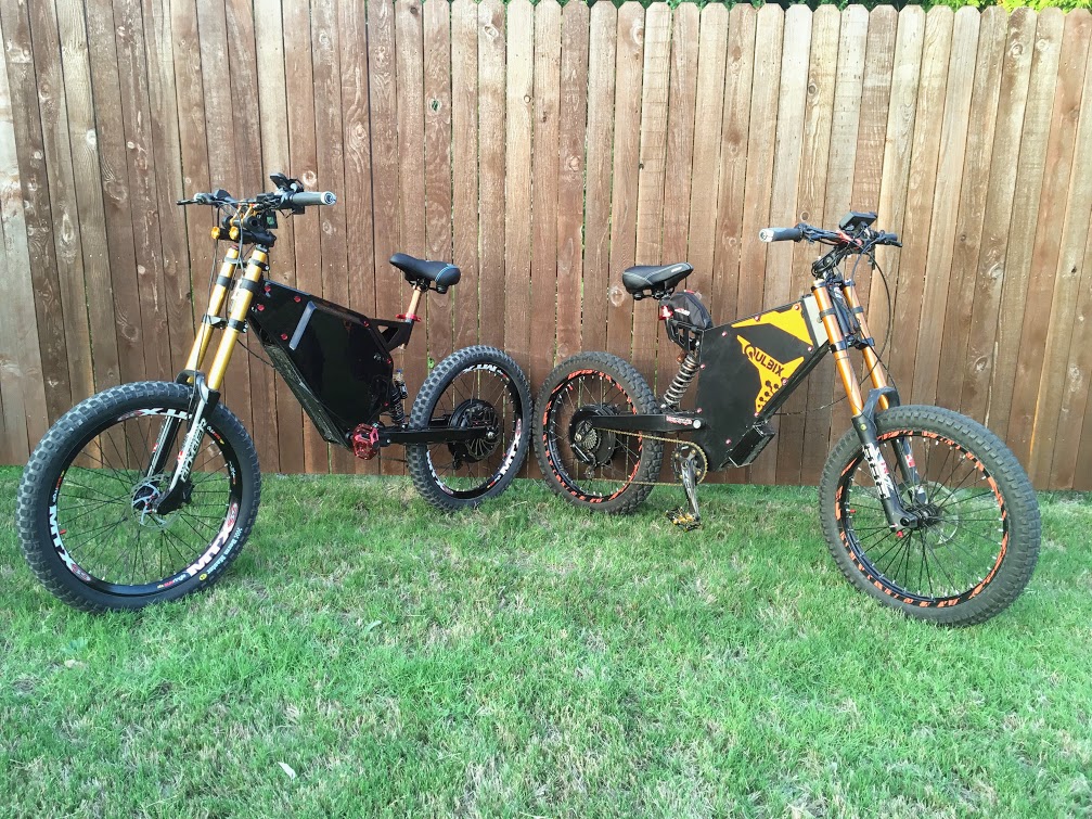

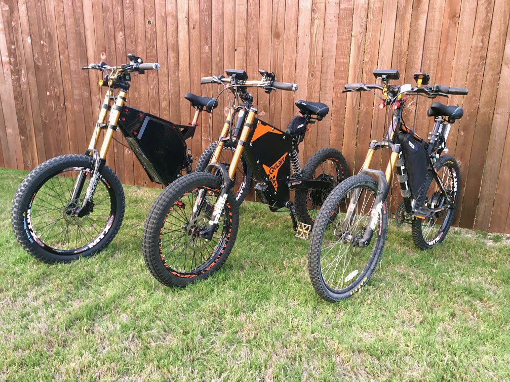

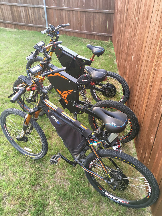

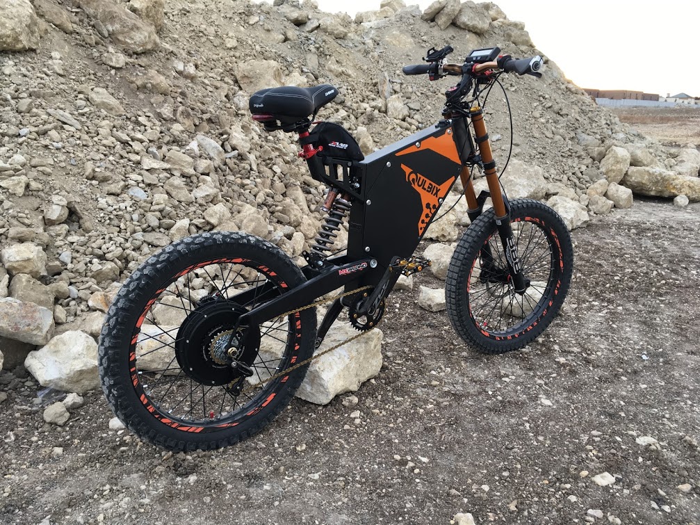

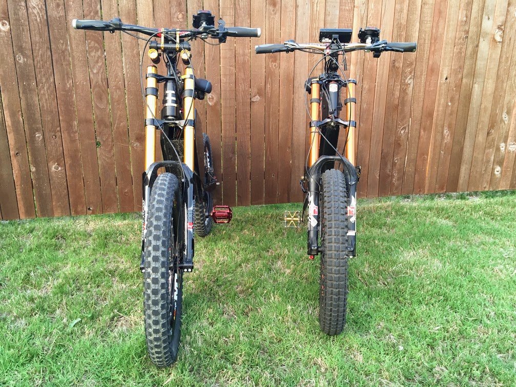

I did my best to outline the build story behind these bikes so sorry if is long and boring, if you just want to see the pretty pictures, skip down to the bottom. I already have a lot of this queued up but I still have more to add when I get time.
The purpose of this is for anyone wanting to build a bike to see some of the differences between the bike I’ve had for the last few years and the two new ones I built, one high end and one low end but surprisingly both came out with comparable results, so the question is, is it worth spending the extra money on everything to get the best? Read on down and find out.
I have been adding to this on and off for a few months now and I am really not done with my testing results and final opinions between the 3 because they each have their pros and cons but If I don’t go ahead and start posting what I have, I will get busy off on one my other projects and never get back around to this, so here is what I have so far...

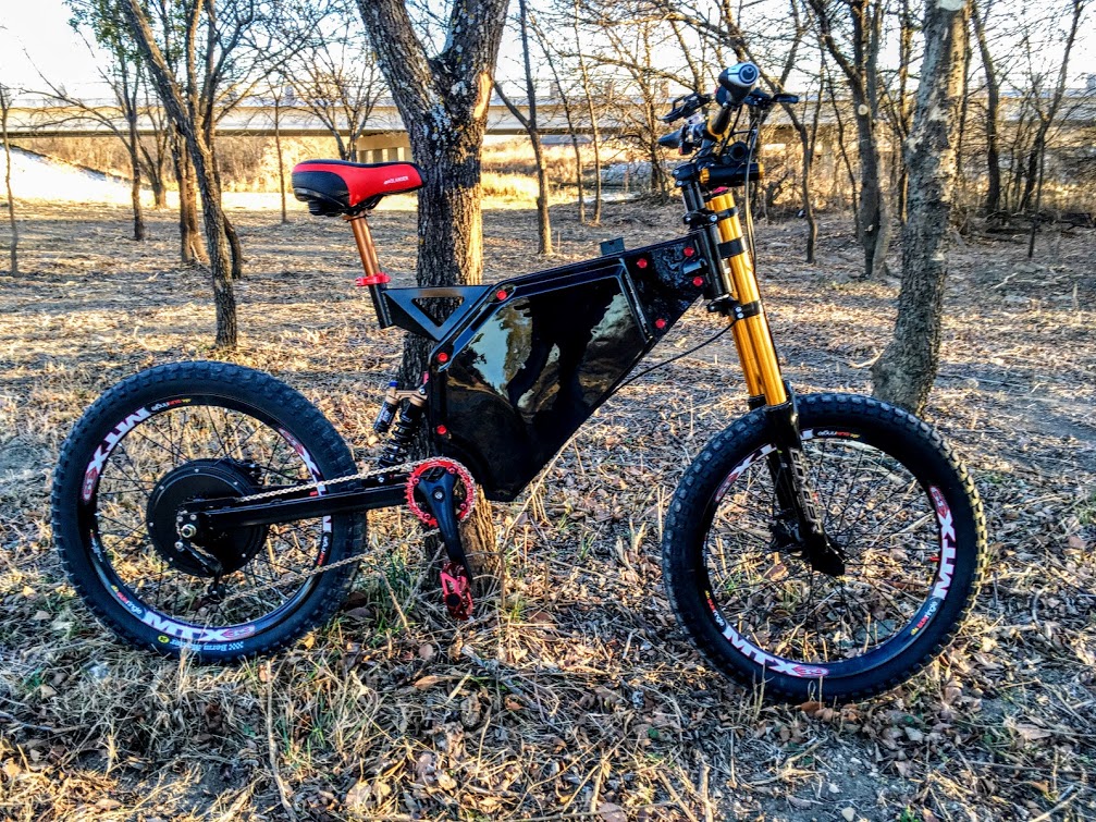

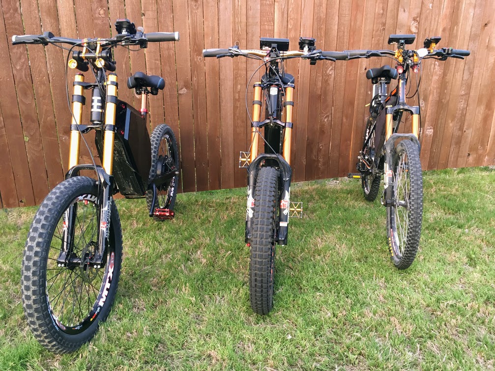

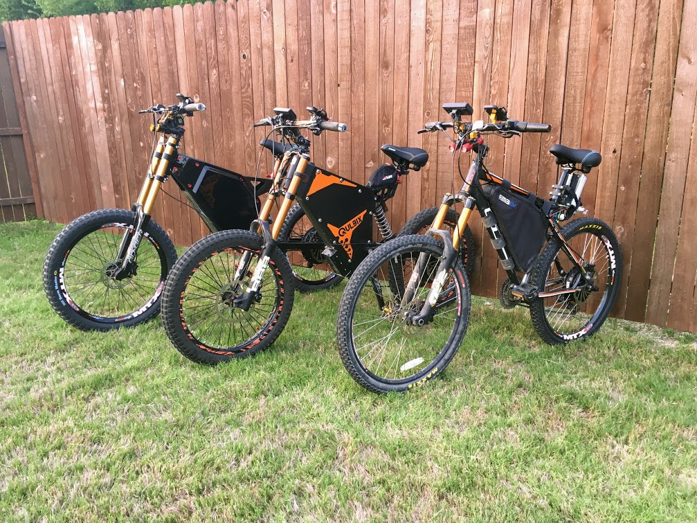

The 2 on the left are the new “budget” builds and the one on the right is the older bike I have had now for a few years.
Actually, they were both fairly expensive if you’re on a budget, but I have been wanting a "Stealth" type bike ever since I built my first bike in 2014 so that is where I will start the story but it should be called expensive, even more expensive and really, really expensive.

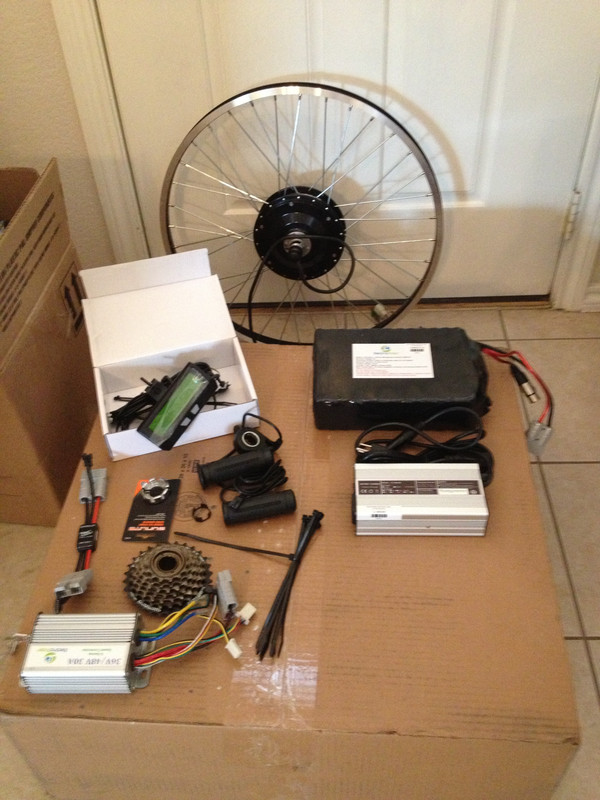

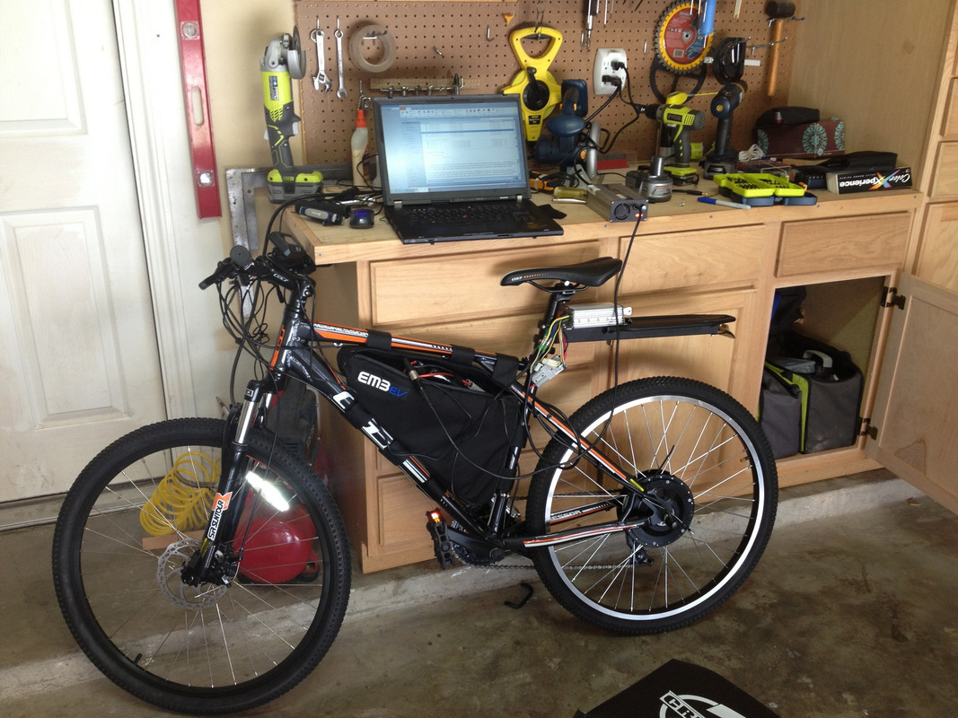

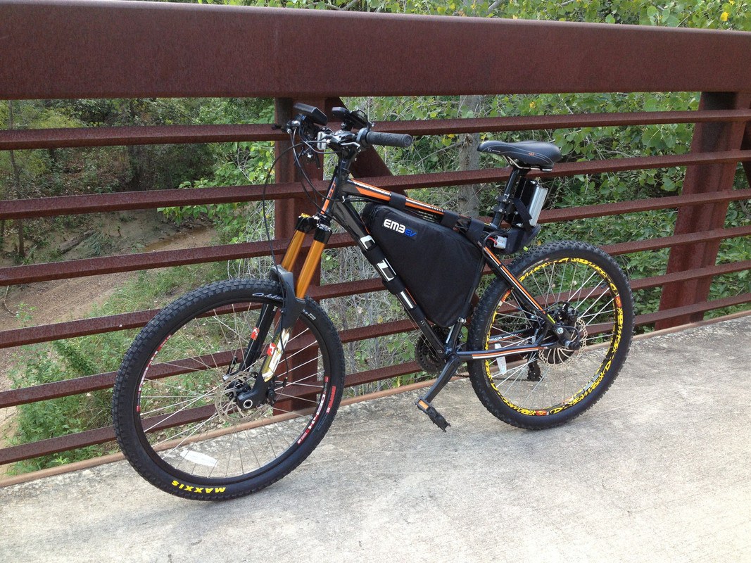

After much looking around and still not knowing much about what I was doing I decided to start with a GT Aggressor. I chose this bike because of the way the frame was built. It had a strong well-built frame along with a large opening for the battery pack, front and rear disc brakes and some decent size dropouts for a motor but no rear shock. I really wanted the full suspension, but that combination just does not exist for less than 250.00 that is. Most of the bikes with any type of rear shock system and you lose the battery space in the frame.
I ordered my first kit from a local shop here in Texas called Electric Rider. They were selling a 1500 Watt BMC hub motor kit with a 52V 20Amp hour battery for about 1200.00 (I think) which was way more than I anticipated spending but this guy was with in a 100 miles so I figured if something went wrong or he ripped me off I could always drive down there and confront them. The battery was most of the cost, and I way over ordered on this part. I could have done with half the size and less quality pack and still had a decent bike but I wanted range and range I did get when it was completed. So first word of advise. Do your math.

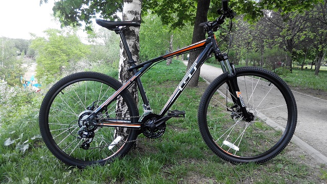

This bike went through several iterations after I first got it on the road. It was the most fun I had ever had but I really didn't like the way it looked and the front Suntour forks on those were absolutely crap after more endless nights on net I ran across a pair of Marzocchi forks on Ebay for 350.00 which was a steal. After that mod, I fabricated a new bracket for the controller and got it off the book rack, added a handlebar riser, a new seat, my own version of head lights which work pretty good BTW and finally came up with the product I have been riding for the past few years.
Used GT Agressor Bike 175.00
BMC/MAC V4 6T motor kit with the following 1200.00
1500 watt motor controller in a Alex DM32 rim
52V 20Amp lithium manganese battery pack with a 50amp rating (this was way over kill)
Cycle Analyst v3
Cr55 Marzocchi forks 350.00
DT 430 from rim with with 20mm hub Maxxis 2.2 Holly Roller 125.00
Rear Alex dm32 (included with kit) with Maxxis 2.3 Holly Roller 35.00
Plus, over the years I added a new seat, riser bar, pedals misc etc…
Top speed 31MPH on a fresh charge 28 average
Range 55 miles mostly city streets and trails no peddle
Avg Wh/Mi - Best case 13-14, Avg 15-18, Peddle to the Meddle 23
Total Price in all about 1600.00 in 2014-2015
Torque was phenomenal on this build, anything past half throttle at take-off and you were going to flip the bike. even still at 5-7mph rolling it would pull a wheelie and try to flip if you went WOT
I rode this bike all over the Dallas Fort Worth Metroplex for 1800 miles until the planetary clutch gears finally gave out in the MAC which I did replace and get back on the road but it was time to start looking for the next bike. I had waited long enough.

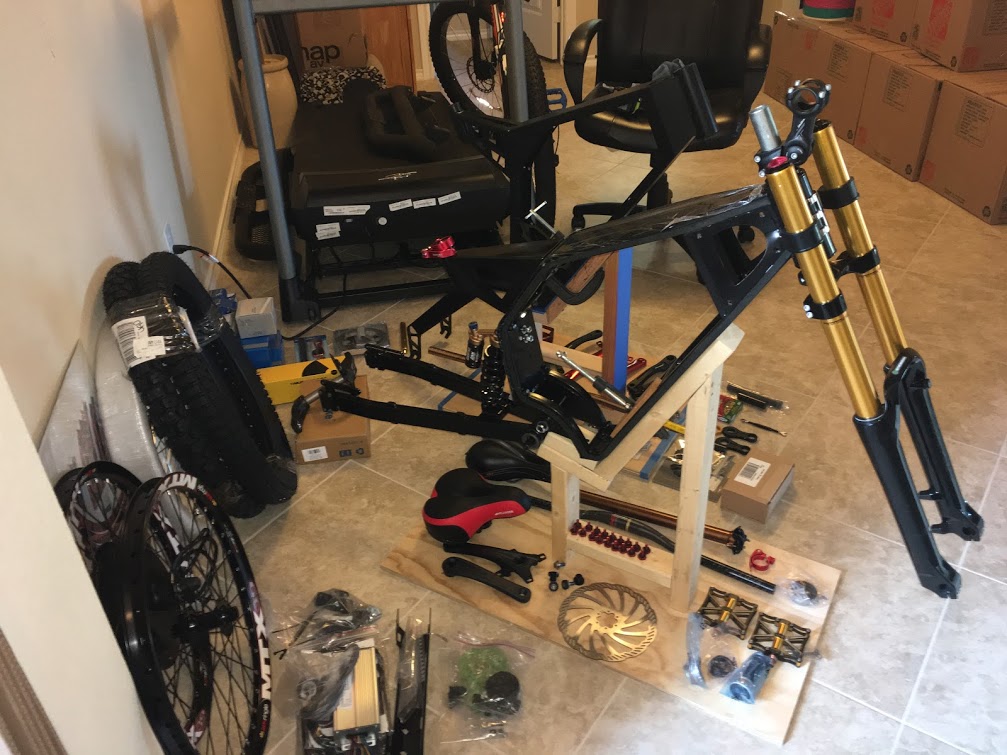

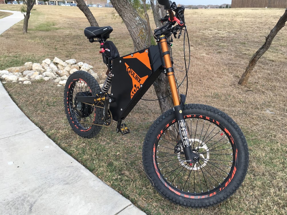

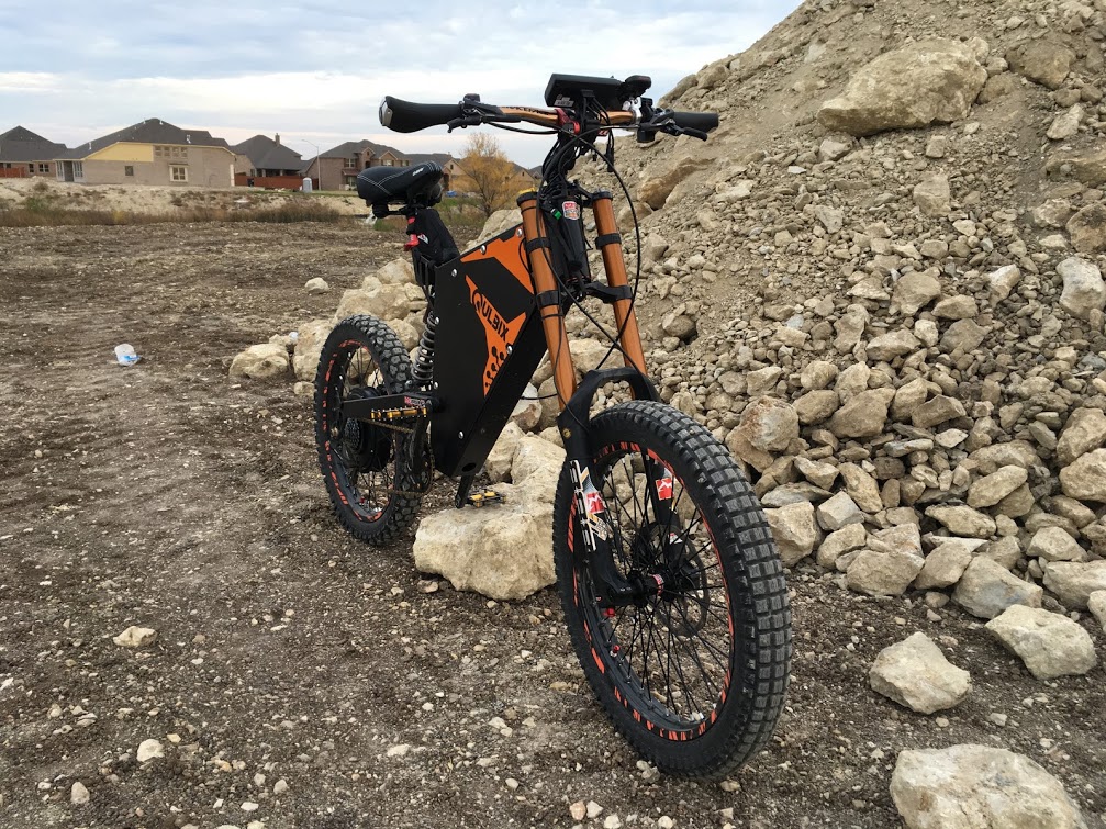

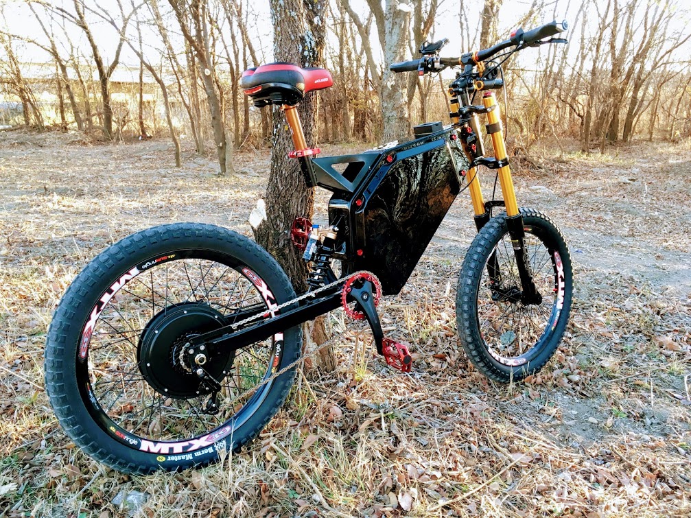

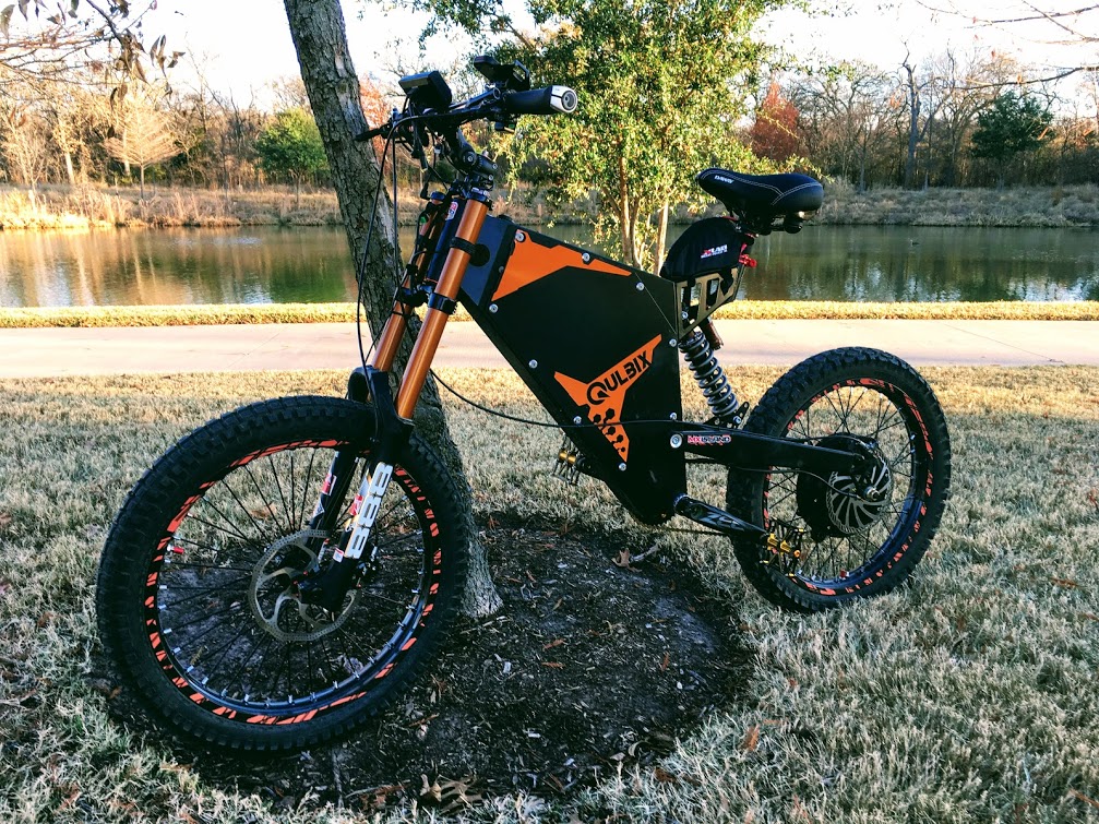

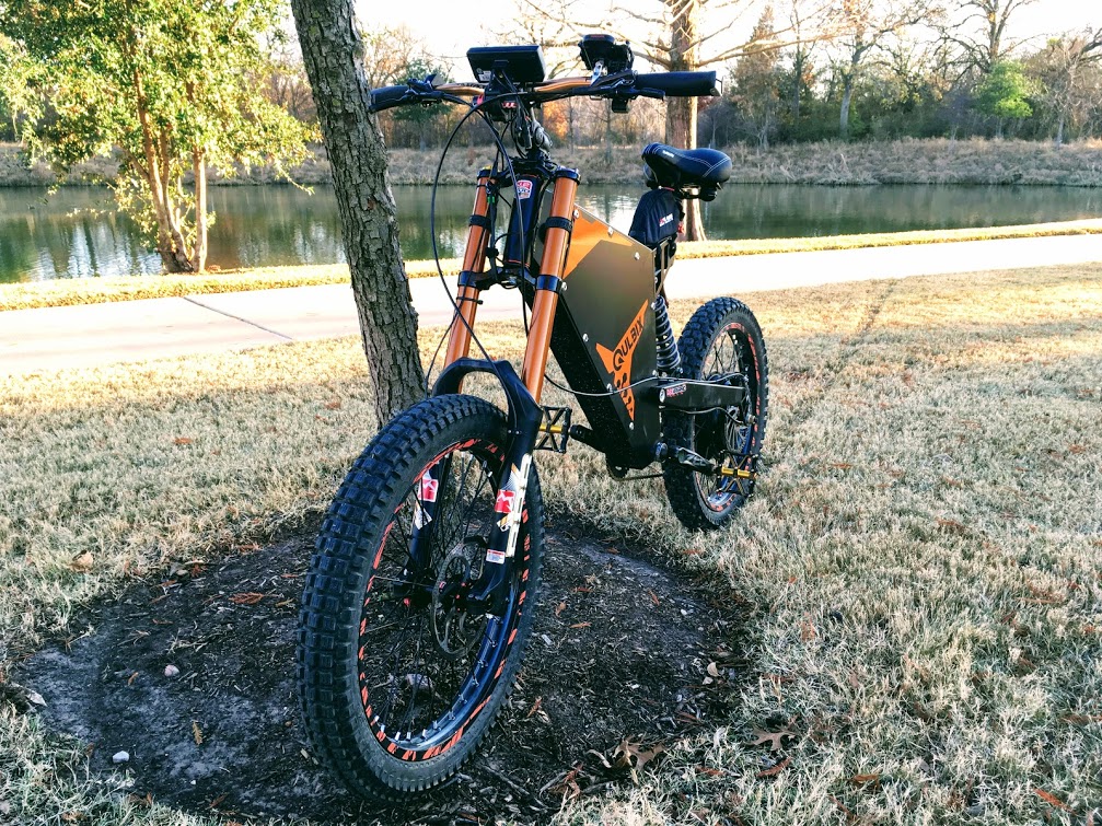

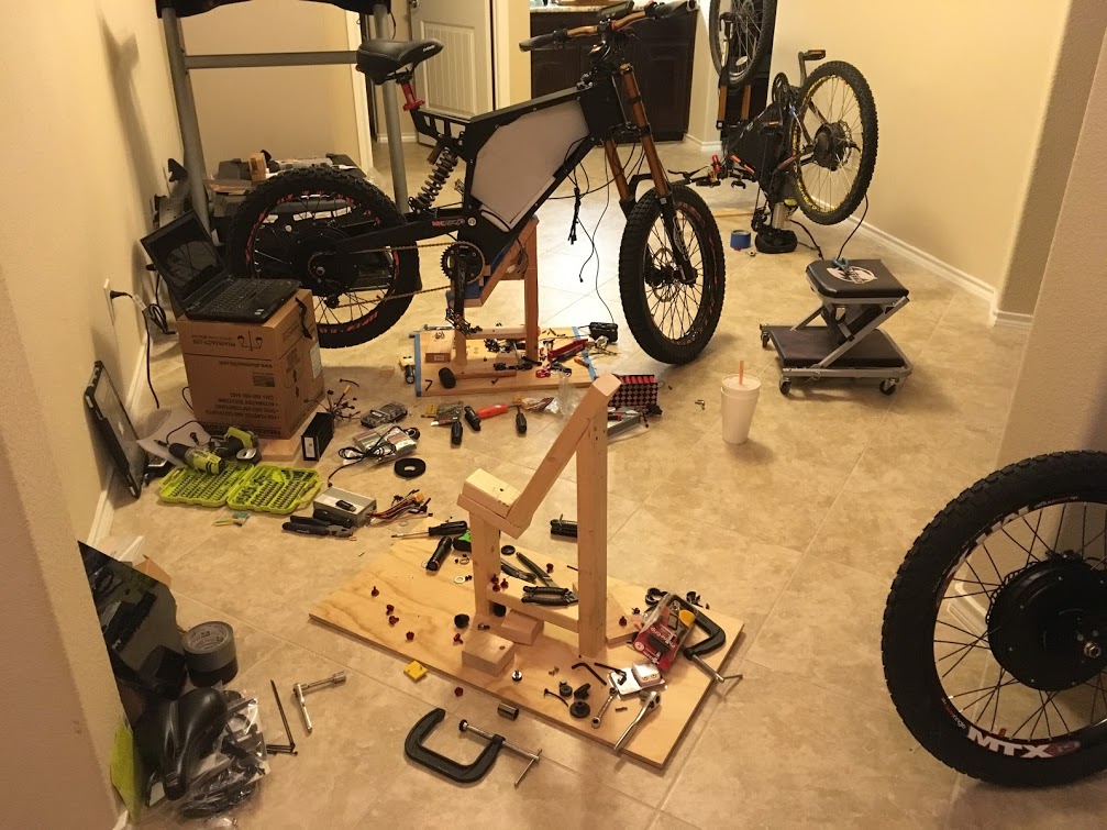

After spending 6 months on the internet getting caught up on all the latest in ebike tech, It came down to two reasonable build candidates. The Qulbix 76r and the EEB Enduro (not sure that’s the correct name but I have seen it referenced a few times so for the purpose of this article that’s what I will call it) Both got my attention and both were reasonably priced however the 76r was clearly going to be the more expensive frame and after many nights of deliberation I had finally decided to go with the EEB and then almost one day later one of my friends showed up at random to catch up with things and we started talking bikes and after I showed him everything and he now decides he wants one too and that was enough to push me the other direction because he didn't want to spend very much money on his and I wanted to make the jump to the MXUS 3000 and 72 Volt battery so I made him a deal on my BMC/MAC and 52V battery for the EEB as my original plan to save money was to use the motor and battery pack out of my last build to get the new bike operational but now that he wanted a more in-expensive bike, I made him a deal on the older battery pack and BMC motor and ordered the q76r frame the next day.
So from this point forward I am outlining the research and purchases of parts for 2 bikes I am building simultaneously
When I ordered the frame, it was on sale however all the prices are listed in Euro which is misleading at first glance and then I had to have black and I thought I needed the controller shield and other than the rear shock bushings that is all I bought from Qulbix. All in all about 1100.00USD once I got out the door with shipping which was about 400 more than I had planned on spending.
So It was at this point I decided to say screw it and order all the rest of the parts I wanted instead of the ones I had planned on getting to save money. If I was going to spend a 1000.00 bucks on the frame I might as well spend the rest and get what I want although when I placed the order the next day at EM3EV for 350.00 flat on the EEB frame I started wondering if I had made the right decision.

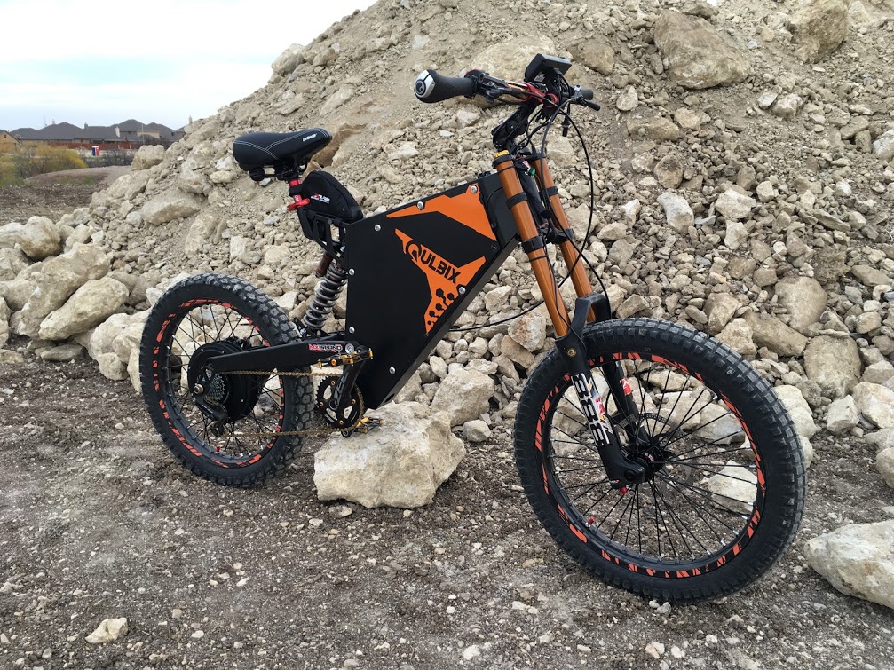

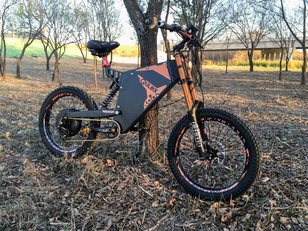

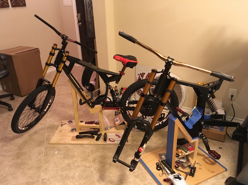

So first order were at

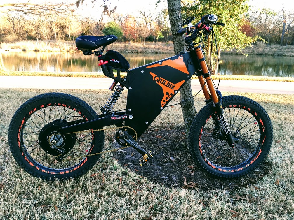

Qulbix 76r Frame and shock bushing – Qulbix Direct - 850.00 + 105.00 in shipping + 40.00 freakin dollars to use paypal
EBE Enduro Frame – Em3Ev - 350.00 for the EEB + 75.00 shipped.

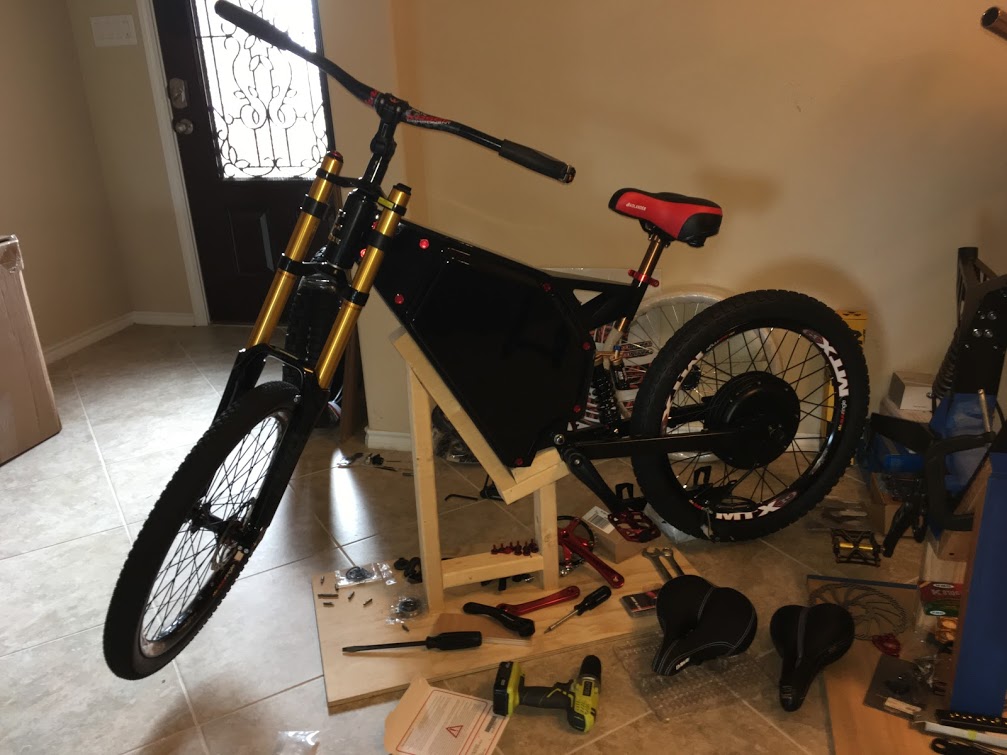

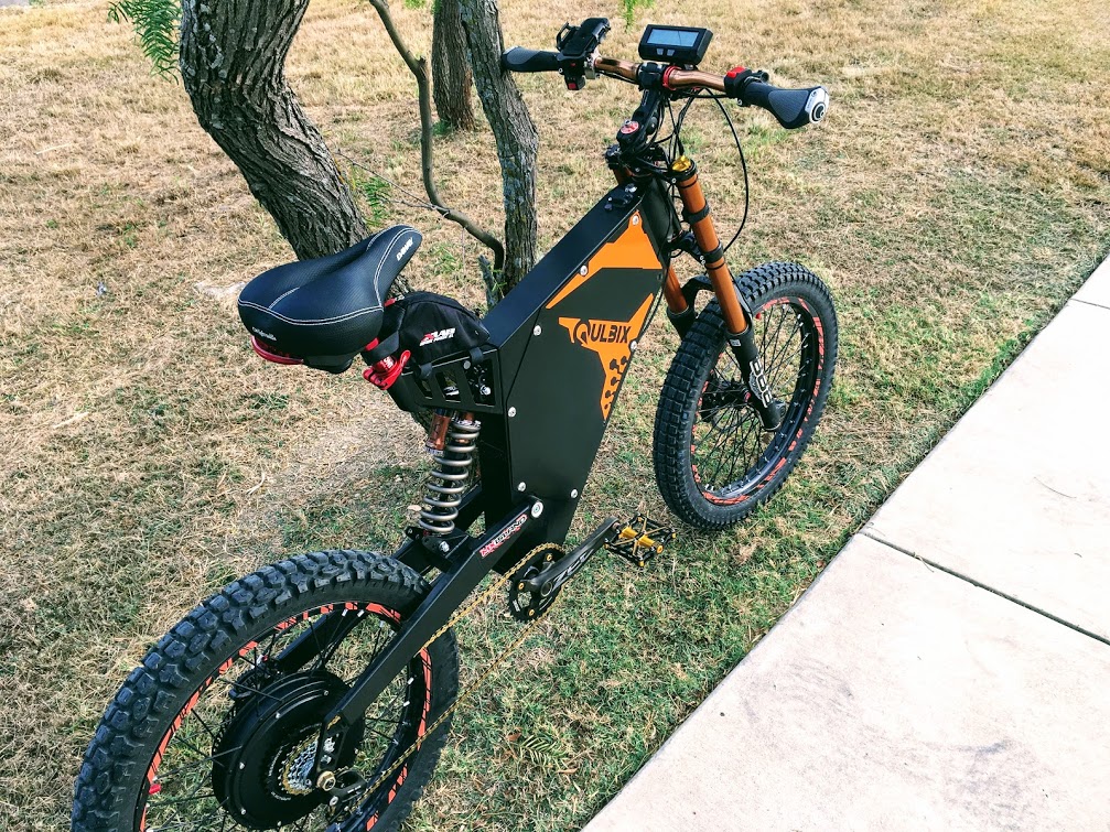

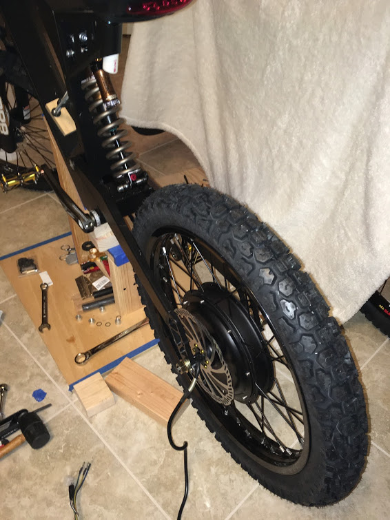

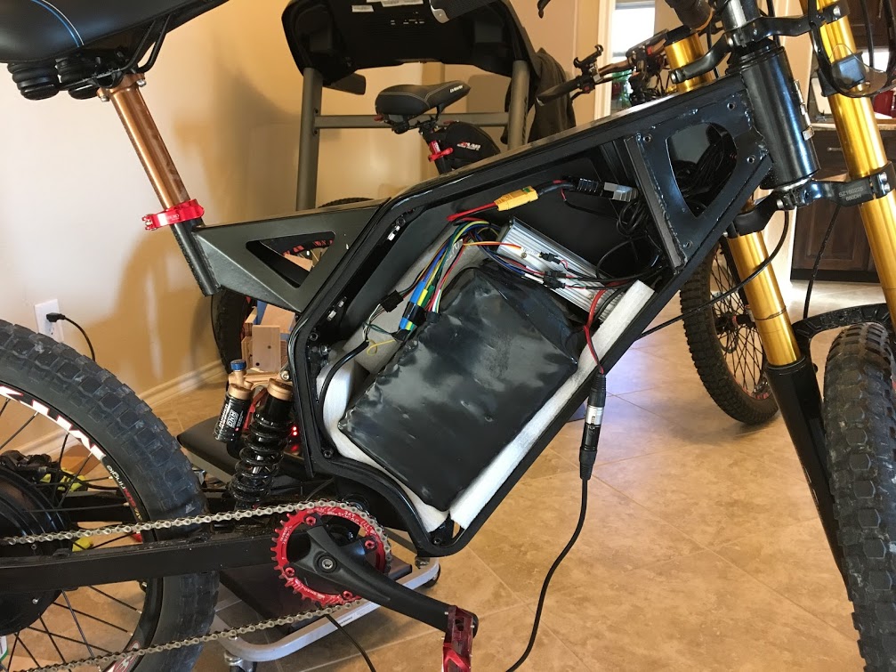

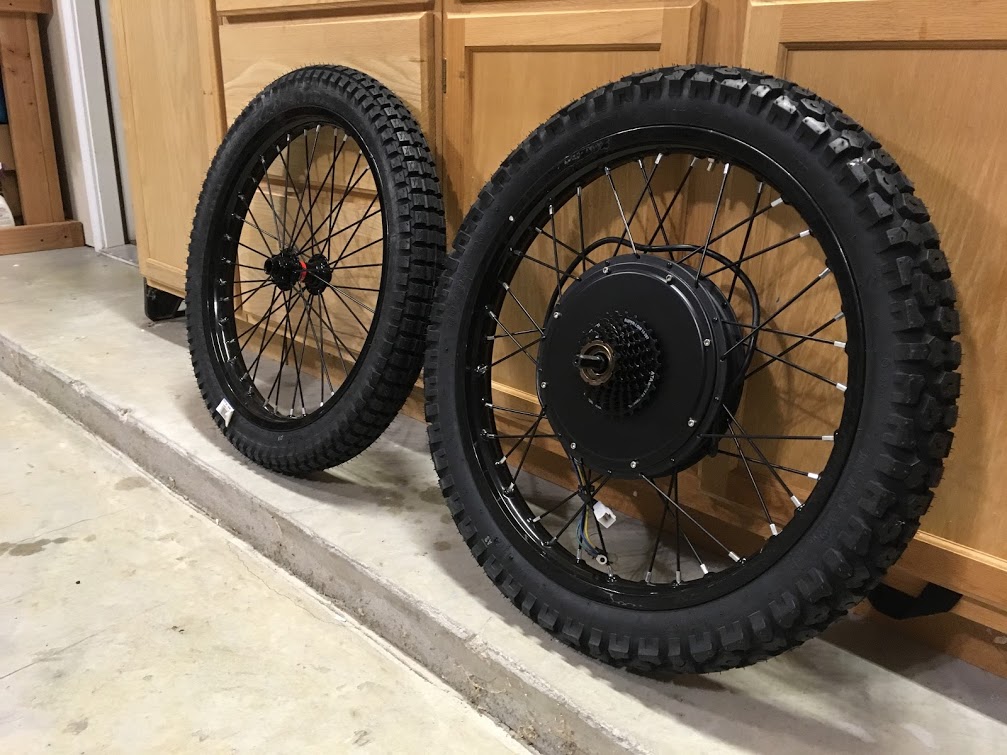

Next was the motor. After much debate back and forth and literally hundreds of hours reading articles on motors I finally decided on the 1500Watt DD Edge Motor from Electric Race Technologies out of California. I originally wanted the MXUS 3000 but I ended up choosing this motor mainly for weight and power savings. Many articles clearly demonstrated that it was capable of much much more than 1500watt and had no problem hitting 40mph+ on 48 volts. And to me after much reading the sweet spot on the motor, battery and controller is 60v, when you make the jump above that, everything else is heavier and gets more expensive and provided little power that I would never probably use. But then again, it’s my bike and other may have other uses they need the extra power for.

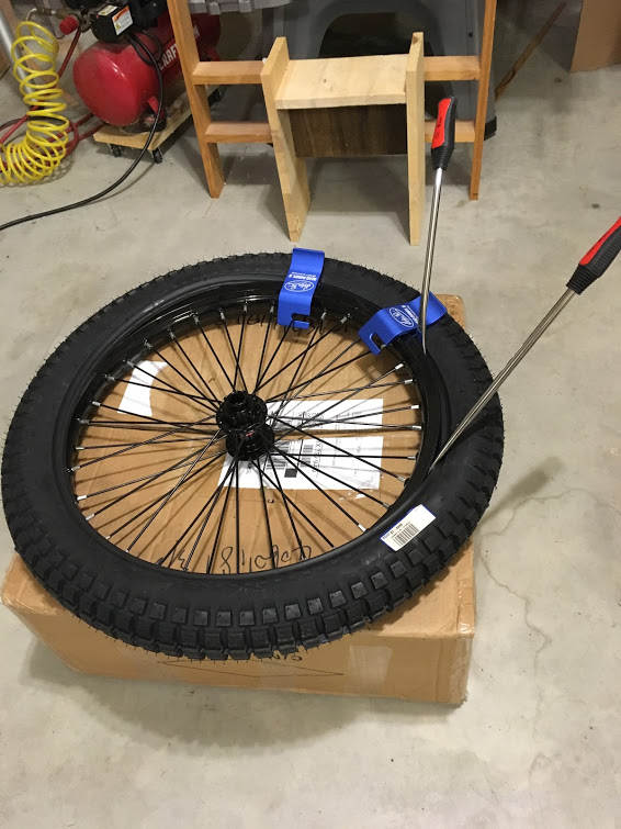

I went on ahead and had the motor laced in 19” moto rim. A 19” moto rim is actually about a 24inch bicycle rim and depending on what tire you put on it can wind up even being more. But I did photoshop mock ups and to me 24” is the perfect size for the Q76r frame. It’s not too small and it’s not too big.

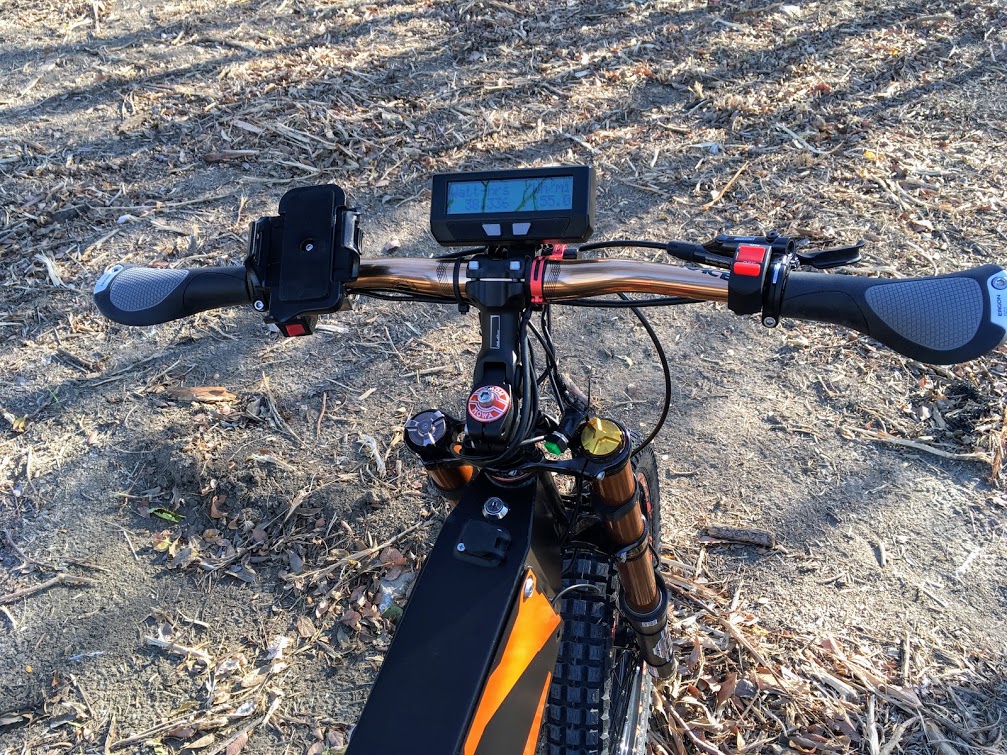

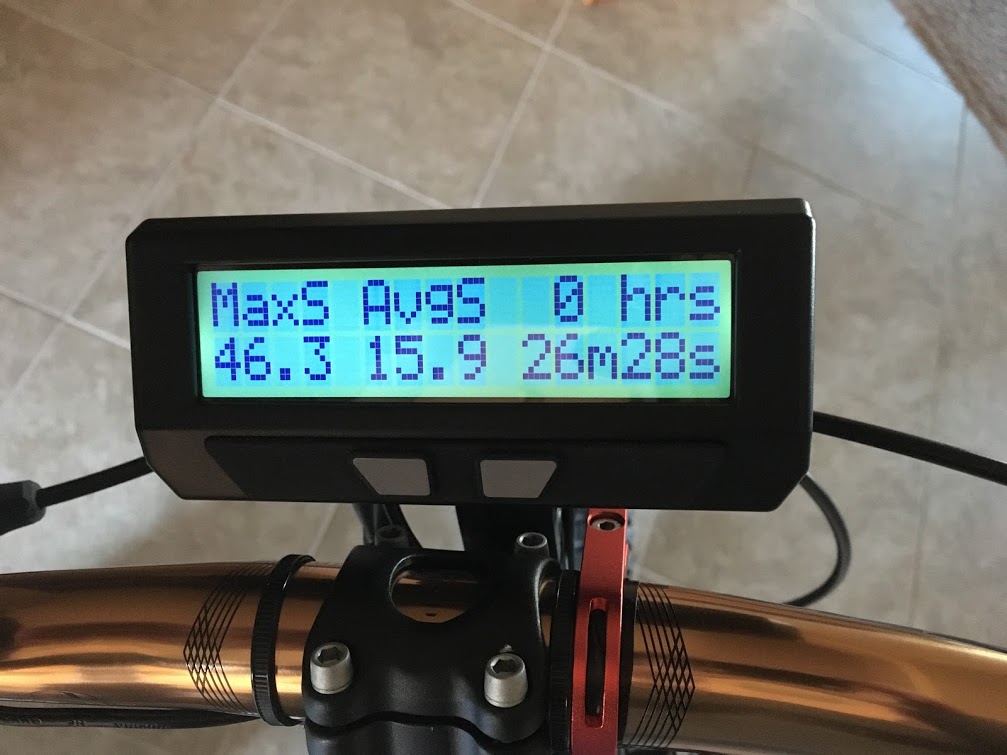

For the Controller I used a beefed up 12 FET Sinewave Controller with the CA Interface I also purchased from ERT and at the same time I was looking for alternate controller I by chance ran across this listing in Aliexpress for similar 1500watt DD EDGE look alike motor from CycleBike.
For those of you not familiar with the EDGE motor goggle it or look for other posts here on ES. It is a very well built beefy motor with an Aluminum stator and very similar to the same 1500w that leafbike sales that seem to have become popular. They were actually my 2nd choice for motor if I could not get the EDGE. I am not sure why but the EDGE motor seems to be only sold in 2 places LABIKE and ERT and LABIKE was out of Stock and I believe still is however with NCycleBike they also have the option for lacing with the order which at the time was very important for me but since have learned how to lace myself.
So I went on head and gave this company a try. The price was right and they had 25 5 Star rating So if you're looking for a laced motor you might try these people. They sale 24, 26, 28, 700CC and 29 inch laced and they use the MTX39 rims which am a big fan of. They also have a moto wheel option and bunch of other ebike parts. You can read on down further for the ride review but this turned out to be a great motor and as far as I can tell from riding is equal to the EDGE in every way and for all I know it may be the EDGE under a different name.

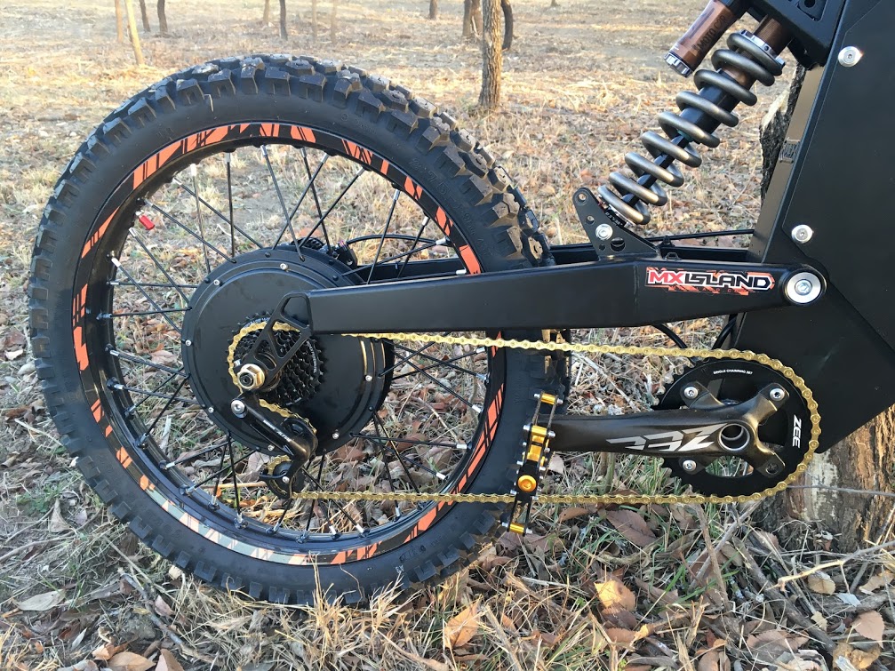

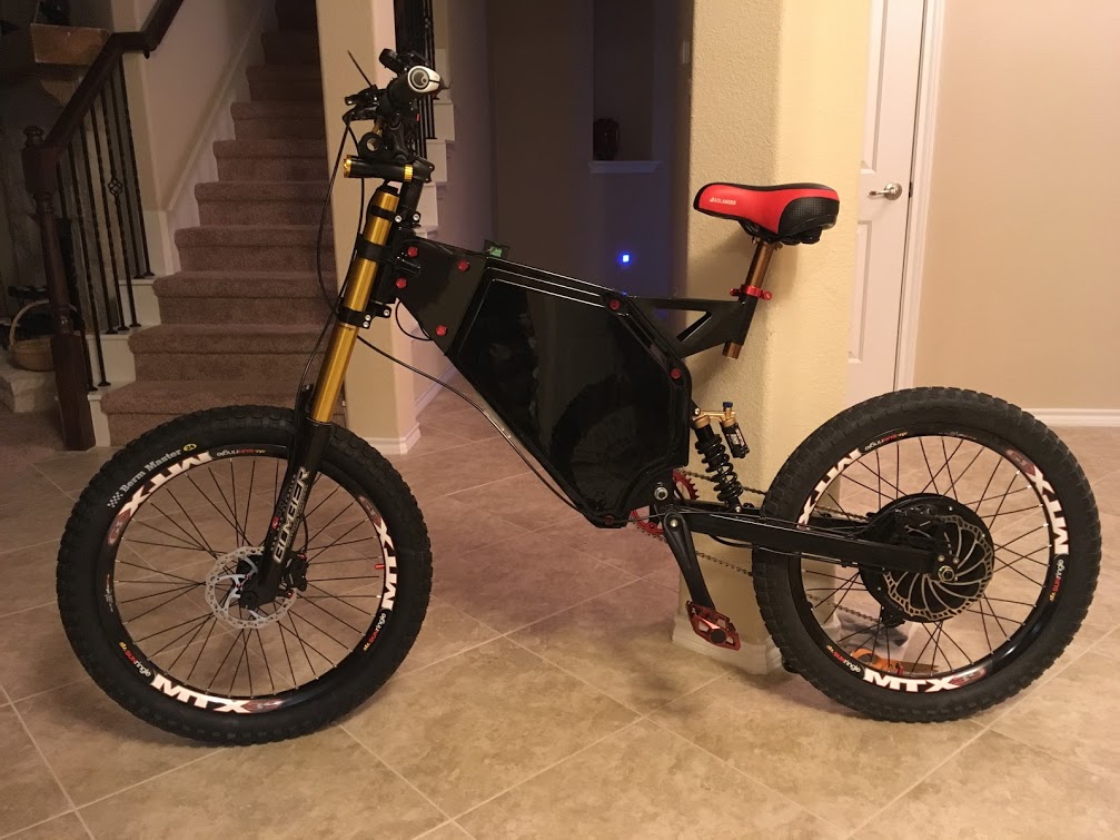

Electric Race Technologies (ERT) 1500 watt DD EDGE Hub motor laced to a 19 inch moto rim with beefed up 60V 12 FET controller plus misc parts throttle etc… 617.00 (Shipping 50.00)
NCyclebike (Aliexpress) 1500 watt DD Hub motor laced to a 24 inch MTX39 rim with controller and misc parts throttle etc … 385.00 (free shipping)
Here is the link to the hub motor from Ncyclebike if anyone is interested. I give them 5 stars. Service was prompt, shipping was in 10 days to Texas and the packing looked CNC cut to match the parts.
https://www.aliexpress.com/store/product/Front-or-rear-motor-65km-h-48v-1500w-Electric-bike-conversion-kit-for-20-24-26/2214086_32684555943.html?spm=2114.12010612.0.0.63a92c25dx6NpF
Next up was the front wheel and as it so happens Ncyclebike also laces 24inch inch front rims in the MTX39 on a 20MM hub which is the way I was going with my builds. So I ordered the front rim laced from them as well with the back rim and motor.
But the front rim on the other bike needed to be a moto rim so I kept searching and then google turned up a link within ERT website that had the front 19 inch moto rim in a 20mm hub that didn’t show up on the web page when I ordered the motor the day before so I went on head and clicked to buy hoping they weren’t out of stock or something and that is why the store link was missing.
19 Inch front moto rim with a 20mm hub - Electric Race Technologies (ERT) – 175.00 + 22 for shipping
24 Inch bicycle MTX39 bicycle rim with a 20mm hub – NcycleBike (Aliexpress) - 124.00 – Free Shipping

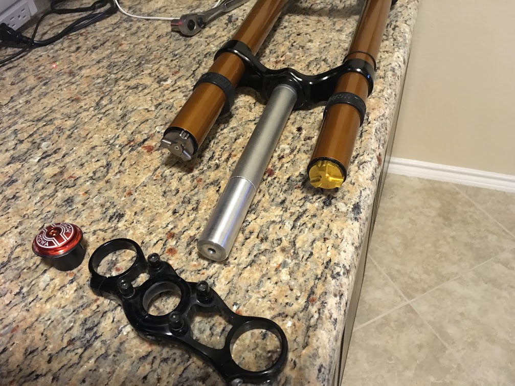

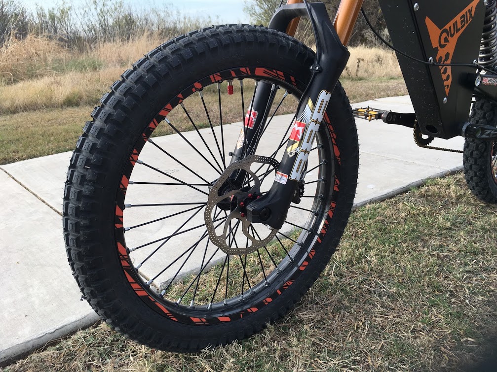

For the forks I got really lucky, I have a bucket list of items I search for on ebay every week and som bitch I looked and someone had a pair of 2014 Marzocchi 888 bombers for sale used in perfect condition and I could not hit buy fast enough however there was something I didn’t think about when doing that. It was clear to me that these were going on 76r which left me still searching for a set for the EEB. I really didn’t want to pay 300-600+ or even 1500.00 for a set of Fox40’s when I was trying to keep the price down but this was an important item and affected not only the ride but the look and stance of the bike and in the end I decided to go ahead and take the bait and buy a pair of the Marzocchi 888 knockoff I kept seeing on Aliexpress and even Amazon. For those of you who have not seen them. Google Zoom 680 DH fork. They were only 125.00 so I figured if they exploded I would eat the cost and buy something else. The curiosity was killing me on how these performed. So I looked through the different vendors and finally picked one that looked reputable and bought it.
Anything I buy on AliExpress is just like gambling in Vegas. I prepare myself for just throwing away that money until I see it work and then I get happy.

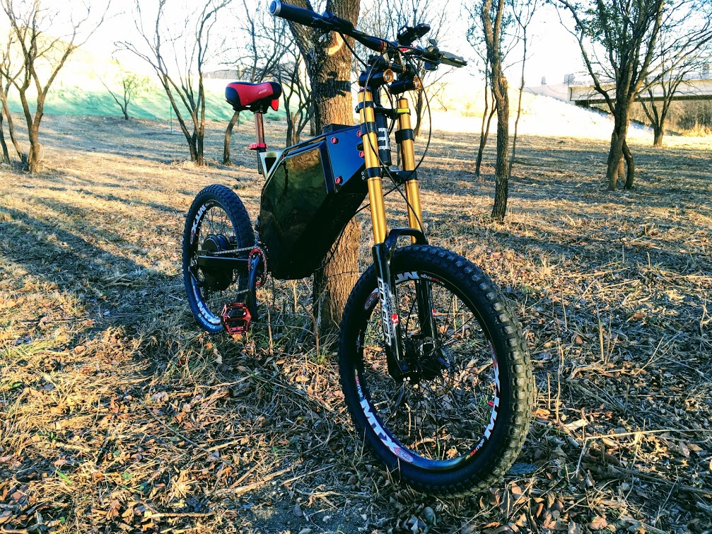

Q76- 2014 Marzocchi 888 Forks – ebay – 450.00 – free shipping
EEB - Zoom 680 DH Forks – Aliexpress – 125.00 + 50.00 shipping
Brakes – I didn’t do much research here, I wanted hydraulic brakes with ebrake cutoff built in but there was just not that many choices on that so I went with the standard Shimano setup but again I wanted to see the difference in an 80 dollar set and a 180 dollar set when testing the bikes
Q76 - Shimano Deore XT M8000 Hydraulic Disk Brake Front & Rear 1000mm/1600mm – Amazon – 189.00
EEB - Shimano BR-BL-M355 Hydraulic Disc Bike Bicycle Brake Set Front & Rear – Amazon – 82.95

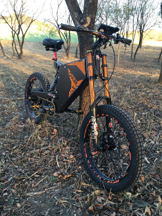

Rear Shock. Again, Continual ebay searches each day and I came across these. I think that Moto Cr2 lists for like 450.00 so this was a steal and I should have bought more because these no longer seem to be available and the one I have rides like a dream.
Q76 - NEW 2015 Marzocchi Moto C2R Prog Boost PB Coil Shock 267x89 10.5 x 3.5 - EBAY - 169.00
Q76 - J&L Titanium/Ti Coil Spring/Rear Shock for RockShox Vivid,Marzocchi MOTO C2R,DNM [350lbs* 3.5"] - EBAY – 108.00
EEB - DNM Mountain Downhill Bike Rear Shock 550 lbs 190mm - Amazon - 119.00
Tires for the 76r was a no brainer, I loved the way the Shinko's look and perform
Shinko 241 Dual Sport Front - Rear Tire - 2.75-19/Black wall- Amazon 35.00
Shinko 244 Dual Sport - Rear Tire - 2.75-19/Black wall- Amazon 35.00
Tires for the EEB was a little more hard to come by, I didn’t realize how few tires they make for 24" rims until I started looking but ended up finding these
Berm Master 24x3.0 - Front/Rear - Felt Bicycles - 24.00 each

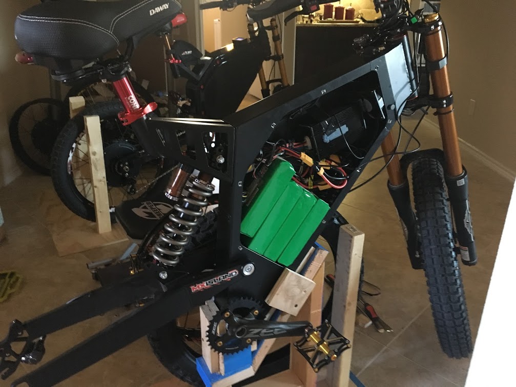

Batteries - Originally I had planned to build one bike and use the battery pack from my old bike to get it going and then I changed to building two bikes and my old battery pack went to the EEB while my plan was to build a 16s16p battery pack with the Samsung 25r batteries, I ordered the JP spot tab welder from another member here at ES and was right in the middle of cutting a good deal on a shipment of 200 25r batteries when I came across an email from HobbyKing (I am in to drones to) offering a super deal on some 16000MAh 15.2v lipo packs and an idea just hit me like a rock. Why not use these? So I popped out the tape measure and the calculator and sure enough 4 packs fit perfect in the 76r frame giving me 68v at 16 Amps in series and with a constant 10C rating on these I should be able to romp on that EDGE motor. So I switched gears and ordered 4 of those and a bunch of XT90 connectors and very fine 8-10 gauge wire off amazon. I had most of the bike parts in and those would be here in 4-5 days and the build a battery pack was probably going to take 6 weeks. And they were cheap!
76r - Qty 4 16000Mah 15.2 Multistar Lipo total 68V 16AH - 260.00
EBE - 52V 20A Cell from previous bike - 0.00
Those were the majority of the parts for both bikes and trying to sort through the rest of the receipts trying to figure out which one when where is going to take me another year so I am just going to dump the listing out. I had no plans for the bikes and changed my mind about 200 times during the course of the builds. I basically printed a bunch of photos and diagrams and pasted them all over the wall to look at everyday at my computer desk and then when a thought would strike me I would jump on line and order parts on the fly. I ended up with way more parts than I needed because of changes or compatibility fitting issues because I didn’t research enough but end most of them were not expensive parts and now I have more to start another bike.
I am going to post what I was able to find as far as the parts lists I ordered to give the newbies an idea of just how many little things there are when building your own bike. I went though the order process for weeks and it seemed like every night while laying in bed I would think of yet one more part I still needed.
Parts List

The Qulbix 76r frame was the first part I ordered and the 2nd to last part I received. Total time from factory to Texas, USA was almost 2 months but I selected to have the frame painted black they noted that was a custom order. The 2nd part I ordered was the EDGE Hub motor controller kit laced in the 19" moto rim from ERT and I ended up having to threaten him with a paypal investigation if he didn’t send me my stuff. For weeks he kept saying: yep it's on the bench, going out today. I am not really sure what Alan Hu has going on over there at ERT but it's not running his company that is for sure.
So Between the time I ordered the frame and rear motor for the 76r, ALL of the other parts came in for the EEB. The EEB frame from Em3ev was here in 5 days from China, as well as the front and rear rims and motor for the EEB which were from Ncyclebike also somewhere in china. So I give them an A+ for the fasted deliver only beating out Amazon. Their parts were also the best packed.
The EEB Frame and motor, tires and rims all came in boxes that were like CNC cut for those parts and very heavy duty packing I was very impressed. The Qulbix gram came in a big random box with a bunch of stuffing from what looked like 10 different other orders all just crammed in there to keep parts from moving around and the same went for the rims and motor form ERT. The packing was used packing already shipped else ware, the parts were bulging out of the box split in several areas but luckily all the parts made it here un-damaged.
So I started the exact opposite of where I wanted to but all of the parts for the EEB were on the floor and anticipation was just about killing me so I started on the EEB first and to my surprise had it mostly put together and working in one hard weekend Fri night -Sun night
Although there were no instructions, the EEB frame and parts went together surprisingly well and after I took it back apart a few times to turn a few parts over or put them in forwards instead of backwards, I had a rolling bike in 2 days’ worth of weekend work. At this time, I still had the stock Ncycle controller and while all the rest of the parts from NCycle looked built fairly well, I could tell the controller was a simple basic 48volt controller available most anywhere for 30-40 bucks and would not handle the power I had planned on putting into it but I didn’t have the batteries yet either so I opted to pull the 52V 20A pack out of my other older bike and see if everything worked.
This was day one freshly completed EEB bike. All in all the combination of the cheap controller and 52v pack didn’t operate that bad. It did not have the takeoff speed I was used to but would get up to 30-35mph fairly quickly. I made a test run around the block and then pulled it back in to check the heat on all the wires and make sure I was not over amping anything. All seemed good so I went for 10 mile ride which lasted about 1 mile before I realized the steering was off, the brakes were off and one of the peddles fell completely off. So after returning back to the house and tightening and adjusting everything plus realizing that most of the nuts and bolts on the whole bike were only finger tight when I left. Moral of that story is: Don’t get excited and forget to finish the bike and double check everything.
At this point the EEB was mostly operational and I took it on several rides over the next week without a hitch. The other beefed up 60V controller I ordered for the EEB to replace the cheap one showed up and I wired it in. Note to builders: make sure your order a boxload of XT90 connectors, the heavy duty 4mm bullet connectors, a misc box kit with all the pins and connectors for JST type plugs 2pin through 8pin and all the necessary 10guage down to 22 guage wire for interfacing all the different interfaces. You will need them.
Almost every controller, motor, battery part, throttle, the CA etc… ALL had the wrong ends on them requiring me to change all of them out to be compatible. Be aware of that and save yourself some time by pre-ordering a box of assorted jst crimpon connectors and a crimp tool so you can make your own ends.
To get the bike on the road, I was still short a front tire for the EEB so I had to steal one from my old bike until I finally got this one in. I made the mistake of ordering 24” rims which are the perfect size too me for a bike but finding fatter tires is a real bitch on the internet however I did finally receive this one that was on back order which looks a whole lot better and yes I hate the red seat. I was going for a color theme and thought that would look nice but I later replaced that as well too.
Over the next few weeks I rode the EEB all over the place and for just throwing the bike together they way I did, it actually rode fairly nice however the controller that came with the 1500 watt DD kit just was not going to cut it. It had plenty of top end but absolutely no power for take off compared to my old MAC motor I was used to. I figured this was mostly dur to the fact that the controller was only rated for 30amps and to be honest it wasn’t that much bigger than a couple of packs of smokes taped together but the beefed up programmable 60V 60AMP 4110 KB controller from westcoastelectrics put some fire in this bike, now my weak link was tripping the 50amp breaker on the old battery pack from the GT Aggressor build. Still though, watching the throttle and paying attention I was able to keep away from this most of the rides and a few week later figured out how to re-program the controller so I just went in and made a config for switch setting 1 (this controller has an external 1,2,3 switch for selecting different pre-programmed settings on the fly) that limited the controller to 48 amps in switch 1 and the breaker problem went away. I still need a better batter or … If I added another 52v20amp pack in parallel I could pull 48 from each simultaneously and have a 40amp range but I really needed to put in a 60v if I had my wishes, I could tell this motor was not struggling at all with power I was running and would take way more. In all my riding I never even managed to get it past outdoor temperature.
The rest of the parts for the q76r started showing up FINALLY. I cannot believe they were the first I ordered and the last to show up by almost 6-8 weeks. I do not know what Alan over at ERT had going on but I had to go as far as to threaten him with PayPal and bank dispute to get him to ship my freakin parts. As far as I can tell he is a one man show and is never in the office. But I really wanted that EDGE motor and he was the only person that seem to have any left, but he finally shipped and I got the motor, rear wheel and front wheel.

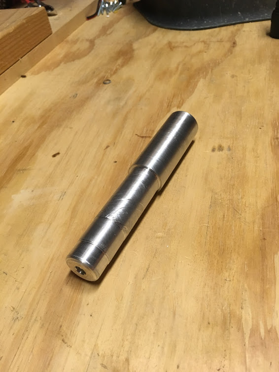

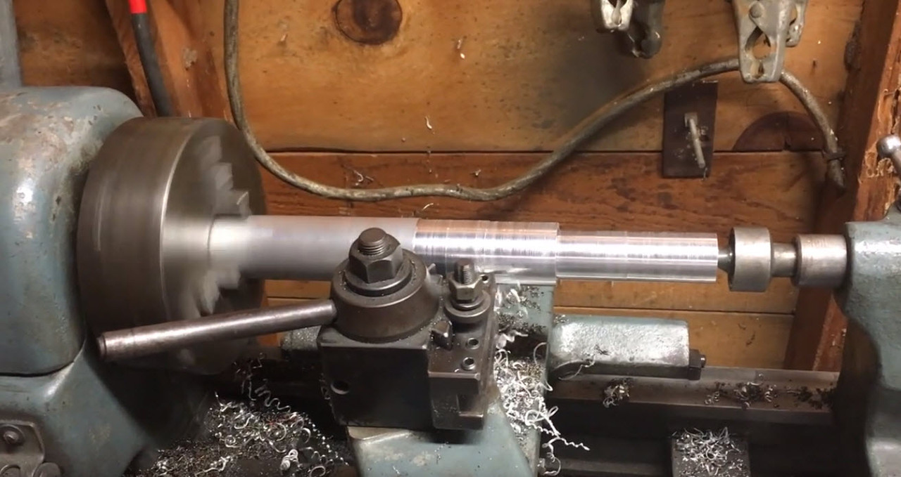

The first BIG problem I ran into was not paying attention to what I ordered. The super great deal I got on those Marzocchi 888 just came to a screaming halt when I went to mount them on the 76r and found out that the steering tube had been cut too short by the previous owner to fit in the q76r frame.
I called around for days looking for someone to fix this and did get one hit out of Germany from a shop that quoted 250.00 and I had to send them the forks and it might be 3-4 months for return so I put my thinking hat on and came up with this grand idea.
I picked up a piece of solid stock 7075 T6 1 inch round stock aluminum and turned it down on a friend of mines lathe. I turned it until it was just snug enough to have to pound into to the old steering tube with a little force and then I backed it up by also threading the bottom with a 5/16 hole about 3 inches deep so after I pounded it in, I could install a big washer and a 5/16 bolt up through the bottom of the fork head to pull the pieces tight together and keep them that way with some red locktite.
The solution was solid and perfect and so far I have over 500 miles on them with zero movement.
These motorcycle tires were the biggest pain in the f**king ass to mount. There was a lot of cussing and bloody knuckles doing this and when I got the rear one all mounted and installed on the bike, It popped about 2am in the morning all on it’s own. So I had to do it all over again. After examination, the rubber in the tube was rotting from I guess sitting on the shelve to long and it split at the seam half way around the inside of the tire and I of course bought a back up but after seeing what that one did, I didn’t want to install the spare either and have that one pop doing 40 down the road so off I went to the cycle chop looking for tire tube for a YZ125 TTL.
Again, I still have not even got to the battery making part yet, so I stole the battery pack out of the EEB that I had stole out of the old Aggressor.
The old batter had a old style Anderson connector so I made a adapter cable from Anderson to XT90
For the controller connectors I used XT90 connectors and 10 gauge fine strand silicone wire and a lot of solder.
The q76r frame is what it states. 76mm wide and that is just enough to get a 18650 in there sideways with a little room to spare on each end for wiring so here is what the 52V20amp pack looks like in the frame. That pack has a 126 batteries in it so I figure I can get around 300 total if needed when I make my battery.
The EEB frame is almost the same size but double the width at 140mm so you could theoretically put I guess up to 600 batteries in that frame but for now, switching the battery back and forth will have to do.
I researched several batteries, but I want one that will do 75 amp continuous discharge and most do not go that high that are for sale on the retail sites. This current one has a 50amp digital breaker and I trip it constantly if I am not careful on full acceleration.
This here photo was day one complete before 1st ride.
This bike far exceeded my expectations as riding this it is like a dream. It feels solid, stable,no road vibration and I lucked out with the rear shock ordering a 375lb spring as it sucks up the dips and bumps with ease.
The rear shock it hit or miss for me. I ordered a DNM Burner 550lb for the EEB and it is way too soft. Just sitting on the bike sags it 4-5 inches and dips almost bottom it out. Yet the 375 JL Titanium I put on the 76r sits firm and does not sag until you hit a good dip. So either they are lying about the numbers or the whole fulcrum leverage thing is coming in to play here and creating that much of a difference. The 888’s I got off eBay work perfect. I was afraid they would be bad or something but setup on both and the weight makes this bike handle and feel like a real motorcycle.
On my old Aggressor. It was already getting scary at 30mph. On this bike 40mph is no problem and glides along with ease. That’s mostly in part because of the weight. This bike topped out at 109lbs on the scale but it feels morel ike riding a motorcycle than a bike.

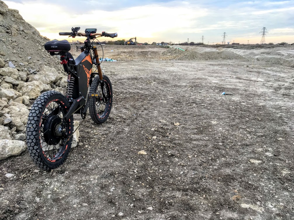

I don’t have just a really good spot to test top speed with getting on a highway and probably getting busted so this far my top speed is 46.3 MPH and before I ran out of room it still felt like it had another 10 miles an hour left to go before it hit max maybe even more. I can tell you that it gets really scary at that speed and you really start wondering about all the little nuts and bolts that might be coming lose or the tires exploding which they probably wont but I have come off a motorcycle at 55 on to hard pavement wearing nothing but shoes and shorts in my earlier years and I have no want to repeat that experience again so for now 46 is fast enough. This was on the 76r, the EEB tops out at about 40 before tripping the breaker on the battery pack but I can say there is a pretty big difference In the two at this speed. I don’t think I would want to go faster than 40 on those bike tires on the EEB. It feels unstable at that speed should a bump or pot hole pop up in the path.
Time to test the suspension
I have way to many projects going on so It took me forever to post these, so during the time from start, to here, I have put over 500 miles on the q76r and almost 300 on the EEB. I still have not built a battery for either one yet as planned instead a temporary solution sorta fell in place fell into place. One day I saw a flyer go buy for some big lipo packs a hobby king and it hit me. Why not use those? They had the 42.2 16amp packs on sell for 53.00 each so I bought 4 of them and wired them all in in series to get 65v 16amp battery pack.
Wow, what a difference that made. I can pull all the amps I want out of these without hesitation although at current I still do not have a easy way to charge them other than to pull the batteries and charge them the old way. So for the majority of the rides I have taken over the past several months I have been running the lipo packs in the q76r and the old 52v20a in the EEB still promising myself every day I am going to order the battery to build my own new packs for each.
I did manage to acquire the battery tab welder that runs off a car battery from one of the other members here though and I also bought a roll of nickel tape so really all I need is a few hundred 18650’s
That brings us to the end of the story for tonight. In my next post I will discuss the final costs, pro's and con's of each bike. As you can probably tell by the photo count posted. The 76r is my favorite and I get stopped by someone almost every time I ride it wanting to know where I got it but... There are some reasons or occasions I should say, why this might not be the best bike depending on what you want.
I had originally planed to build this new one (76r) and sell the other two now I want to keep all three of them. but either which way that comes out I still built all three of these for a little more than half the cost of a top of the line stealth which more than makes me happy.

And the final variable is weight. My GT frame weighs about 38lbs. My 76r frame weighs 107lbs.
My average Wh/mi on the GT is 15, My average Wh/mi on the 76r is 35

Is the 76r really 76mm width?
Yes is, which is good and bad. good for appearance and size between your legs and bad for trying to fit stuff in there. An 18650 with leads on both ends and some insulation and tape is just at 76mm so you must be very careful when building or buying a pack that does not go over those tolerances or your side covers will not go back on. Qulbix also make a 140 frame which is 140mm which is more or less what the EEB Enduro bike (also in the post) closer resembles. I have not had time to write more on my comparisons between the two but my next post was going to be on the frames and the size differences pros and cons and why I think the 76r is the better bike but it sure is a lot easier having that extra space in the EEB / Q140 to put all your stuff into.
Awesome information! Thank you for sharing this!
I’d love to know more about how you feel the two frames compare when you have a moment. :)
Sorry, I got really sick last year and didn't come here anymore.
The Qulbix 76r while expensive is the best bike by far. I don't even ride the other two anymore. They mostly just sit unless my friends want to go. The "bike frame" served its purpose back in the day and got me into e-bikes. It really just sit's in my office these days against the wall as a trophy.
The 76r with the moto tires just has the best weight and steering. I have no problem zooming all over on that one. The one I labeled EBB is a little squirrely in sharp corners. It has to do with the rake on the steering. It is more vertical than the 76r and I have dumped a few times because of that.
Sorry for the late response.
No worries. Thank you for the reply and hope all is well on the health front!
I ended up picking up a 76 frame, lightning rods motor, bac controller and some other parts then paused for a bit as I was spending too much. Lol Just put an order in for the battery though so things should start coming together soon! :D
