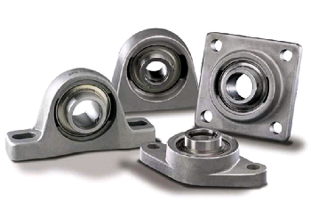

Any suggestions on the bearing support? Looks like my son is going to be riding it more than I thought. I'm finding it hard to not ride it either. There is a frame mount about 2 1/4" away I could use. You can see it in the pics.
I started another thread on the bearing subject, no response. I would guess that means it's unexplored at this time.
Outrigger bearing for an outrunner motor: I guess there's no mounting it on the housing. My own thought is that you're needing to mount it PERFECTLY in line with the shaft when the motor is mounted. Just some arm coming off that mount is probably plenty. Then again with the right bearing maybe you could use the same mount as your motor.

I totally agrre with Gwhy, the motors power pulling on the chain will break the motor mount!! just a simple plate with a hole bored in it to accept a bearing with an I/d to suit the motor shaft bolted to that lug in front of the motor would do the job perfectly, it is only to counter act the pull on the chain, that lug is positioned just right!
