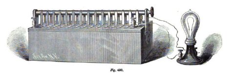

This might be the clearest explanation I've found so far for how the Faure cells were assembled. Published three years after 1881, and relating multi-plate battery construction, but the details about the order that the layers are laminated together is pretty clear:
From "Dynamo-Electricity: Its Generation, Application, Transmission, Storage and Measurement." by George B.Prescott, 1884
CHAPTER IX.
THE ELECTRICAL STORAGE OF POWER.
The storage of electricity by means of electric accumulators, which has recently played so important a part in the transmission of electric energy, is not an entirely new conception. The hydrogen gas battery suggested by Sir William Grove, in 1841, realized in the most perfect manner the conception of storage, although the power obtained from it was exceedingly slight. This battery was made as follows: Into the two outer necks of a three necked bottle two glass tubes were fitted, each of which was open below, and a platinum wire entered them hermetically above, to which a long strip of platinum was soldered, extending nearly to the bottom of the tube. Little cups, containing mercury, were attached to the upper end of these wires. The bottle was filled with slightly acidulated water, and the poles of a galvanic battery were placed in the little cups. Water was thereby decomposed; oxygen forming in one tube and hydrogen in the other. When the battery wires were removed, no change took place till metallic connection was established between the cups, when oxygen and hydrogen gradually disappeared, attended by an electric current, which passed from the oxygen to the hydrogen. When several of these were put together in a battery, the connection being always oxygen to hydrogen, they could decompose water. The most important fact illustrated by this battery was that the oxygen and hydrogen, liberated by galvanic agency, when left to themselves, produced a current the opposite to that which separated them. When the poles of the decomposing battery were in the mercury cups, hydrogen was given off at the —, and oxygen at the + pole; and as opposite electricities attract, it is manifest that the hydrogen in this action was +, and the oxygen —. When two gases formed by means of the platinum plates, a galvanic pair by themselves, the current proceeded from the + to the — within the liquid, and the reverse way between the poles, which was the opposite of the direction of the original current. It is manifest, therefore, that where oxygen or hydrogen is set free at any point in a galvanic circuit, they will tend to send a counter current This tendency is called galvanic polarization.
Sir William Siemens, in 1858, constructed a battery of considerable power by substituting porous carbon or platinum, impregnating the same with a precipitate of lead peroxidized by a charging current. At that time, however, little practical importance was attached to the subject, and even when Plante, in 1860, produced his secondary battery, composed of lead plates peroxidized by a charging current, little more than scientific curiosity was excited. It is only since the electro dynamic motor has become an accomplished fact that the importance of this mode of storing energy has become of practical importance, and great credit is due to Faure, Kabath, Volckman and others for putting this valuable addition to practical science into available form.
Fig. 488 shows a single pile of Faure battery operating a small electric motor. Fig. 489 shows the method of combining the plates. Fig. 490 shows a battery arranged with a commutator for combining the elements for tension or quantity. The plates are of pure lead foil, having a width of 7 inches, a height of 7 1/8 inches, with an ear projecting from the top 1 1/2 inches wide and 3 inches high. The total effective surface on both sides and edges of each plate is 100 square inches. These secondary elements were constructed as follows:
After cutting out a sufficient number of lead plates, pieces of Canton flannel, 15 inches long and 7 1/2 inches wide, were cut, together with as many sheets of blotting paper, 7 1/2 inches square, as there were lead plates. A thick paint of red lead was then prepared by mixing the dry pigment with water containing one tenth of sulphuric acid. This paint had a consistency of paste, and was applied thickly to one side of the sheet of lead. The Canton flannel having been painted to within one quarter inch of its edges on the nap side, the lead was laid, painted side down, upon the painted Canton flannel, when the other side of the lead was painted and the cloth was folded over the lead,completely enveloping it, with the exception of the ear at the top, and projecting about one quarter inch beyond the edges of the lead. The lead with its envelope was then laid upon a level board, and another plate was prepared in the same manner and placed over the first, with an intervening layer of blotting paper, and with the ear placed opposite the ear of the first. Other lead plates were added in the same way, with the interposed sheet of blotting paper and with the ears alternating in position, as indicated in fig. 489. When ten plates had been placed together in this manner they were clamped together, and the ears were passed through a slit in the wooden cover of the containing cell and bent down upon the top of the cover, as shown in fig. 488. They were then pierced and traversed by the screw of a binding post which enters the wood. In this way each pole of the element was furnished with a binding post, and at the same time firmly secured to the cover. The cell was then filled with acidulated water — water 10 parts, sulphuric acid 1 part — and after the cloth and blotting paper had become saturated the element was connected with a dynamo electric machine. One element of ten plates, after receiving the current from the dynamo for ten minutes, operated the small motor, shown in fig. 488, three hours, and another ten minutes' application of the current from the dynamo charged it so that after eighteen hours of rest it yielded a current which was apparently as strong as when it was first charged on the previous day; but a time test proved that it was incapable of running the motor for quite so long a time as when the current is used soon after storing.
"Canton" flannel refers to Canton, China and just means cotton flannel cloth, "fluffy" one side. Other descriptions have said felt... Thinking flannel is the more accurate description, as the nape helped hold the red lead paste to the cloth.
Nice to see a series/parallel switch illustrated again

Electromotive force E ............ 1.9 volt.
Internal resistance r ............ .08 ohm.
Intensity at moment of insertion 118 amperes.
On joining up a battery of six cells of this description with a one-bobbin Trouve motor, M.d'Arsonval gives the following as the result:—
Work in the brake..... 3.75 kilogrammetres per second.
Current................ 20 amperes.
Zinc expended per hour 144 grammes.
Whence it appears that each gramme of zinc gives by this means 94 kilogrammetres of force. If we add to this 20 per cent. for the work absorbed in the double transmission by gearing and endless chain (the brake not being able to be applied direct on the axis of the motor), we have an effective work of 112 kilogrammetres per gramme of zinc consumed; and it is said that, with motors having several bobbins, this return has been exceeded.
It is also said that this battery, when used in conjunction with a Gramme machine, has been made to furnish for three consecutive hours a force of 14 kilogrammetres per second, and the following is a table of experiments undertaken by M.Trouve :—
Dunno exactly when Gustave published these numbers but this is the first reference I've seen to his using up to eight bobbins in one of his motors...
Staying with his 2 bobbin configuration at 5kg in weight (seems to be the motor most often referenced by Gustave et al) here he ran the motor on 12 bichromate cells - in series I assume - so 22.8V, producing 28,800 kilogram-metres per hour... watt works out to only 78.45W...
This confirms watt LFP calculated earlier from the 7kgm per second Gustave reported to the Academy... except in that report he said he was using only six Plante cells, AFAIK about 12V.
Anyway... having a hard time sourcing pure lead tetroxide... turns out the minium sold these daze as artists pigment is only about 70% Pb3O4 plus impurities, other oxides of lead mostly. But maybe the stuff Gustave etc were rolling up in 1881 wasn't 100% either... dunno.
