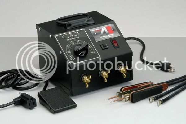

I forgot to ask to see photos of your BMS wiring.
I am buying this resistance soldering iron for assembling the battery pack.
https://www.americanbeautytools.com/site/models/rs
Hi,
please have a look to my thread:
http://endless-sphere.com/forums/viewtopic.php?f=14&t=54877#p817891
This batterys are good for high current discharge! A inexpensiv resistance soldering is only for medium or low current discharge.
How much is your estimate dischage current?
BR
ecross
