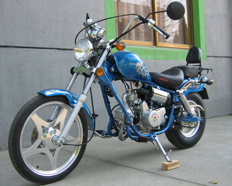

Super newb here! Would this motor have the power/torque for a "lightweight" motorbike, say 125-150lbs?
Thanks!
First, before you get an answer from anyone, there's only one way to be sure. We're not aware of any build that big with the Revolt motors.
Let's say you could acquire an old Pagsta Mini-Harlee. Mine cost me $300 and it was near new condition. So you have this beautiful street legal 50cc bike that weighs something like 170 pounds. With that engine gone, you only need to go easy on the battery weight to stay around 150-170 pounds.
So you have to actually measure the diameter of the rear tire. If it proves to be near 20", you'll say that maybe 180rpm is 10mph. At 60mph that rear wheel spins 1,080rpm. I might think you'd set this up to this up to run the motor at 3,600rpm at that speed, so you need 3 teeth on the motor for every 10 at the wheel.
But is that motor hardy enough to work out? That 20kw is a peak, but I don' t think you'll need that to cruise around at 60mph on this thing. Can it really survive the acceleration again and again? SOMEONE has to do it first so we'll know.
DO report back to us. We're dying to hear.
Oh, Pagsta made their own version with a hub motor.
