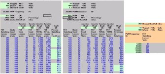

I would not move the pwm just based on sound.... This chart shows losses go up by a ratio the same as the PWM frequency eg. 40000 hz will have double the switching losses compared to 20000 hz.Kingfish said:Hey Ricky
I’ve been a happy fly-on-the-wall admiring your progress with enthusiasm (subscribed from the beginning)! When you suggest moving the frequency to 40KHz, target 44KHz instead; that’s twice above (perfect) human level and coincidentally the rate at which early CD-sampling used. It seems to me that frequency generators of that range would be very common. Just my ½ watt. I’ll go away now and back to observing from the wall.
Great work! KF 8)
I can pretty much choose any frequency I want. because I have 120MHz divided in in a 32 bit counter to generate the PWM signals so it will be limited byt other apects of the design. It all starts from a 12MHz crystal. These modern micros make it so easy with internal PLLsKingfish said:I’ve been a happy fly-on-the-wall admiring your progress with enthusiasm (subscribed from the beginning)! When you suggest moving the frequency to 40KHz, target 44KHz instead; that’s twice above (perfect) human level and coincidentally the rate at which early CD-sampling used. It seems to me that frequency generators of that range would be very common. Just my ½ watt. I’ll go away now and back to observing from the wall.
This is what makes some of this power electronics design tricky is all the design trade offs and the fact that the component manufacturers can't produce 'ideal' components :lol:Alan B said:Dynamic FET losses will roughly double, but the effective inductive reactance will also double and the capacitance ripple current will go down by half so if you have good FETs and drivers it is not clear what the best frequency is without deeper analysis.
