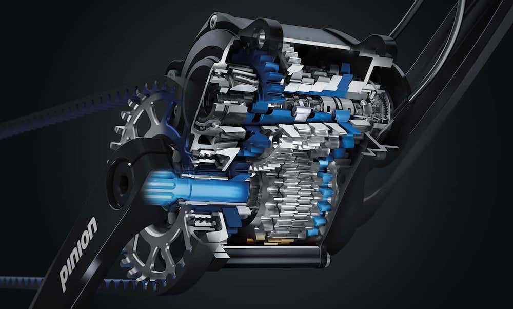

Thing is, except for the extra weight...I'm thinking there is some huge drivetrain loss with the mid-drive if using it without electric power???
To make things worse, I'm running a Nuvinci 360 rear hub which is also not as efficient as a standard cogged derailer setup. But not sure how much of a difference this really makes?
Where my long story goes to is, are the newer high-end mountain bikes with the build-in (say bosch) mid-drive...do they have considerably less drivetrain loss than mine old school BBS02? Like if I were to get one of those, without the power on I'd at least be as efficient minus the extra weight? Or does having a mid-drive mean that drivetrain loss is just going to be par for the course???

All mid drives have a certain amount of parasitic drag due to the necessary gear reduction to them even the say the Bosch types. But you are also dealing with the extra weight of the motor, even sans battery, and that Nuvinci isn't that efficient either. Just use you lowest assist level and he can draft you and you both will have fun.

A NuVinci hub has a pretty big efficiency hit vs a plain direct chain drive, at least several times the power loss, IIRC. So depending on what drivetrain your brother's bike has, the difference could be easily noticeable.
Plain direct chain drive is about 2%, IIRC; I don't recall for sure the NV results I'd seen around here, but a quick google gives results as bad as 1/5 of the total power lost into the hub; this page
shows some testing, and summarizes them giving the NV 85% efficiency, 15% loss. It also gives a derailer-shifted drive up to 10% loss. Both results depend on the actual ratios used, and the NV will depend on the torque input to it (more torque in means more loss because of the way it works internally, as there is more slippage in the fluid).
