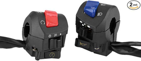

YOu can use motorcycle, scooter, or ATV handlebar controls, or DIY something from a regular switch. I have this one to use on my new trike; I haven't checked out it's wiring to see what connects where yet. If you use this one, you only need one of the two control units; they both have a center-off two position switch so you can use either one for turn signals, and you can use the big top switch on eitehr one to turn the lights on / off entirely if you like. Other switches can be left alone o rused for other things if you like. There are hundreds of other choices if you don't like that one. Actaul wiring could vary from unit to unit so if you can, get one that comes with a wiring diagram (I don't think this one did, but dont' remember).

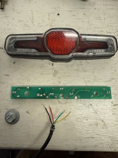

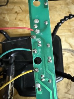

I put a single motor version of that bike together for a friend. Weeks later, the bike fell and the tail light broke. I opened it up and all. The turn signals are not wired up. I’m pretty sure your light will be similar, if not the same. You’d have to open the light and solder to the board. The board is labeled pretty good.
