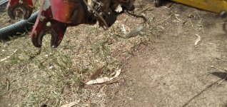

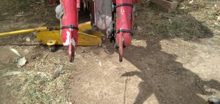

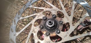

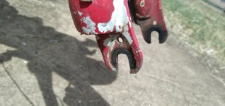

I have had this front QR come loose a number of times now over the years. I've done all the usual re-adjustments, lubrications, and checks and it hasn't made any difference. I've put the lever in all sorts of "clock positions", pointing up, down, forward, back, angled, over the fork, over the air, etc. These days i leave it in some upward postion so it's really easy to see when it's not secure, because it wont' be up, it'll be down.
I changed to the present QR skewer a while back after the first few times it happened (the previous problematic one was one of those newer aluminum CNC-looking types). This one is oldschool steel; I think it came off a 1990s Nishiki but I don't remember for sure.
Doesn't matter which side the lever is on, vs the nut, either
When it happens, it's pretty sudden. I'tll be perfectly fine for months, then I'll get home, park it, and when I go to ride the next morning, the lever will be flopped loose. It doesn't come loose during a ride, and it doesn't come loose while parked at work or the grocery store, etc. Only sitting overnight (or longer) at home, parked in the shed.
I'd suspect tampering if it weren't so unlikely (nigh impossible) that someone could or would silently come into my yard despite my giant monster (st bernard) Jellybeantheperfectlynormalschmoo (and also back when I still had Kirin and Yogi), drag open the noisy hard to open bent-up shed doors, get around the trike to get to the front of it, frock with the skewer lever, then get back around the trike and out the shed doors, close them exactly the same way I left them (which is really hard to do the same way each time because of how hard they are to slide because of being bent up), get past the dogs again and out of the yard without making them all bark and chase and bark)....

Since something is causing the skewer to loosen (tension decreasing on the skewer; whcih probably doesn't have anything directly to do with the lever itself) all that will do is keep the lever in place so I can't see that it has loosened. ;)
That's why I leave the lever in the up position so it's obvious in a preflight glance at things taht it's wrong.
I'd still feel it when I started riding, but since at that point I'm moving and if something went wrong to allow the wheel to come out of the fork because of the loose skewer, I'd then have the fork plowing into the road and destroying the trike and possibly killing me depending on exactly what happens, I'd rather just not do that.
The lever itself won't just come loose and flop unless the tension on the skewer has decreased, and securing the lever even with a hose clamp won't stop whatever is causing the tension to decrease.
If it was just that the lever was being pulled out then the band or a clamp would certainly work, but that can't be what is happening, unless someone is coming into my yard past the dogs and opening hte noisy shed doors without anyone hearing it and the dogs not hearing it and not barking furiously and chasing them (and probably causing them to yell and run away...wouldn't *you* run from a 150lb+ dog running toward you, the intruder in their yard? ;) ), then they get past the trike inside the shed to it's front end in the dark (no lights in there unless I connect them at the house first) then loosen the lever then out the doors, close teh noisy doors back to exactly the way I left them, get past the dogs and out of the yard.... No, it's not being pulled open by someone messing with it.... (I mean, I could put a camera out there to be sure, but really, I think by this time I'd've noticed something at the time it was happening :lol: ).
I still don't know what causes the decrease in tension to the point that the lever suddenly releases while just sitting there after a ride, when I don't have any wiggle or other issues during any ride leading up to it. :( And always only at home, not at the other end of my commute sitting there at work.

Have you taken the skewer off and inspected every component under a microscope? Do you have a new skewer to replace it with?
It sounds unreal. Do set up a camera. Maybe you'll find that you were sleep walking and you are the one who flipped the lever? ;)
Lubricating the QR cam gives a better ratio of tightening force to clamping force. If you're not using an all steel closed cam skewer, get one. Open cam and aluminum skewers don't do good work.
Also, inspect the threads on your problem QR skewer to see if the pitch length inboard of the QR nut is the same as that outboard of the nut. If the clamped section has elongated, you have a soft skewer and you should ditch it fast.

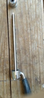

Yes, it's a steel closed-cam type; oldschool (from the old 90s nishiki MTB IIRC), steel nut on the other end, steel skewer rod too. I'll have to check the threads.
I already did replace the skewer (from the aluminum open-cam type to this one), but the problem persists. While it could still be the skewer, it's possible that it is something else, and that's why I'm inviting ideas. :)
The thing that is so wierd is when it happens...I would expect it to come loose *while riding*, and specificaly when the most sideloading occurs, but it never happens then, just when sitting there parked.
The previous problem I had with it coming loose *did* happen then, (or any other time it was loaded up enough), because the end-nut or the cam-unit face would catch on the lawyer lip and so it wasn't really seated fully or correctly, so when it was loaded enough to pull it off the lip it would detension the skewer and the lever would flop open; that kind of failure I totally understand and was easily able to fix once I figured it out.
The current problem doens't even make sense to *my* screwed up brain, so....

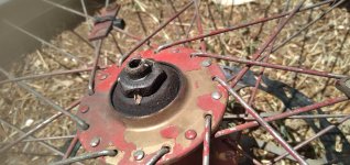

The other thing I can think of is the axle locknuts getting smooshed (if aluminum) or the dropout faces becoming indented.
Could it be that it's a two step process? It gets part way loosened while riding, then the temperature differentials during storage loosen it further until the lever opens?

Yeah, generally speaking there's one reason why a skewer would open - lost tension.
And since it's an opposed system, it can be broken down into either (or both!):
* skewer elongating
* the hub (well everything it clamps on) shortening
- both of the above of course meant relative to each other, not absolutely.

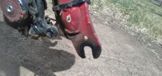

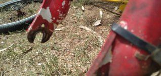

If a new skewer didn't fix it, if the dropouts and the fork material seem fine, the only logical conclusion is that the hub's locknut edge to locknut edge is shrinking.
"....over the years?"

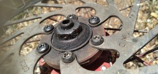

Do you have a dial or digital measuring caliper handy? I'd urge you to pull the front wheel and measure across the jam-nuts of the axle - Disassemble the hub and closely inspect the hub, bearings, and the axle.
I didn't see the last two replies till just now, but replies are below, and at the end are pics of the skewer, nuts, dropouts, and hub that I took earlier today while fixing the broken ground wire for the front headlight and turn signals. I got distracted by Jellybeantheperfectlynormalschmoo squeaking her pickle for playtime, so I forgot to disassemble the hub itself to get pics of bearings, cups, and cone-nuts' internal faces. Have to go back out later and do that, and the measurement in the last reply above.

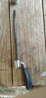

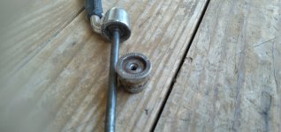

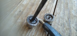

In the pics you can see the skewer itself is slightly bent at the threaded end. The nut still threads on normally all the way from the outer end down to the end of the threaded area, isn't loose but it rolls on easily for teh whole length.
It's possible the bend itself could cause the issue, but I would expect it to be like a spoke--wehn tensioned, it wouldn't matter...but it would take a lot of tension to straighten something this thick, so...dunno. Still gonna check everything else too.
I don't know what caused the bend; it shouldn't be possible for wheel loading to do that since the axle takes that along the dropouts. Maybe it's always been bent and I just never noticed before.
Axle hardware is all steel too (hub itself is aluminum though). Dropouts are steel, though cheap (crappy suspension fork lowers) There are indents from the ridges in the hub locknuts, but they "look" the same as the last time I took it off some time back to change the tire. I didn't take pics then so nothing to compare to except my unwarrantied memories. ;)
Hope by now you've added front skewer inspection to your "Pre-Flight Checklist!"
I've had it on the PFC for a long time (noted somewhere above on this page).
I'm sure it is a multipart process, but the problem is figuring out what exactly that process is, because none of the steps that I would expect to cause it appear to be happening (it isn't ever loose after the ride, if I touch it I can feel it's still locked).
* skewer elongating
That's something that happened with a different hub, and is why I changed to this hub--the bearing cups in the hub failed (but that one didn't have a skewer issue, it was just the sudden cup failure).
I have to check the hub itself, opening it up and verifying cups, cones, bearings, etc. It doesn't have any issue rolling or spinning freely offground, unlike the one whose cups failed. A while back (year? two? don't recall) I had opened it up and checked, cleaned, and regreased this hub; I probably have a post in this thread with pics of that but haven't looked.
@amberwolf , How about swapping the hollow QR axle for a solid one? I've got some solid front axles that I can send you.
Will they fit? I didn't want to use QR on a previous hub on this trike, but was stuck with it because none of the regular front bike wheel axles I had from any wheel (some quite ancient, all the way up to stuff that might even be from this century :lol: ) would work; I don't remember why they didn't fit it but they didn't.
I don't remember trying to do it on this hub (probably because I assumed that if they didn't fit the other one they wouldn't fit this one either), but if they do, I can try the ones I have first.
Do you have a dial or digital measuring caliper handy? I'd urge you to pull the front wheel and measure across the jam-nuts of the axle - If less than 100mm, disassemble the hub and closely inspect the hub, bearings, and the axle.
Don't know why that didn't occur to me to check :oops: but I'll try that later today when I go out to open up the hub to check the cones/cups/bearings.
If all else fails I can switch the whole front wheel out to one of the Jump bike bafang hubmotor wheels that have disc rotor mounts, even though I wouldn't be using it as a motor, until I can build another disc-capable wheel.
Would need to use that existing JB wheel for a while as I might have to make the hub as I don't think I have any more disc-capable ones except an identical one to the present QR one that I'd have to unlace from an old 24" wheel, and I'd have to make it to fit the spokes needed for whatever rim I end up using off another wheel (no budget for new spokes / hubs / etc).

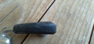

EDIT: pics didn't upload, had to retry:
Measure first... before you disassemble. If you can't get your caliper to fit between the spokes, just grab a known good fork and confirm 100mm between the inside of the dropouts. Then drop your wheel in and see if there's any side-to--side slack.
Is this QR skewer bent a bit (meaning it doesn't have consistent clamping force)?
Edit: I'd check for why it's bent, rather than believing this loosening is caused by the bent. Maybe fork legs are "wandering" around?
