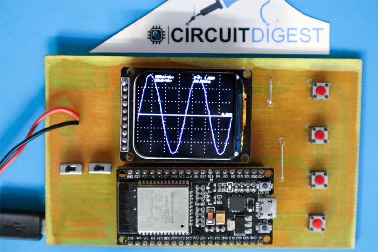

The present example is fairly unrelated to this thread's project, but have a cheap ($3) NodeMCU with a tiny OLED built in
and before I tried making it detect and display the angles from one of these MPU sensors (to see if I could learn to code something for that from scratch instead of just copying an example code set), I thought I'd try to get one of the various very simple (haha) ESP32 Oscilloscope projects (the first one of those listed below; there's several others out there too) adapted to it just to see if they would run on it at all, and show me something interesting on the display...and it might actually be useful, too.
But...the project requires several "includes" such as adc.h, which in turn has it's own includes like gpio.h... etc.
I managed to force the system to find the adc.h (which no version of is anywhere on my computer) by locating a version of it in an ESP32 library here
and just putting the file inside my "libraries" folder in a subfolder "ADC", and then using the ENTIRE LOCAL PATH to that file, since no shorter version would work, and the Arduino IDE is too stupid to bother checking for files anywhere you don't specifically completely locate for it.
But the technique didn't work for the sub-includes, even if I edit the adc.h file for the paths to them, even if I stick them in the same ADC folder and edit the adc.h file itself to point to those exact full paths.
I opened the adc.h file in the IDE and tried compiling just that, but even with those edits it won't compile, sticking on being unable to find gpio.h, even though I stuck that in there the same way I did the adc.h, and put the path in, etc. I wasted about four hours on internet searches and attempts to either use the fixes I found, adapt them to my system, or just try logical derivatives of them or of the things I'd done for the adc.h that worked. No luck.
Aside from my lack of ability to really grasp what functions can be done by what kinds of software commands (meaning, while I understand the idea behind them, I don't know all of the commands and how to build things with them...no, that's not really what I mean; I don't even know how to say what I mean). I don't know how to even conceptualize how to turn an idea I have about what needs to be done into actual code (not knowing what code does what, and finding that I don't understand what other people mean when they discuss what can be done to do these things), stuff like the above is what keeps me from doing anything about the software for this project, and sends me on some pretty deep depressions about it that keep me from coming back to it to even try things very often. :(
